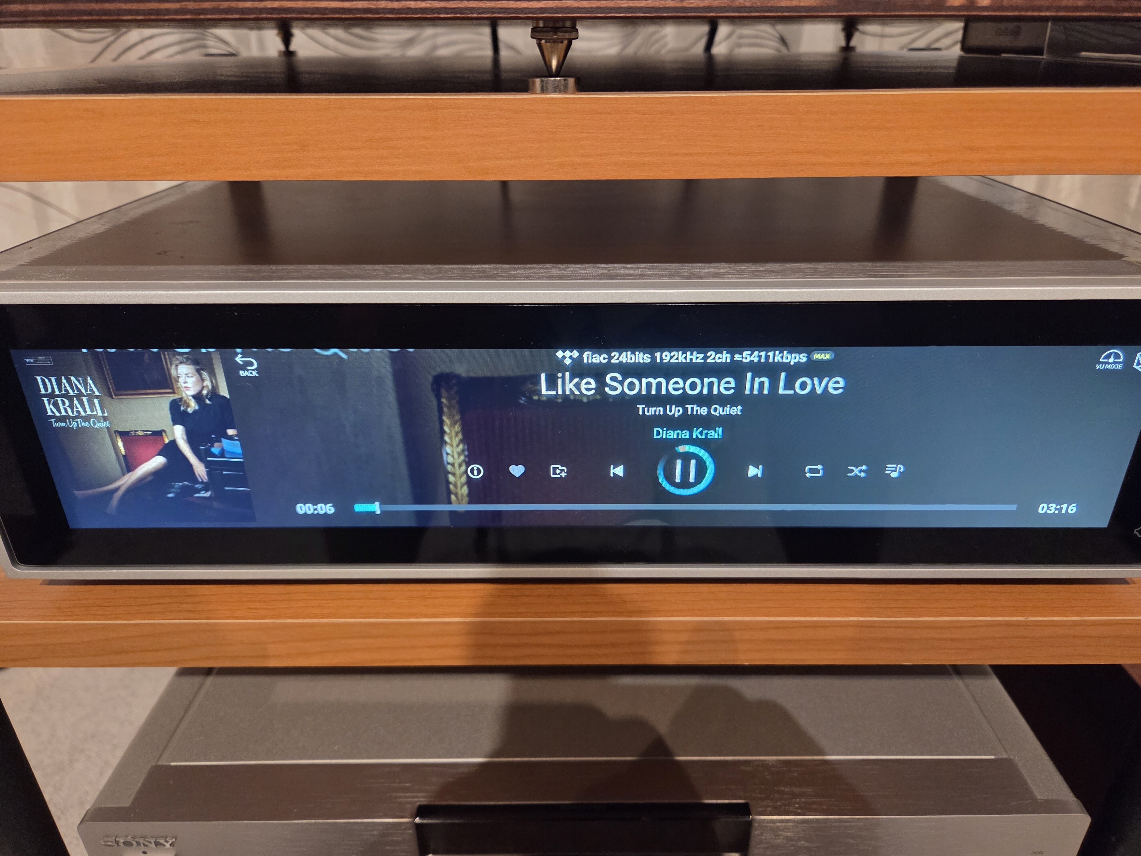

The Streamer is 2 months old and from the very beginning had problems with the cable connection to the internet, it connects but does not play any song or video, you have to remove the cable several times until it finally manages to play something, then it works relatively ok until I remove the cable again and everything starts all over again.
Files up to 3000 kbps it plays ok, what is over that stops loading every 10 seconds or so, I tried everything I could but I think the device has a problem with the network card. Can you please tell me who is in charge of repairs in Germany? Thank you very mutch
