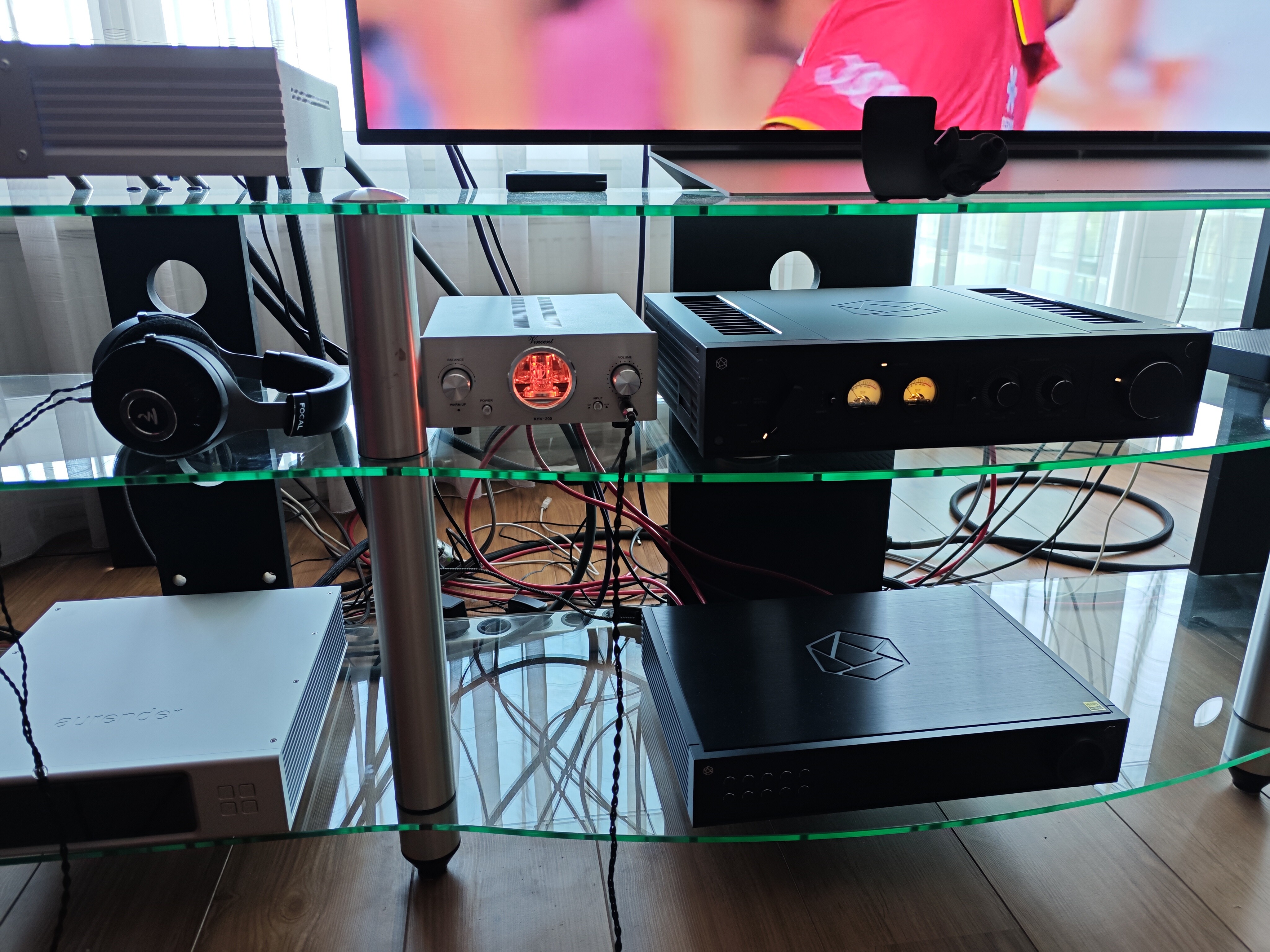

Tomorrow I’ll connect the C47 to the RD160 to see how the headphone output performs. It’s no match for the McIntosh DAC (ten years old), then the Vincent head amp.is significantly better.
yes, 160 —> C47 —> headphones vs 160 —> Vincent —> headphones
I’ve tried a few things, but the C47 as a headphone amp only isn’t really an option. However, I still have a Focal Elear, and it sounds great with the RD160 and Vincent KHV200 without any tone controls. I think I’ll sell the HD800S and use only the Focal.I just need to buy some longer RCA cables so I can give the Vincent a better spot :slightly_smiling_face:I’m still very happy with the HIFI Rose gear, it sounds amazing :+1:
