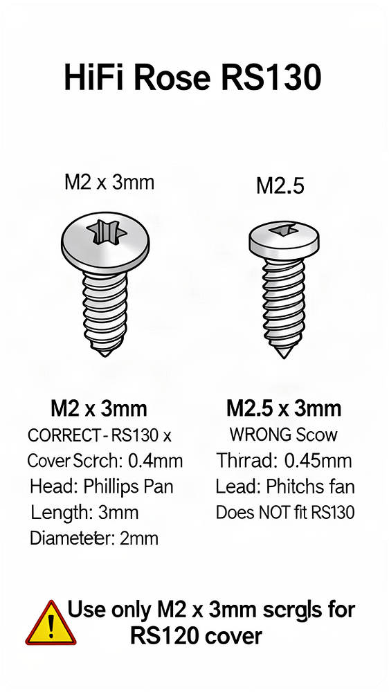

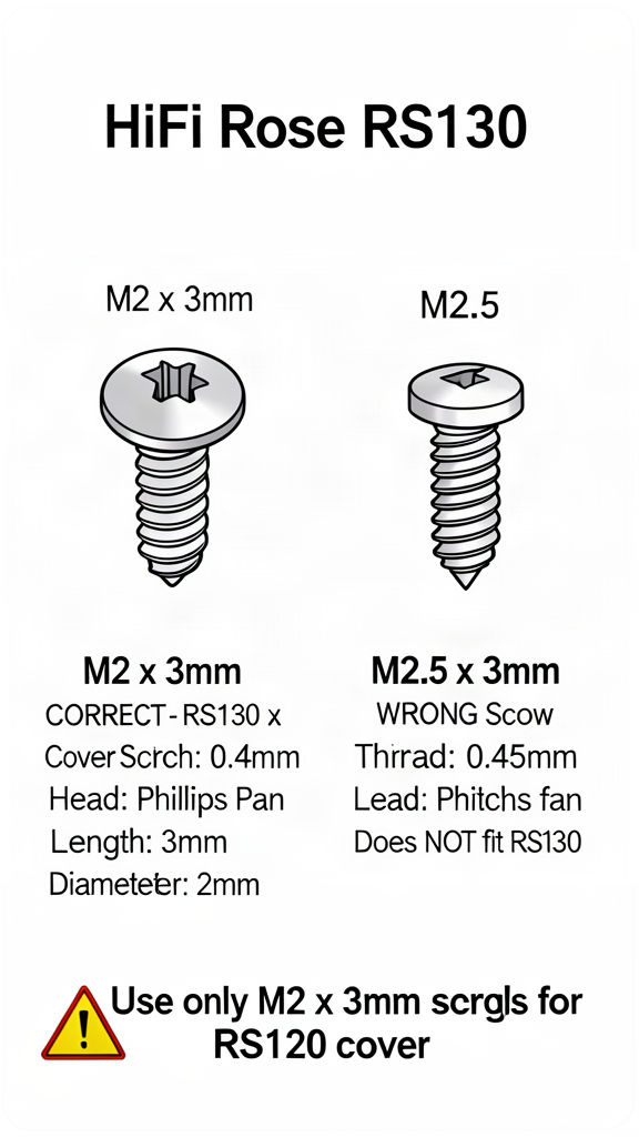

I have an RS 130. The back has the internal SSD cover.
The cover is held down by two small screws.
One of the screws has stripped.
What size are they?
The manual shows them but doesn’t say what size they are.

Hi, user manual is not the place for listing screws, usually that’s reserved for service manuals.
Anyway my guess would be that it is the same screw as used for SATA2.5 SSDs mounting bays, eg M3. Short ones, idk 3-4-5 mm
Serge,
Thanks for your input. I did some sleuthing and measuring and it appears to be M2X3mm

The screw specification is:
TAPTITE +2S BH 3×10 BK
Screw head type: Phillips (+)
