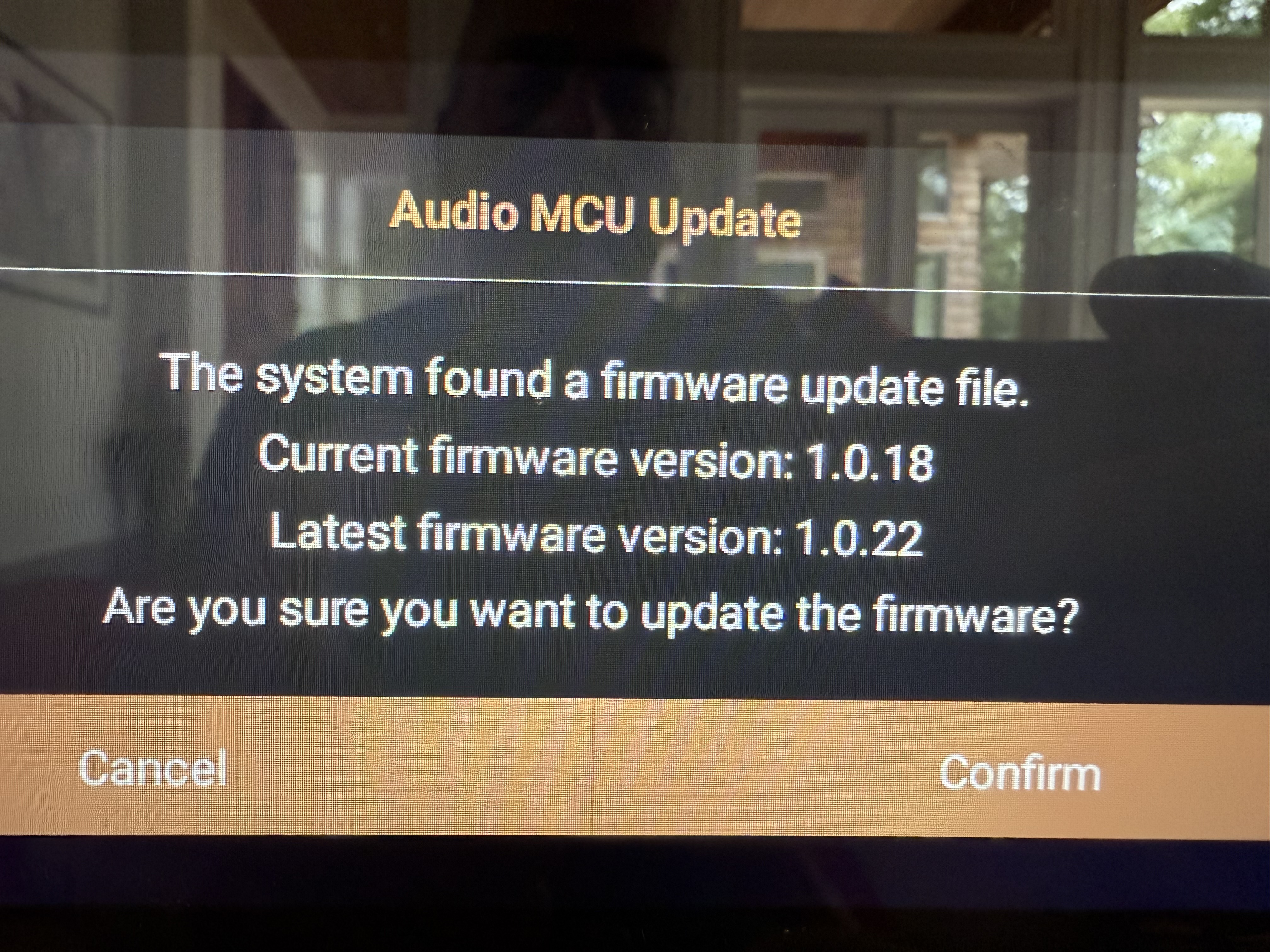

Audio MCU failed update
RS151; updated to 5.9. And I am getting g recurrent screen to update audio MCU I select confirm but it never happens - please help

How did you solve this?
Today I bought a rs151 and shows the same issue (and also a lot of transformer hum…). Not the best start.
I did factory reset then when update icon showed I did not update and selected “do not show”. They have since rolled out another update that seems to be working. My advice would to be to always wait a few weeks to update their glitchy roll outs
We have confirmed that this issue appears in early-production units of the RS151.
To resolve the problem, we need to physically receive a sample unit that exhibits the issue.
Unfortunately, it cannot be diagnosed or corrected remotely.
For now, when the message appears, we recommend closing the popup and continuing to use the device.
If customers in Korea report this issue, we plan to temporarily collect their units to analyze and reproduce the problem.
Did this ever get fixed? I’m a retailer in Florida and having this issue with both my store demo unit and my personal unit at home, factory resetting does nothing as it keeps popping up. Please let me know!
Yes my update worked after doing a factory reset
@Gabemtz
If the MCU update does not proceed even after performing a factory reset, please contact MoFi, the official distributor in your country (United States), and request a board replacement.
This should resolve the issue.
