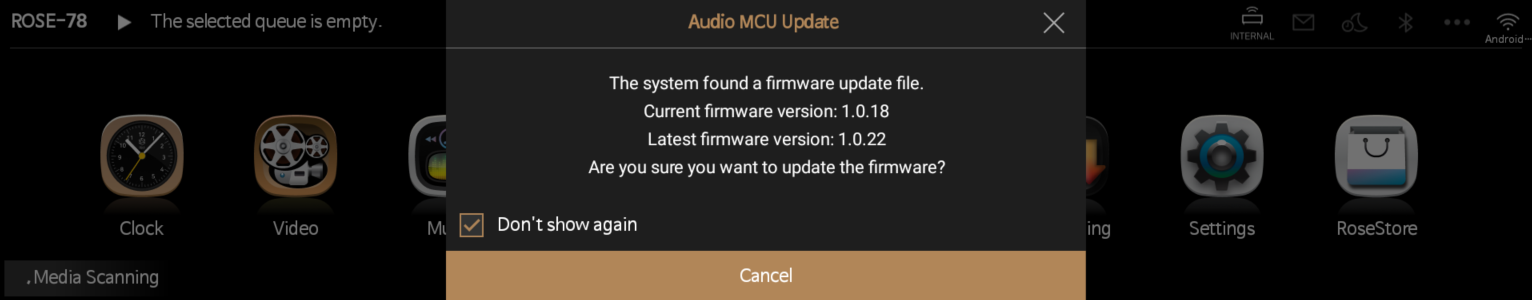

Since 2 months I have a Hifi Rose RS151 and after updating the latest software version (5.0 / 5.9.05 / 5.9.02.1), another firmware notification keeps popping up (when turning the device on), namely “Audio MCU Update”.
It says:“The system has found a firmware update file. Current firmware version: 1.0.18 / most recent firmware version: 1.0.22 / Are you sure you want to update”.
After selecting “confirm” the device starts doing stuff (device turns off and on again and trying to scan “media files” which I don’t think I have), and after a minute or so, the same pop-up is shown again, even after trying this two or three times. Also when selecting “ignore” instead of “confirm”, the same update notification shows up, when turning the device back on …
I discovered you can select “do not show this message again” (which I did in the end), but this does not seem normal to me, I always prefer a “latest software version” even though I don’t know what it’s for …
Does this look familiar to anyone of you and how can I resolve this.
