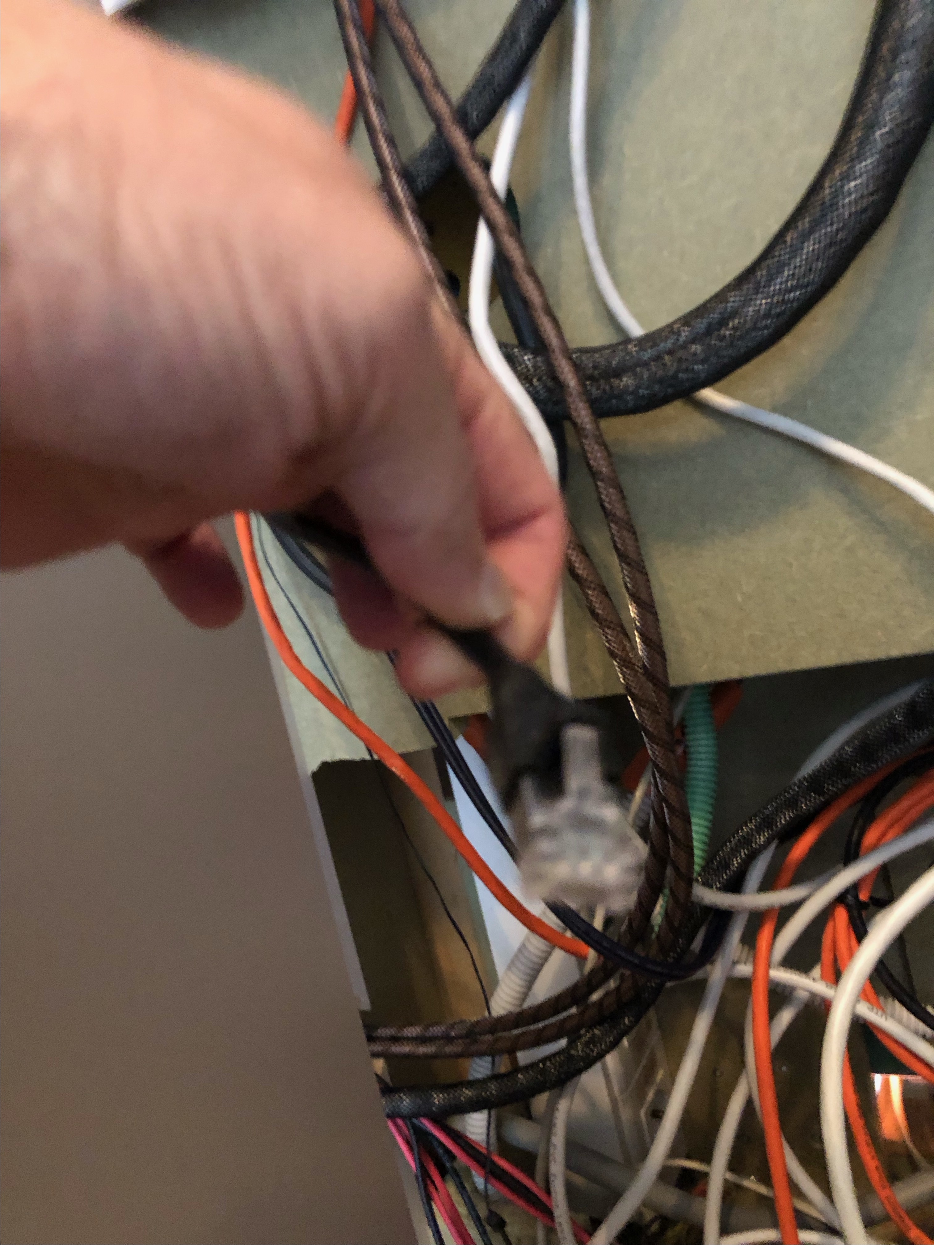

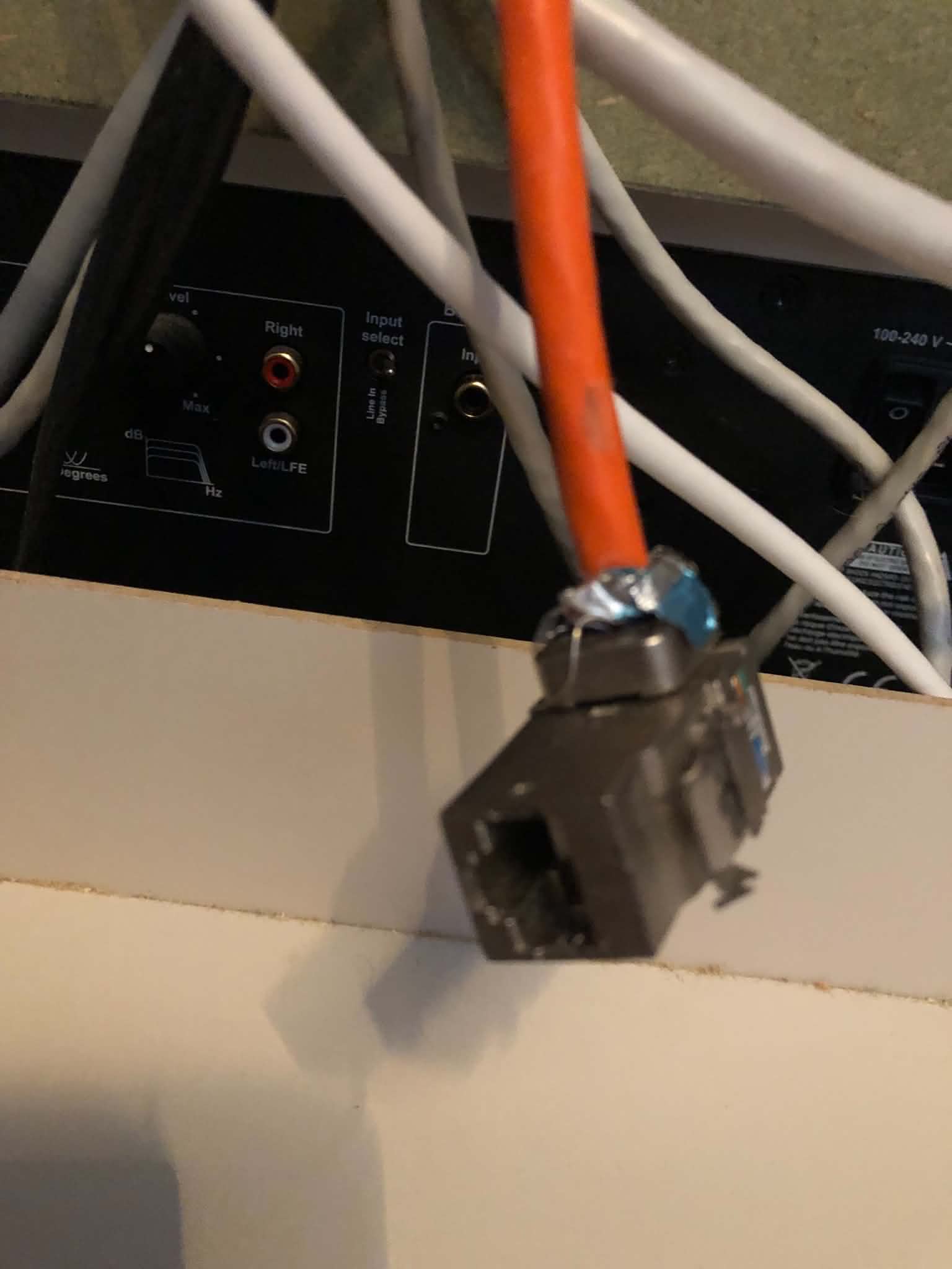

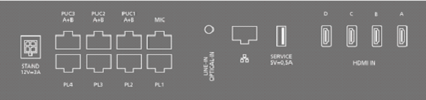

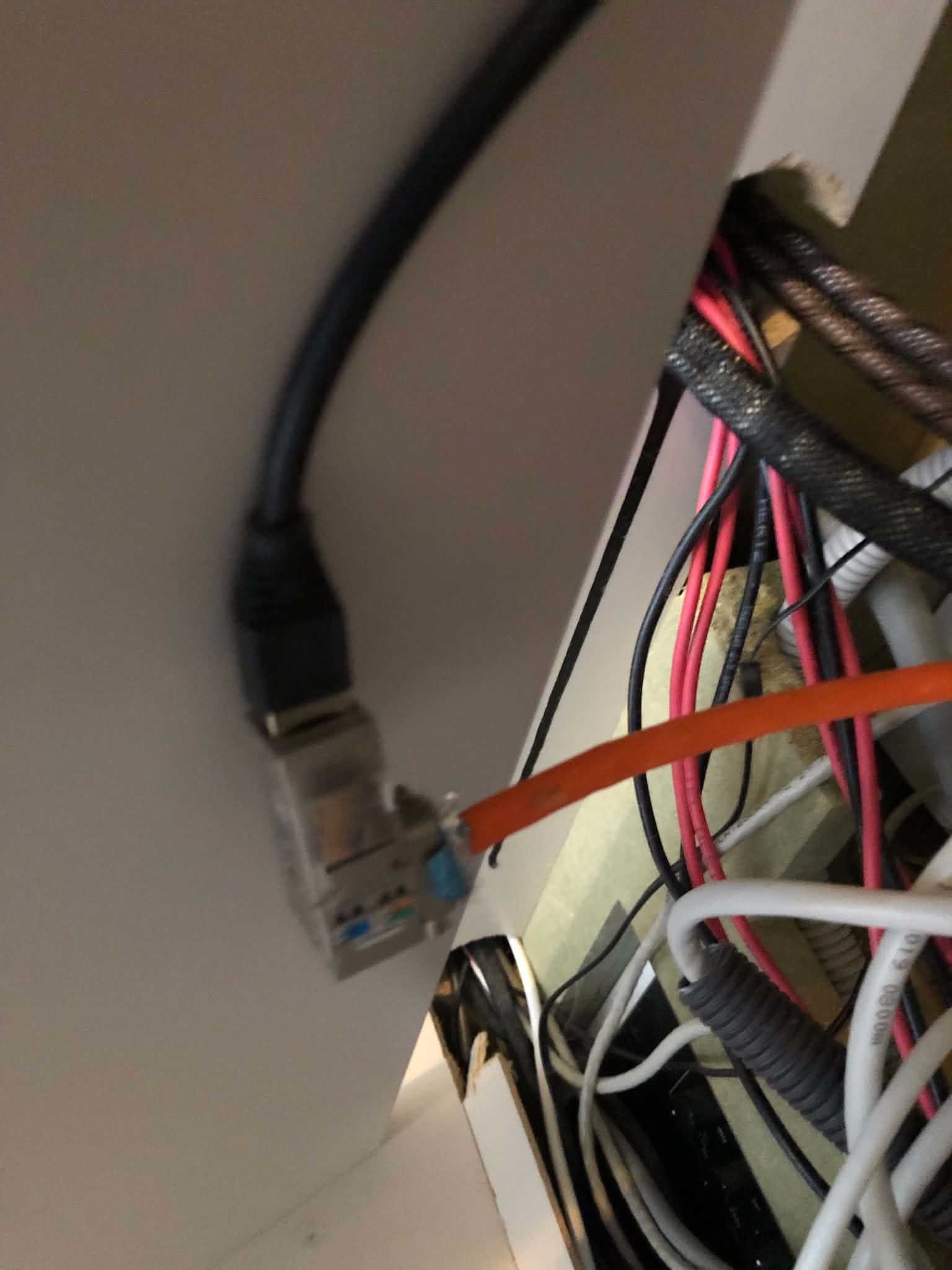

mceclip1 De input heb ik foto doorgestuurd
Van de b&o beovisieon is het een powerlink kabel oranje pl1

Thank you for providing the detailed information and photos.
Based on the information you provided, we understand that you are connecting the Power Link output of your B&O Beovision Harmony to the Line Input of the RS151.
To help us determine the cause of the issue, could you please perform one additional test?
Please connect a different source device with a standard line-level output, such as a CD player, DAC, or smartphone, to the same Line Input on the RS151 instead of the B&O Beovision Harmony.
Please check whether the same symptoms occur with the other source device, particularly whether the input volume is extremely low or the humming/buzzing noise is still present.
If the same issue occurs with another source device, we will further investigate the Line Input of the RS151. If the other source works normally, the issue may be related to the output characteristics or level of the B&O Power Link connection when used with the RS151 Line Input.
