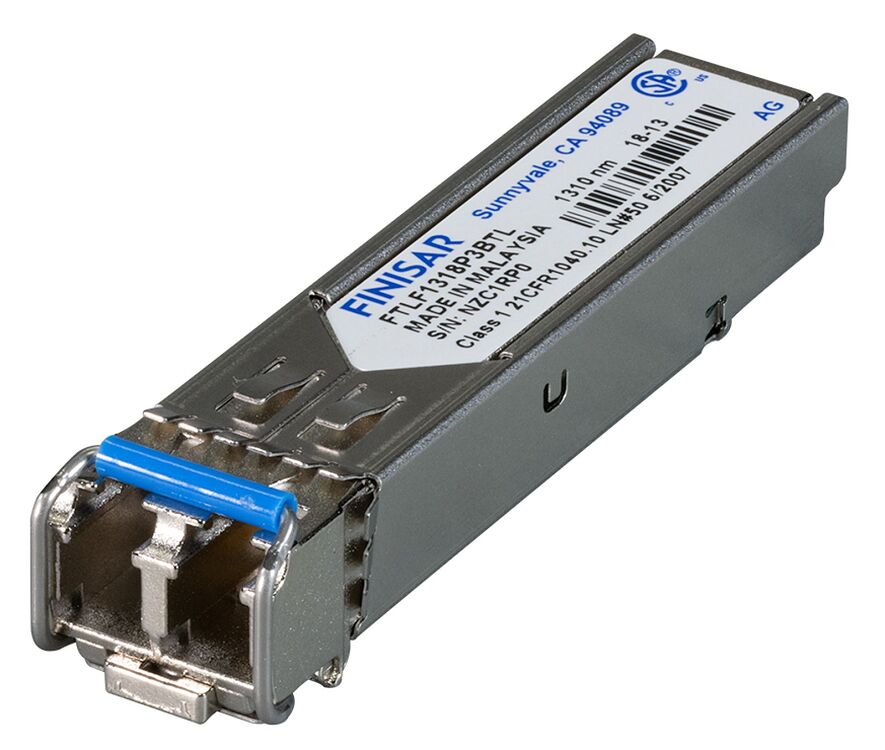

I think there’s a mistake somewhere. The Finisar FTLX1475D3BTL is a single mode module and requires single mode fiber for connection.
It doesn’t work with multimode fiber.

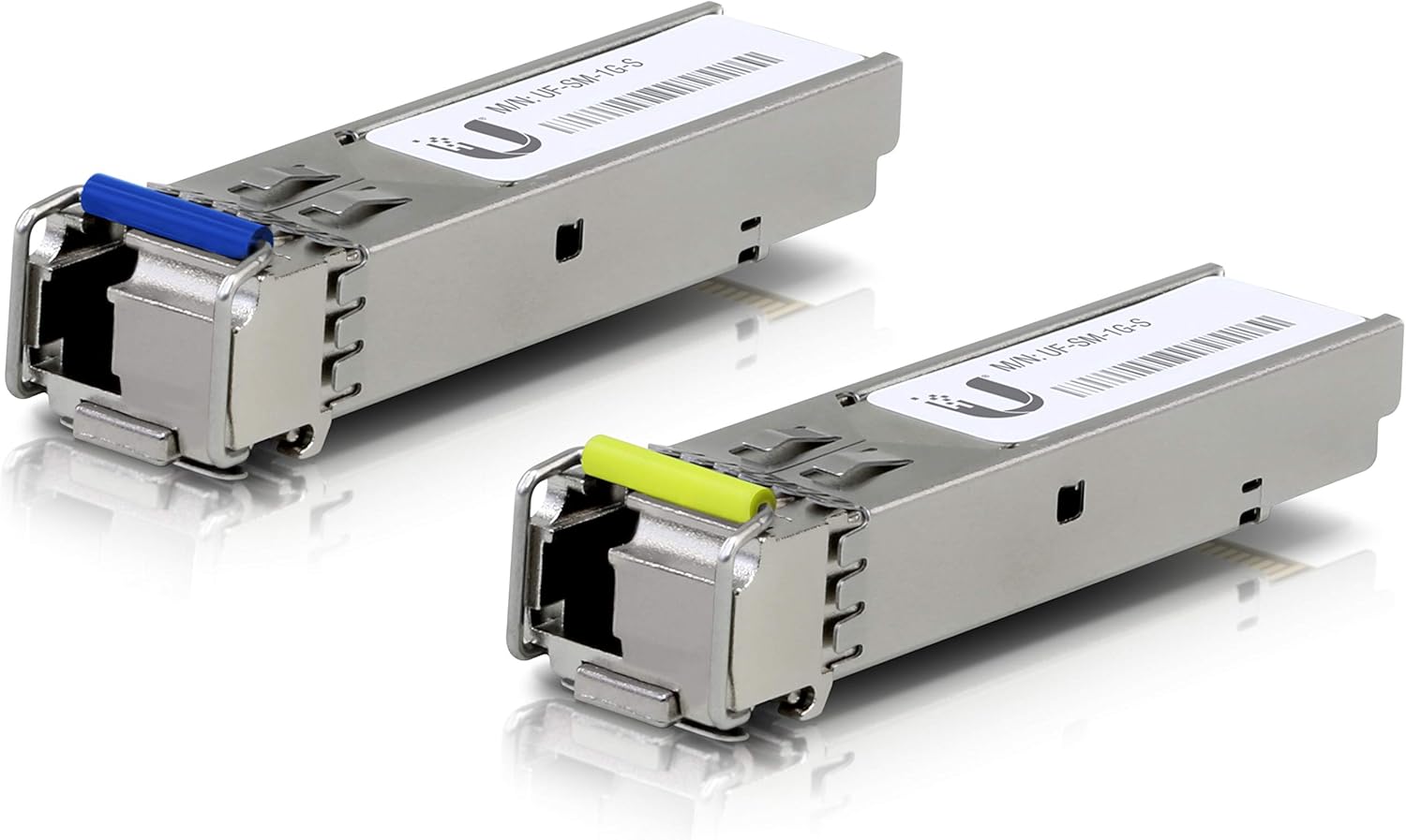

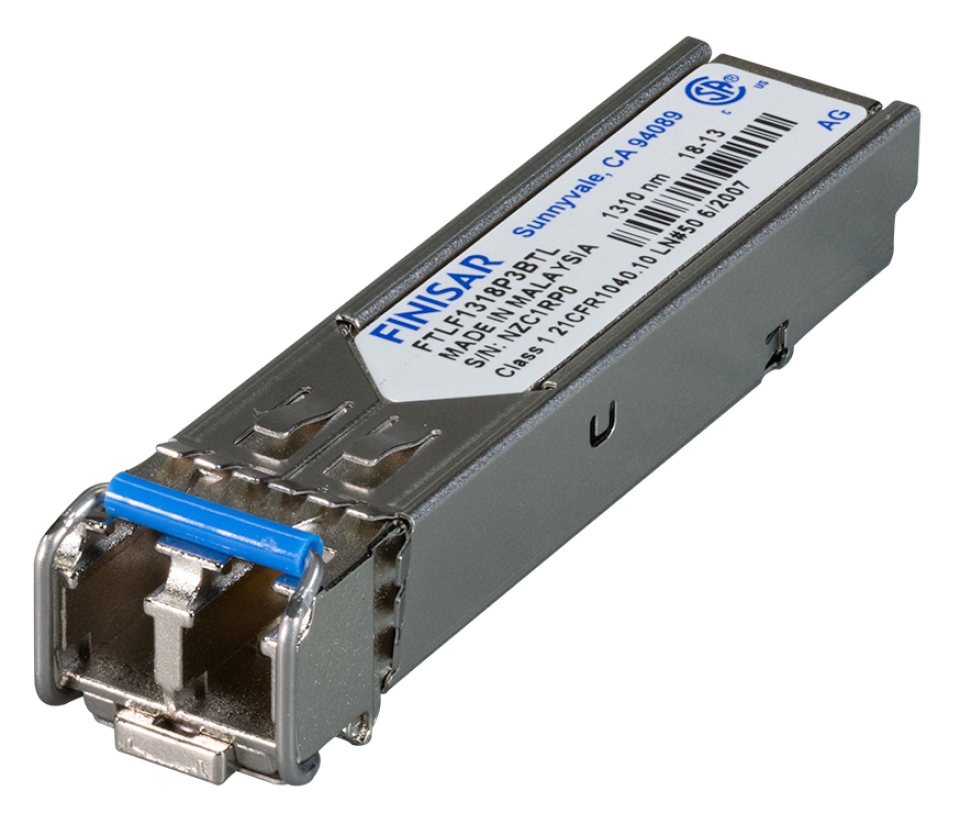

It seems that a simple google search does not help! You are still making serious confusions regarding the types of optical fiber and the types of SFP modules. I talked about multimode and single mode optical fiber and which types of SFP modules are suitable. Maybe it will help you understand better:
You can also read here on the forum:

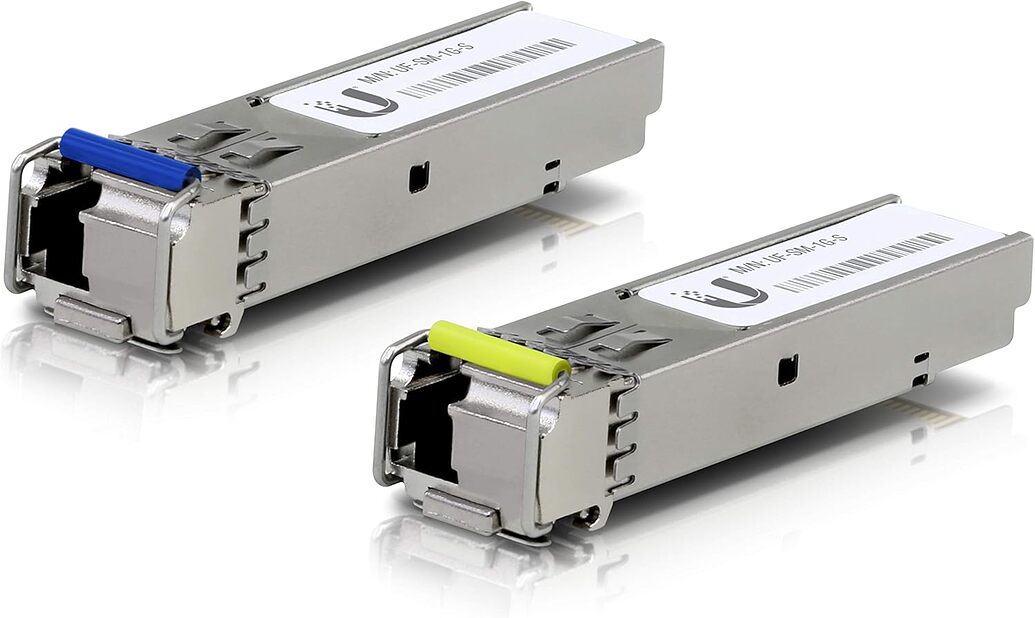

Simplex or duplex refers to the number of fibers in the patch, not the type of fiber. Simplex fiber requires a certain type of SFP module, namely BIDI modules (such as those delivered with the RSA720 or the RD160). See the attached images.
You don’t have to be an expert in fiber optics, it is enough to read a little documentation carefully.
