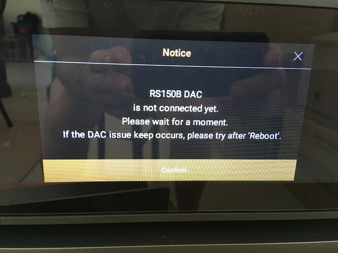

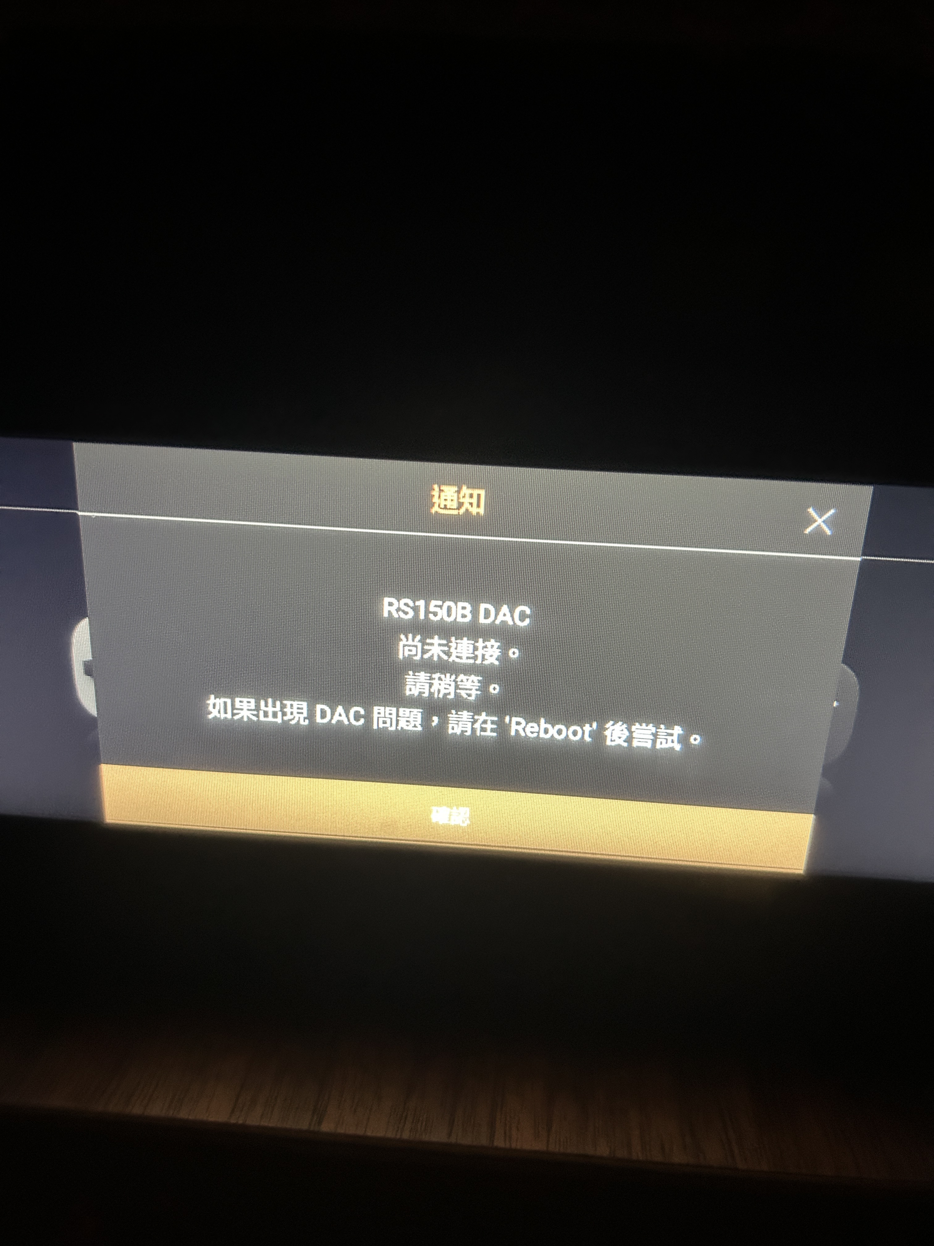

Recently, I noticed that the RS150B frequently powers on automatically while in standby mode, displaying a message saying the DAC is not connected and asking to restart.

This issue started after the update a few weeks ago. After shutting down and entering standby mode, the screen lights up shortly after and displays a message saying the DAC is not connected.

The image below appears when the RS150b’s built-in DAC isn’t recognized.
In this case, replacing the RS150b’s audio board can easily resolve the issue.
If you’re using an external DAC instead of the RS150b’s built-in DAC, there should be no problem. However, we still recommend replacing your RS150b’s audio board.

When the RS150B is in standby with sleep mode, it automatically powers on and displays a “DAC not connected” message. However, after rebooting, the RS150B operates normally without issues. If you choose to power off the device instead of entering standby with sleep mode, the “DAC not connected” problem does not occur. Therefore, choosing standby or sleep mode leads to an endless cycle of errors.
