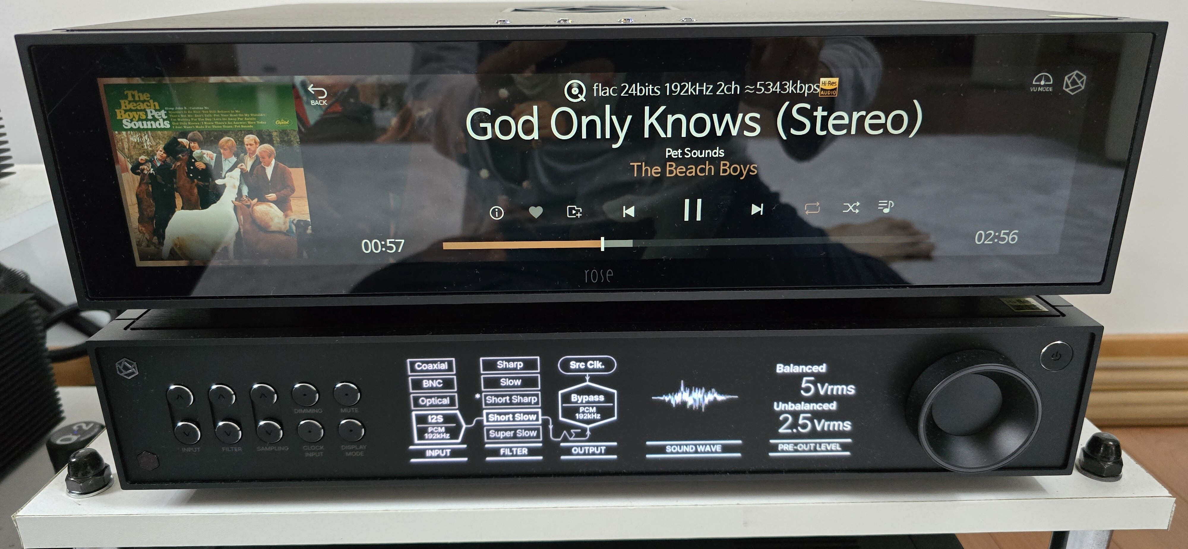

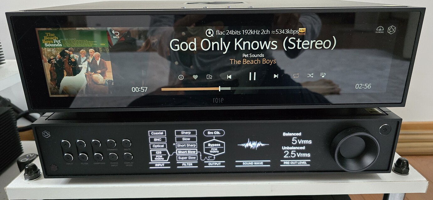

My RS130 plays tracks from Qobuz in Flac with 24 bits 192 kHz as you can see below :
I’m sure it does just not sure why it’s not for me at the moment will keep trying to tweak setting ,but at this stage looks like it’s going back to store .
