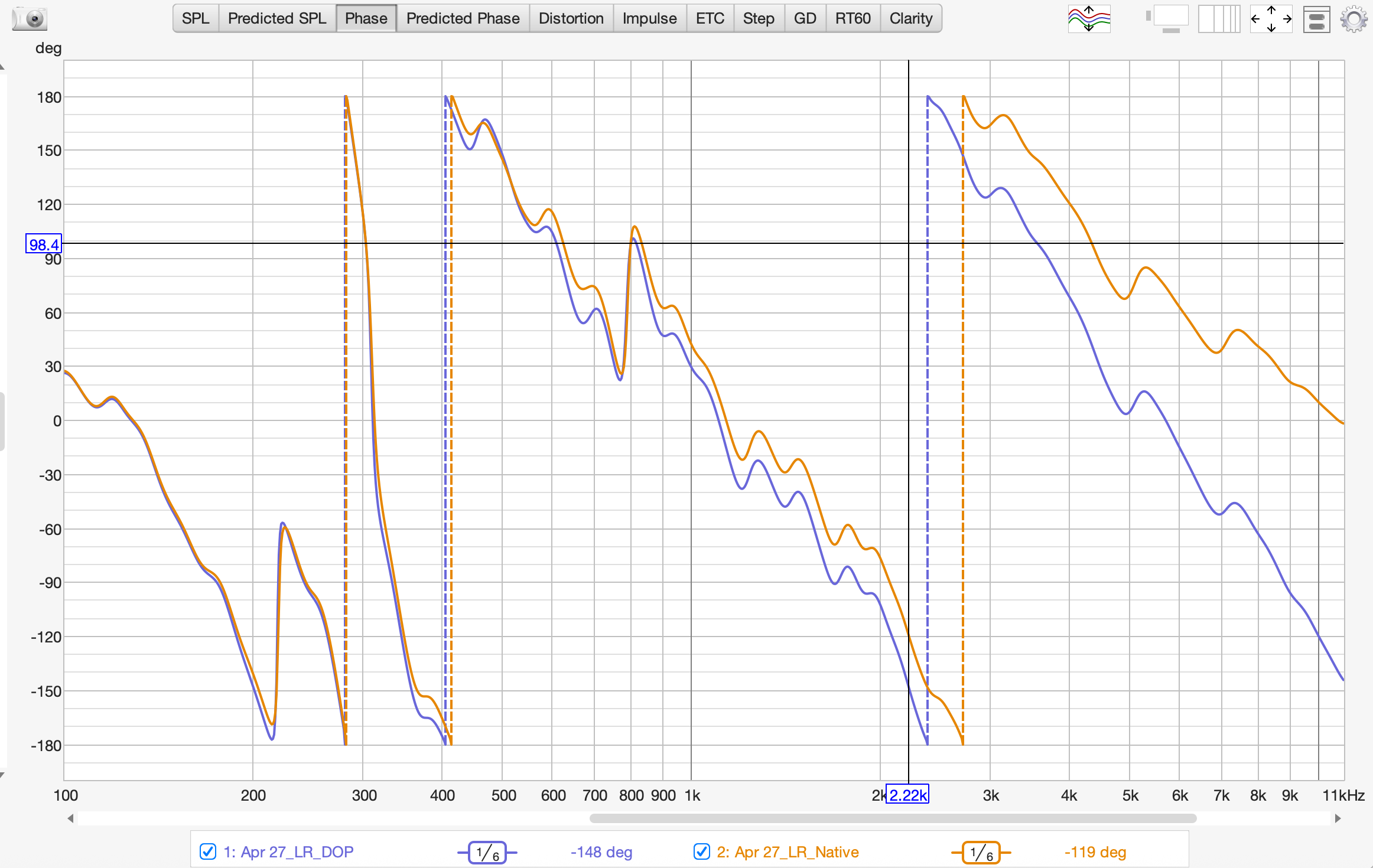

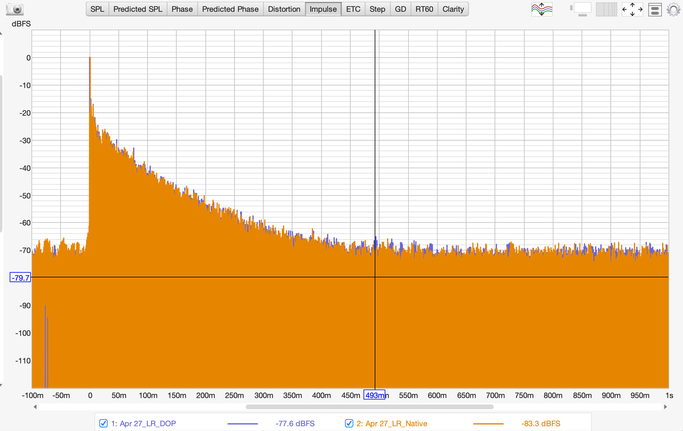

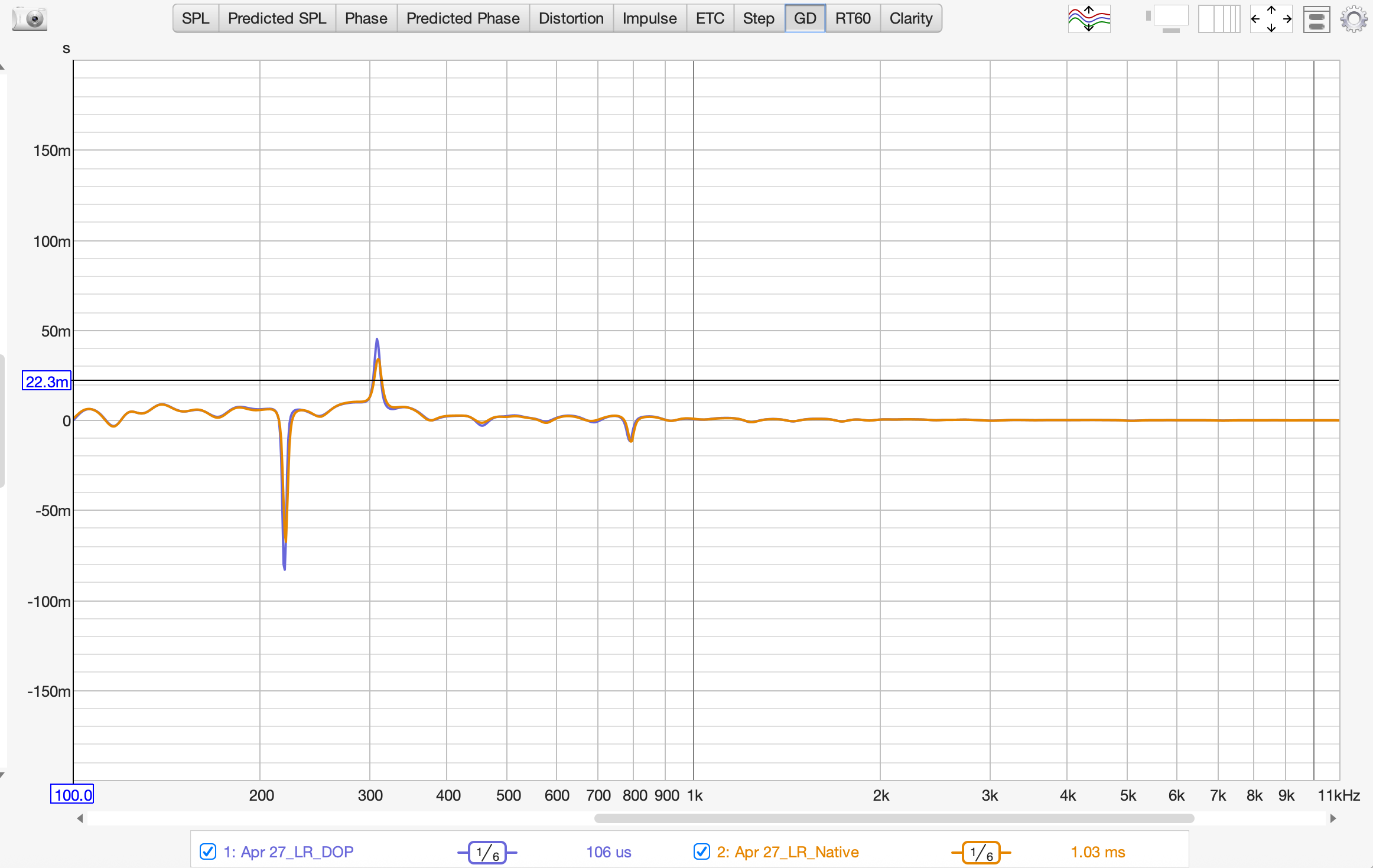

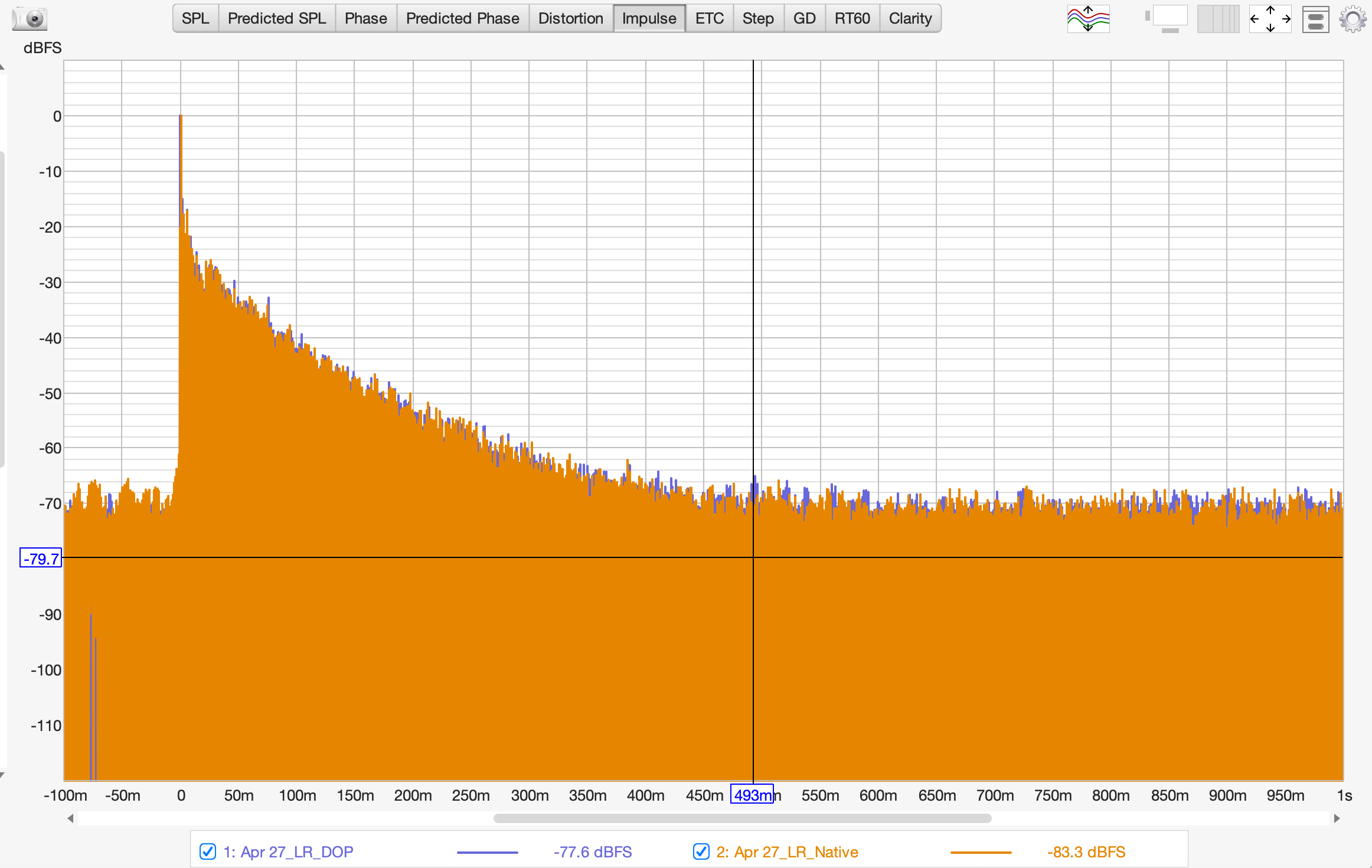

It has been a while but made additional changes to the overall system including the room with treatments, but the Class Delta Pre/DAC and HiFi Rose RS130 over USB remains and I’ve settled on “Native” for IN/OUT Settings as being preferred. It just sounds more natural, better layered, and vocals much more centered. I decided to take some room measurements in comparison to DoP. They are largely the same in most, but there is some interesting stuff with phase that can also be seen on the impulse chart. The tests were from basic sweeps in REW.
