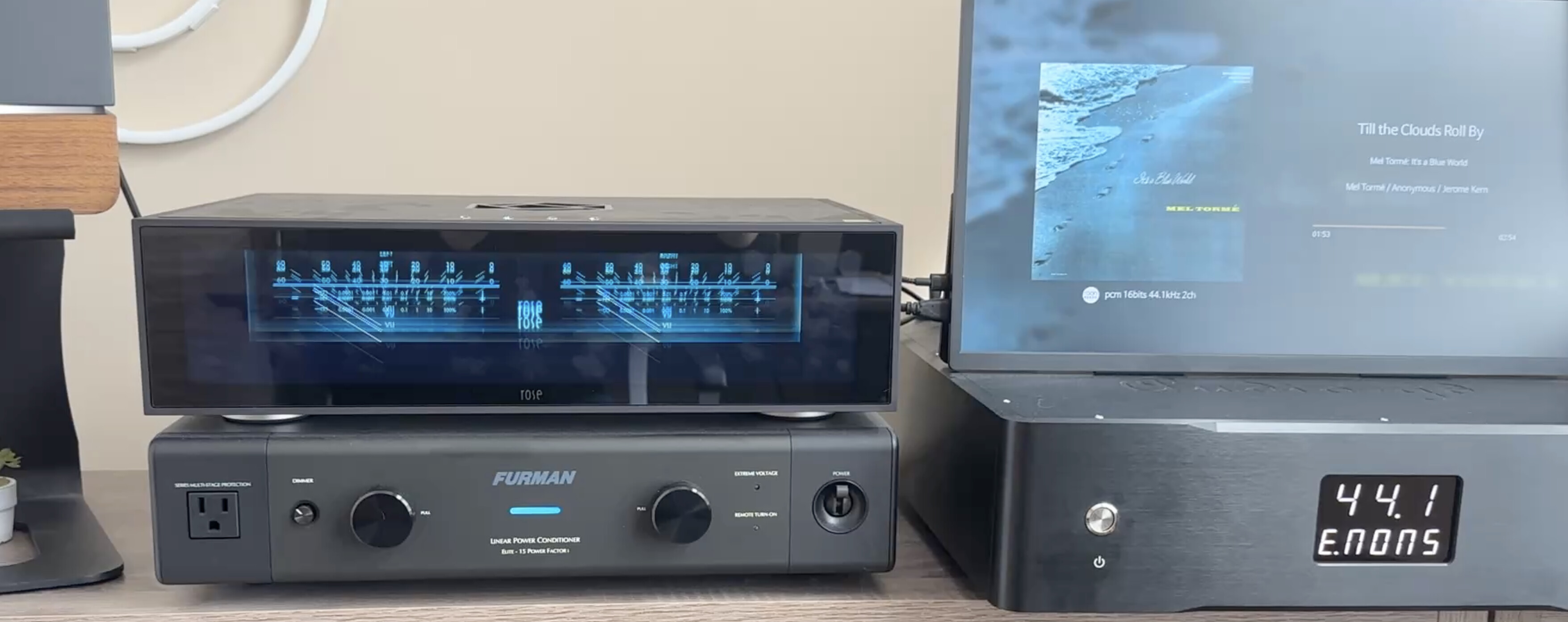

Here’s what the screen flicker looked like on my RS130 when it failed (photo attached).
I can’t speak to overall failure rates, but based on what I’ve seen discussed by other owners, I’m personally concerned this may not be a rare one-off. I asked HiFi Rose for additional clarity around how common this issue is and what owners should expect, but they declined to provide further detail beyond general guidance and distributor-based support.
So at this point, all I can suggest is that RS130 owners document any symptoms early, keep good records, and be prepared to work through their distributor for service if it happens.
Good luck, everyone.
