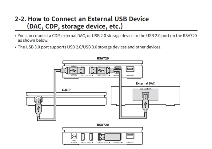

The RSA720 is a USB hub and according to the manual, several types of equipment can be connected.

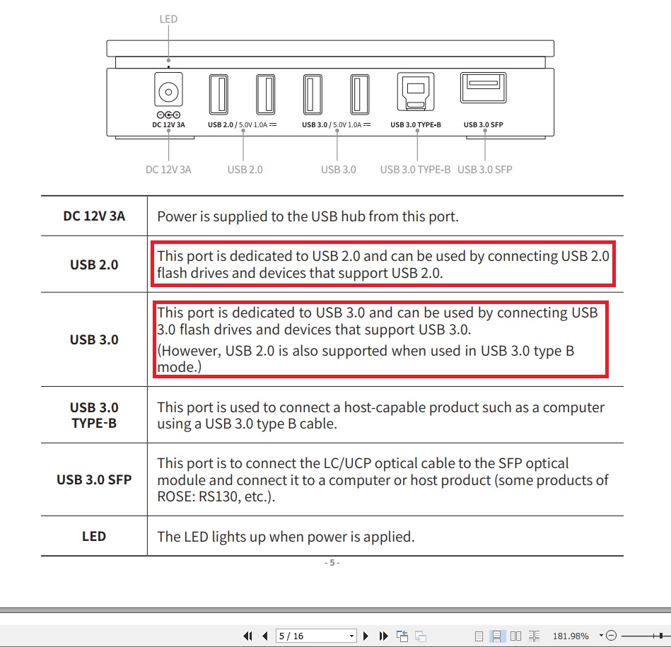

I think you don’t really understand anything from the manual or you are using a bad translator! It is written very clearly in the manual:
ports

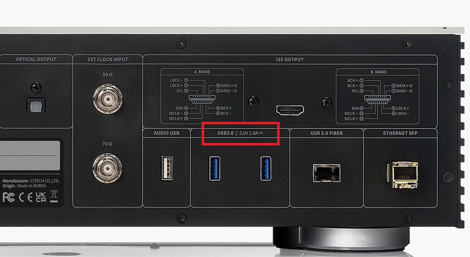

  1. The USB ports on the RS130, where the Apple SuperDrive works, are 3.0:
    back
  2. My DAC is connected to the RSA720 via USB 2.0 and the RSA720 is connected via fiber optic to the RS130 and it works great.
I said Page 9 twice. I also said that I did not know for sure this was the issue, but that it was worth a try. Anyway, this is what it says on Page 9:
3-1. How to Connect a USB 3.0 Fiber Optical Cable
As shown in the figure below, connect a fiber optical cable to the SFP connector of the RSA720
and connect the other side of the cable to a device that supports SFP optical terminals such as an RS130.
Caution: When using in SFP mode, the USB 3.0 port on the main body does not support USB 2.0 devices, so make sure to use only USB 3.0 devices.
