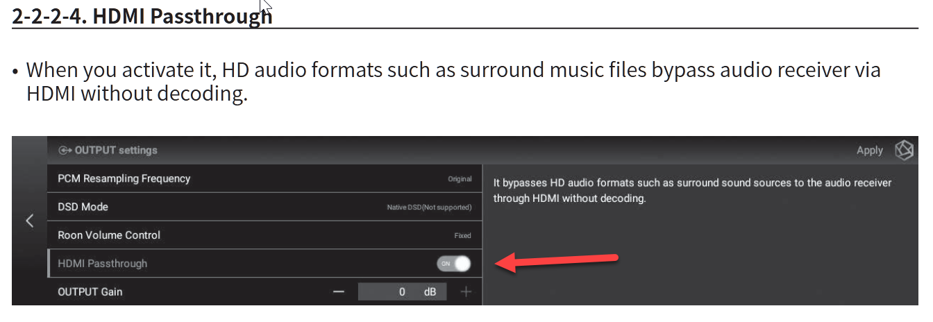

Please check a few things.
  1. Do you hear sound before connecting RS150b and TV with HDMI cable?
If you hear sound, connect HDMI cable and do not need to set other settings in input/output settings.
  1. Is the port number you connected to HDMI port on TV and external input on TV the same?
Please check the video below.
