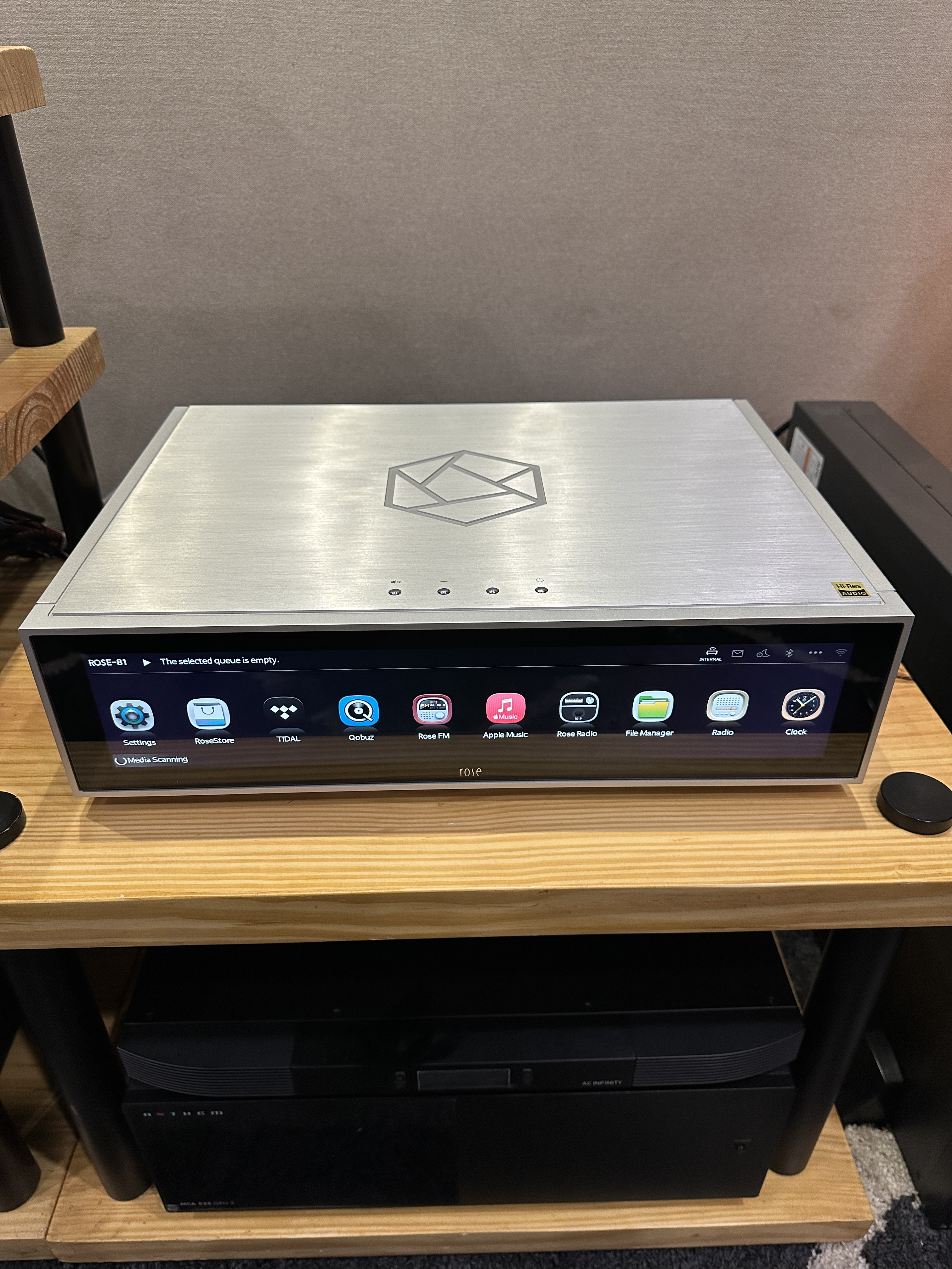

Hifi Rose RS 151 New Device have some questions Regarding this Font and Preamp Function

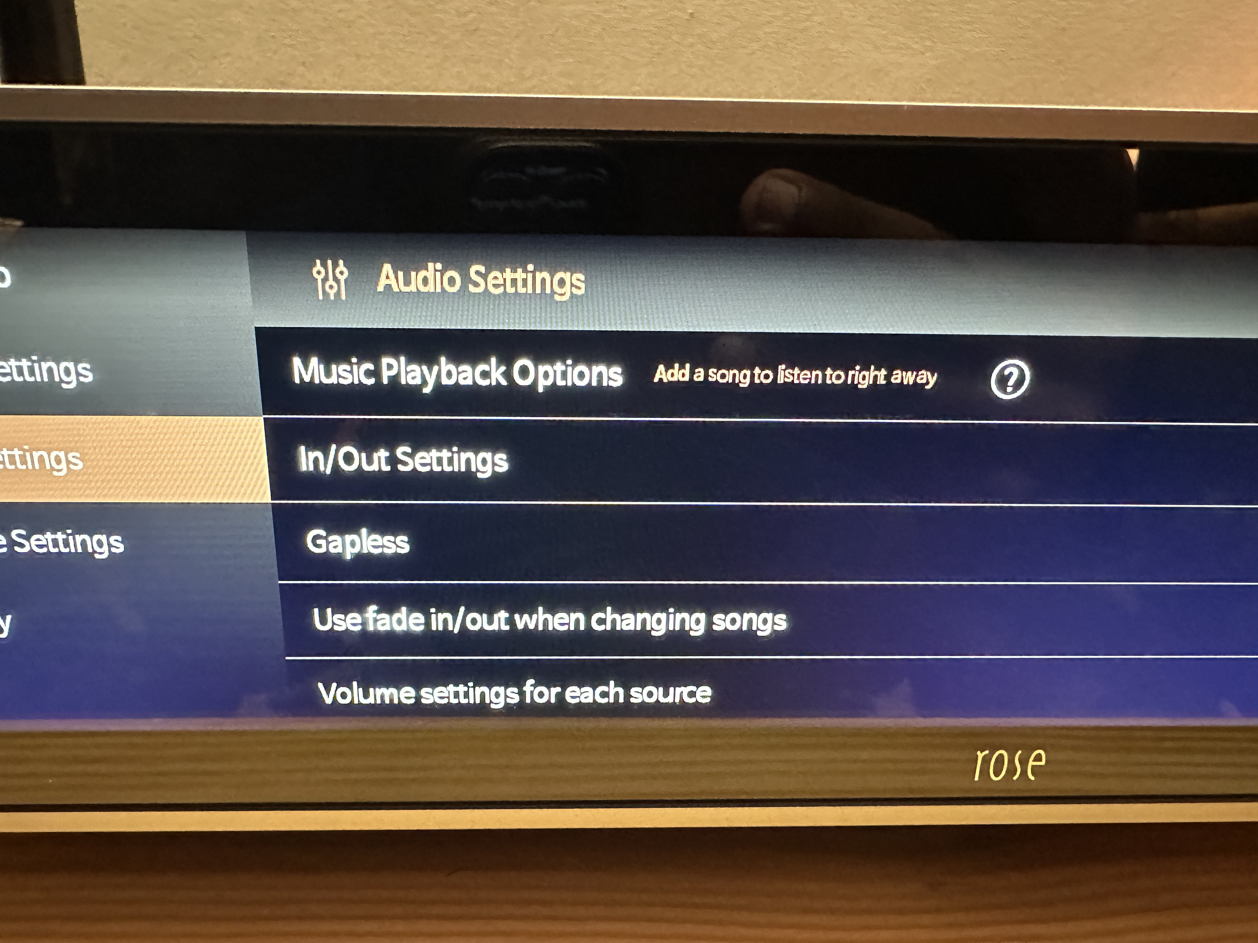

Just got this Beauty today and i noticed The font is kind of weird as you can see in image
i dont know what to do or from where to change the font

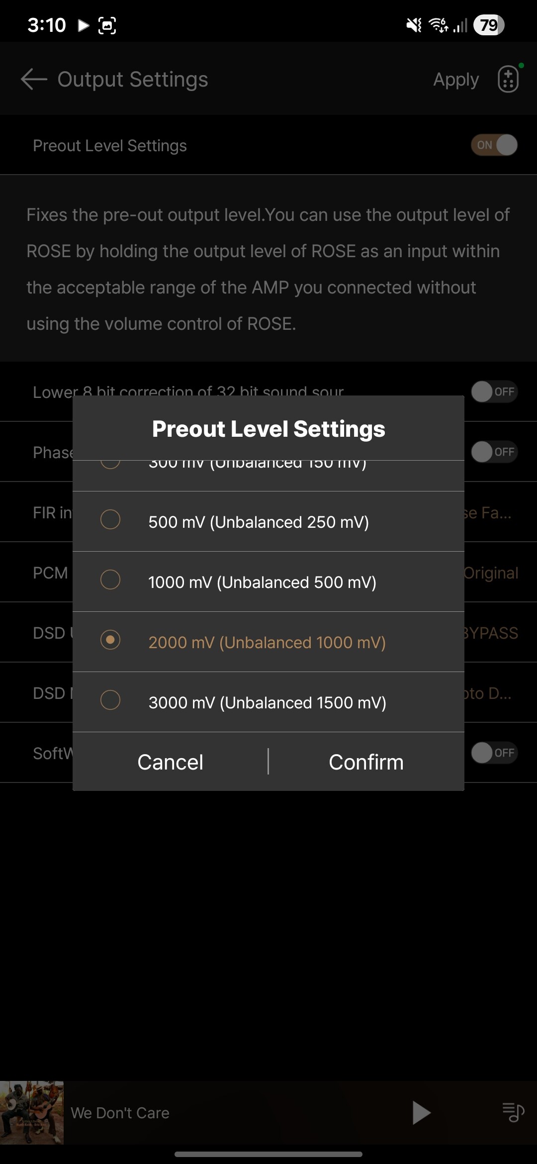

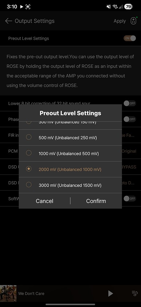

and i noticed i have to increase the volume from my device to full then i start getting sound in my Integrated Amplifier how to fix this?

What’s wrong with the font?
If you are using an integrated amp (which probably has volume control) you should set Rose to fixed output, at whatever voltage is best for your amp’s input (2.something V should be generally good).

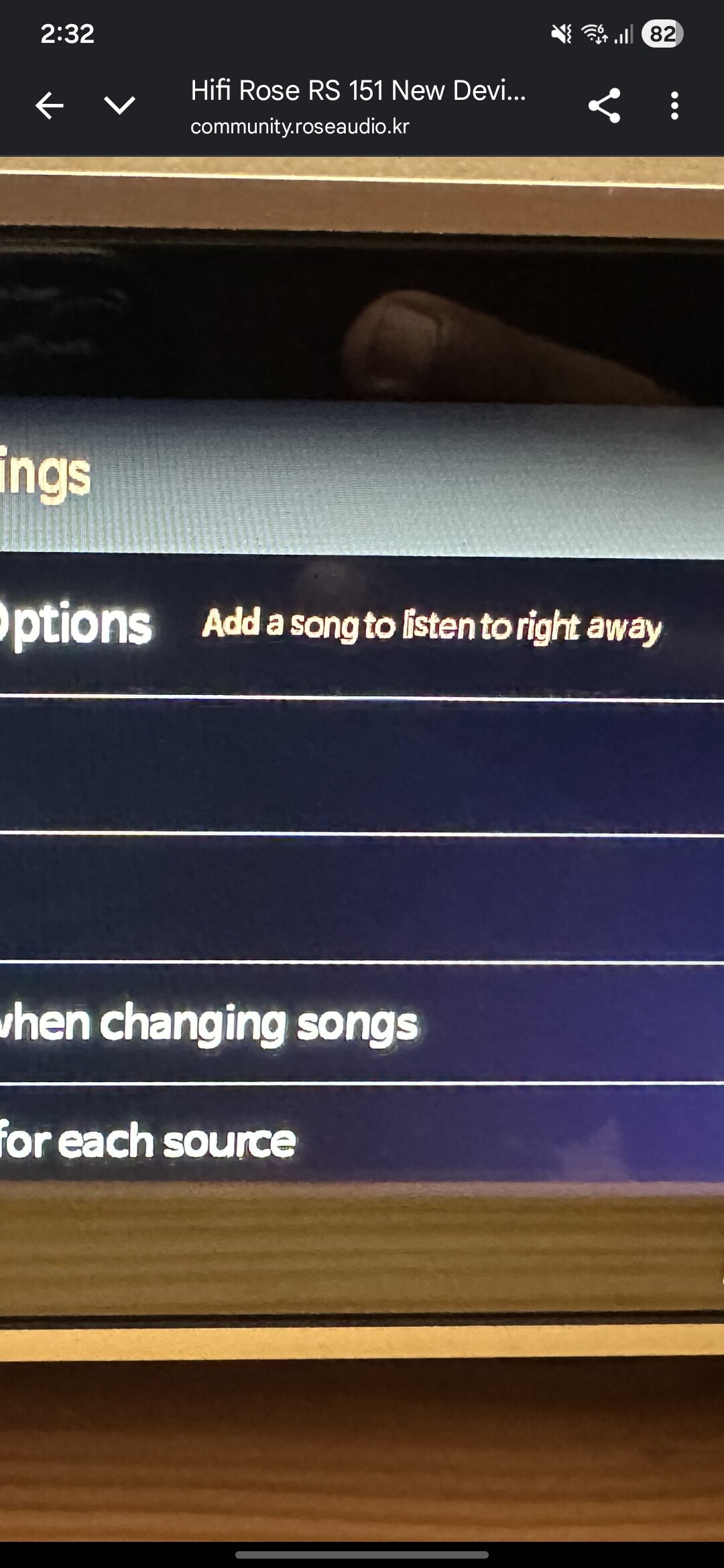

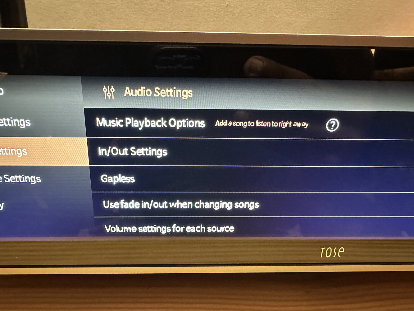

See this font I am not sure if this is how it’s supposed to be
Add a sing to listen right away
And how to check which mv is best for my amp

Hmm, that looks a bit off. Is anything else that could be displayed in that area distorted, too?
2V for RCA or 4V for XLR connectors is a common “standard” so you can start there. If you get reasonable volume at a reasonable volume control position, it’s good.

  1. We have reviewed the issue and confirmed that the text “add a song to listen to right away” is displayed incorrectly only on the RS151.
    We have reported this to our software team, and they have confirmed that the fix will be applied in the next update.
  2. On the RS151 (and all Rose devices), there is no setting to change the system font.
  3. When using the RS151 as a source device, we generally recommend setting the Rose volume to maximum and controlling volume from your integrated amplifier.
    As @BorisM mentioned, you can also set a Fixed Output level in the Pre-out Level menu under I/O Settings.
    You may select the voltage value that best matches the input sensitivity of your amplifier.
