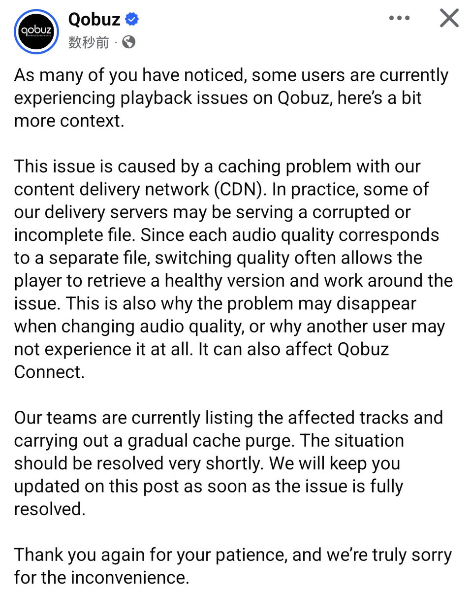

Upon checking today, I found that most of the tracks that wouldn’t play until yesterday are now working properly. It seems there was some maintenance or an update on Qobuz’s end, as described below.
That’s exactly what I was trying to convey. The problem is at Qobuz end. You probably intended to tag @Alberto
