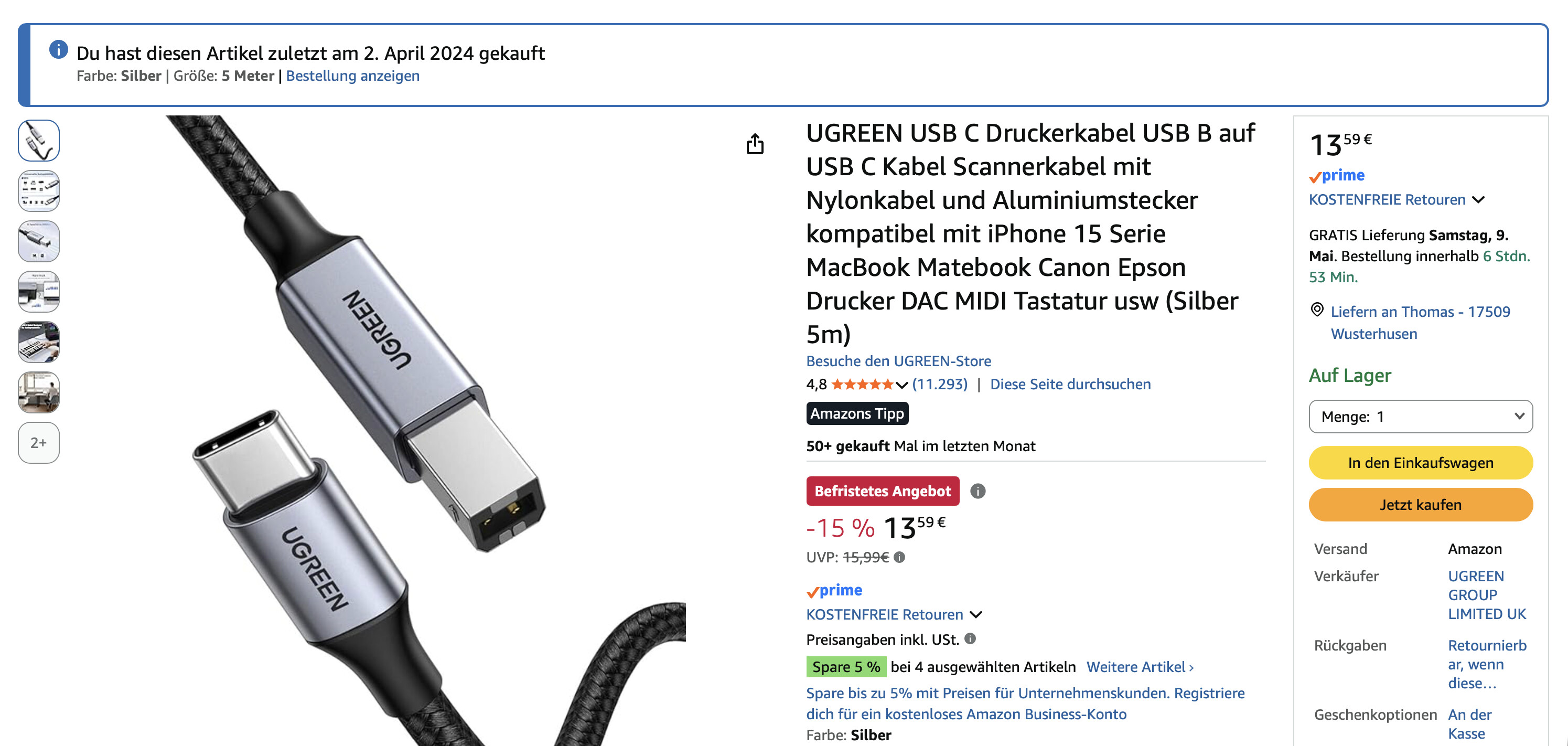

That would have done the trick, too.
Well then, you’re doing exactly the same thing I did back in the day. It’s not exactly rocket science.
I had it on the 520 and everything went smoothly.
Oh, and by the way both Amazon and Microcenter (and our local electronics chain here) show them as very much available and in stock. Of course you need to know what to search for, but they are available now.
