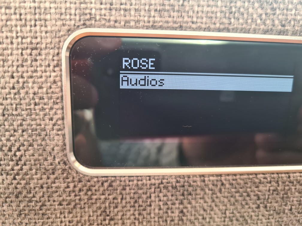

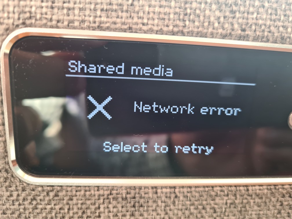

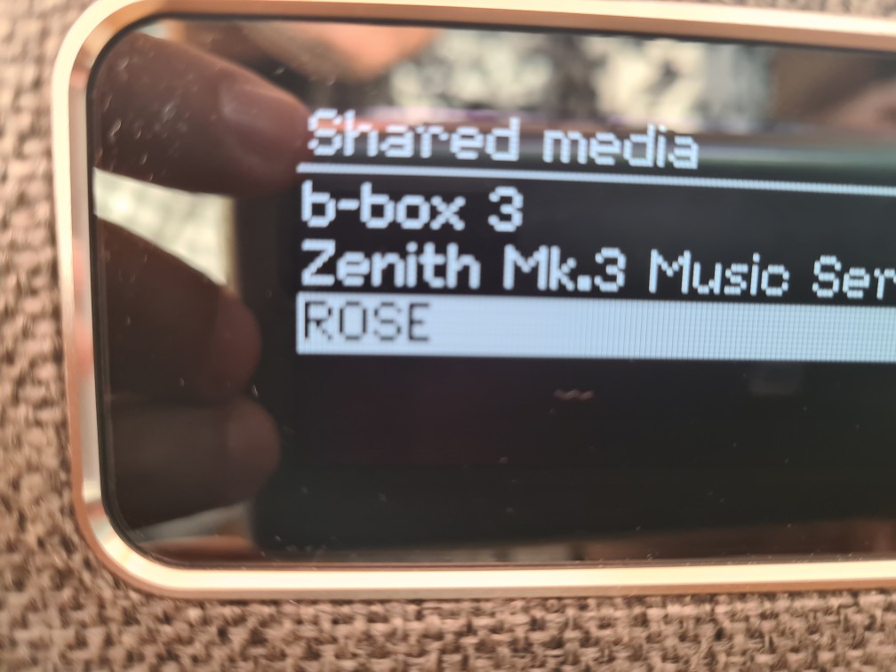

3- I have 3 radios which can read/play my music files on my network, when rose appears they don’t find the album file and timeout appears immediately.

About the 3 radio channels you have… Where is it saved? In NAS? Can you give a screenshot about the timeout?
Yes, my Roon Core and NAS allows SMBv1. The Roon Core can play the Music stored on the NAS but it can’t play Music stored on RS150…
You will find attached a screen shot for Ruark R5, and if you want I can send you for Pure Evoke 6 and for Revo Axis,
