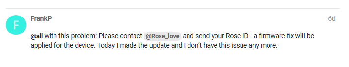

@all with this problem: Please contact @Rose_love and send your Rose-ID - a firmware-fix will be applied for the device. Today I made the update and I don’t have this issue any more.
