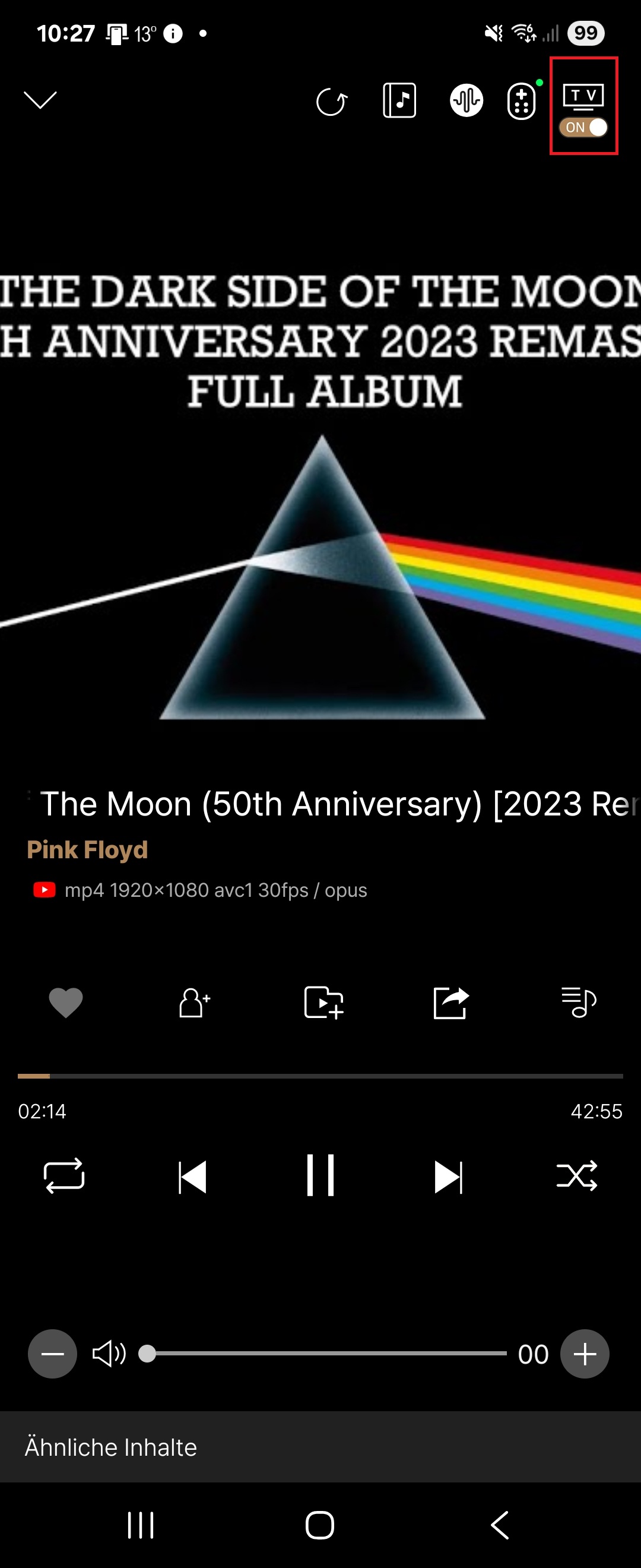

The same on the device, also in the playback screen

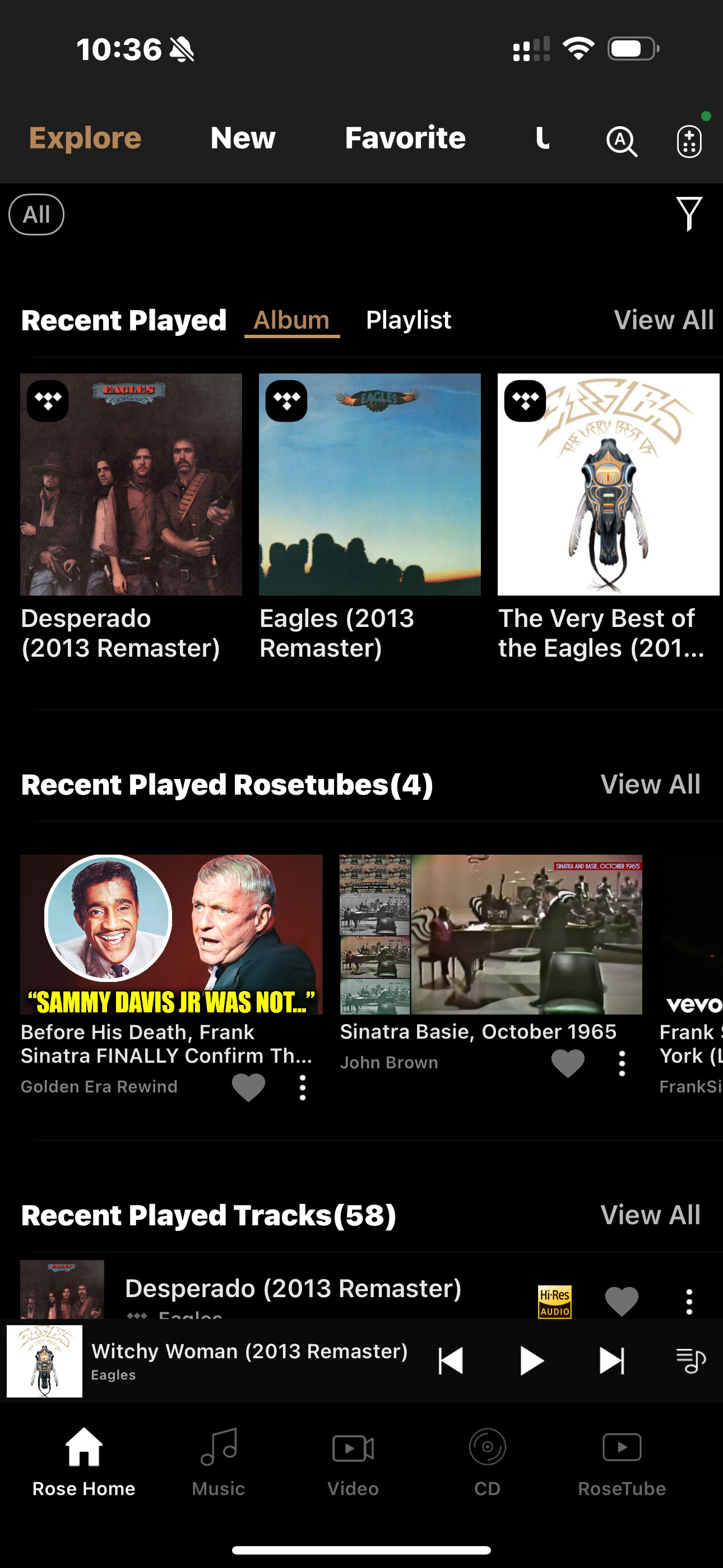

Thank you both for the suggestions. Software is up-to-date, HDMI is selected. Kip, attached is my screen shot. I don’t see the TV icon like yours. Thanks! Pete
You should be able to see it when launching a video —have a look on the Rose screen.
Do make sure, however, to check the quality of your hdmi cable and confirm that the HDMI port on your television corresponds to the one to which the Rose is connected.

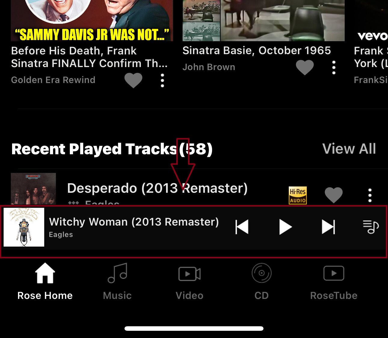

The TV icon is only displayed on the playback screen and only when a video is played e.g. via Rosetube. To do so, simply tap the bar at the bottom.
