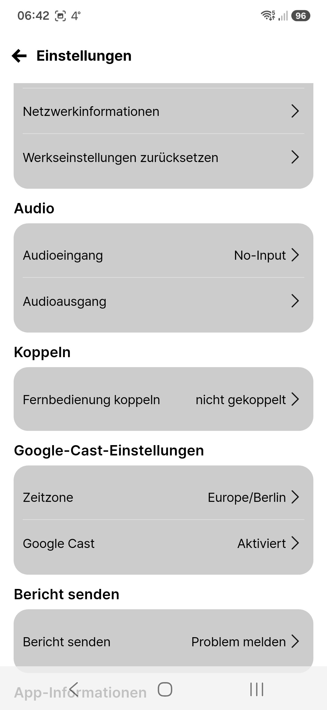

You’ve to use the Rose Air app for changing the in- or output:
and then you can change it under audio:
