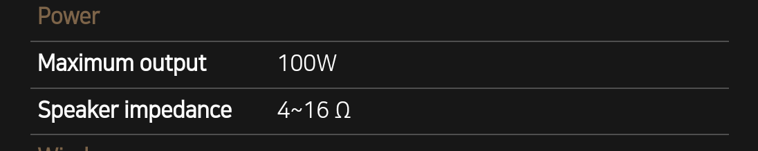

I found the output power is 100W, is it 100W x 2 or 50W x 2 if I connect RS201E with a pair of 4ohm speakers?
Maximum output power is declared at a load of eight ohms.
However, it varies according to speaker impedance. There is no clear rule of thumb, but usually, power goes up at half of the nominal impedance between 50 and 100 percent (so this can be anything between 100 and 200 watts at eight ohms). What this statement means is that a four-ohm load is expected to work without any problems.
Please, have in mind one important thing. By IEC definition, speaker impedance should not fall below 80 percent of declared impedance. Still, speaker makers are not strict about that, but, in theory, at least six-ohm speakers must not fall under 4.8 ohms or 8-ohm speakers under 5.4.
