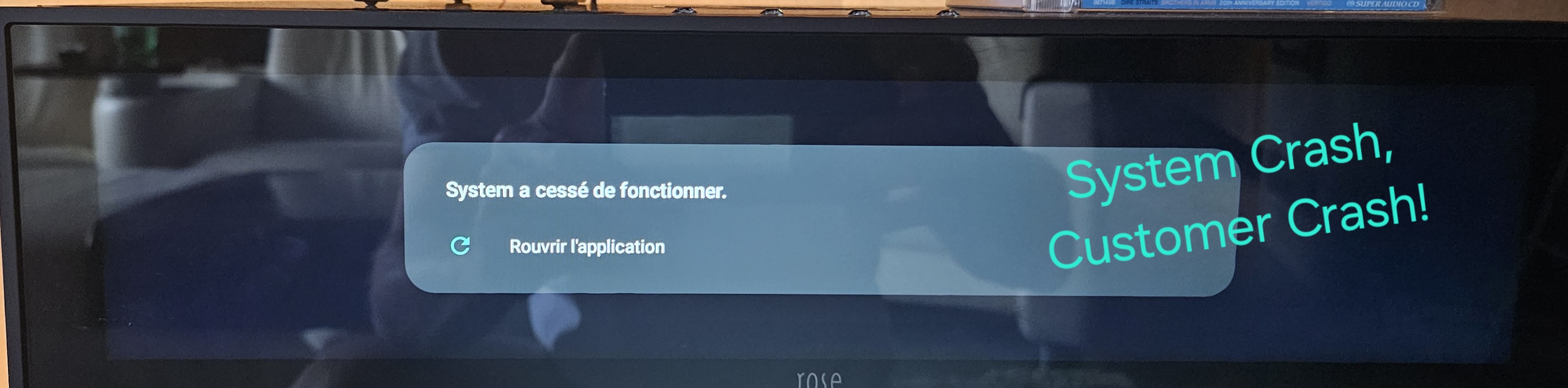

Ce n’est pas le Rs130 qui est en cause car avec Roon ça fonctionne parfaitement. C’est l’application que les développeurs ont négligé et continue de prendre les utilisateurs pour des pigeons. [quote=“GuileZ_Kicked, post:1, topic:10197, full:true”]
I just bought a DAC that requires a PCM delay to avoid cuts at the beginning of tracks or when searching in the track. On my RS130 this does not work, I use the coaxial digital output.
I can set it in the menu to 500 ms or 3 seconds, it does not change anything at all.
I tested with the Roon application controlling the RS130 where the setting is also available, it works perfectly. Even when moving the track cursor I have no cuts and the sound reappears absolutely instantly. Unlike the RS130 where a fairly significant latency is noted with the loading circle that appears for 2-3 seconds at each action of changing track or searching in the track with obviously a digital unlocking of the DAC.
My RS130 is 100% up to date as well as all the applications.
@ROSEHAN can you help me solve this because it is super annoying.
Thank you very much.
[/quote]
It is not the Rs130 that is at issue because with Roon it works perfectly. This is the application that developers have neglected and continues to take users for pigeons
