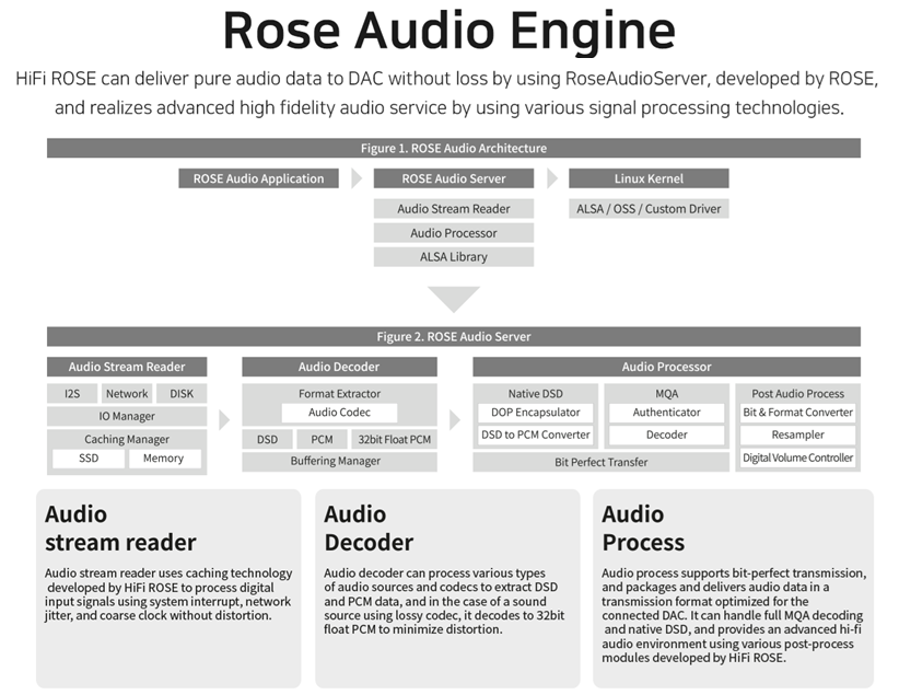

What you are experiencing is not a malfunction of your RS130, but a limitation of Apple Music playback on Rose OS.
Apple Music currently delivers its audio stream to third-party devices in a fixed output format. On the RS130, this results in playback at 96 kHz by default, or at 192 kHz when a higher maximum sample rate is selected in the settings.
Because of this, the Resample Rate = Original option cannot pass the “native/original” sample rate from Apple Music. Instead, the stream is automatically converted to one of these fixed rates before being sent to your DAC.
This behavior is the same across both USB and S/PDIF outputs and is specific to Apple Music integration on Rose OS. Other streaming services (such as Qobuz, TIDAL) and local file playback do follow the “Original” resampling setting correctly.

This is likely due to the Android SRC, but since other streaming services on Rose OS can playback at the original sample rate, I speculate that the Audio Engine is not applying that processing to Apple Music. (It seems not to be a technical issue, but rather because Rose does not require that level of audio quality for Apple Music playback.)
