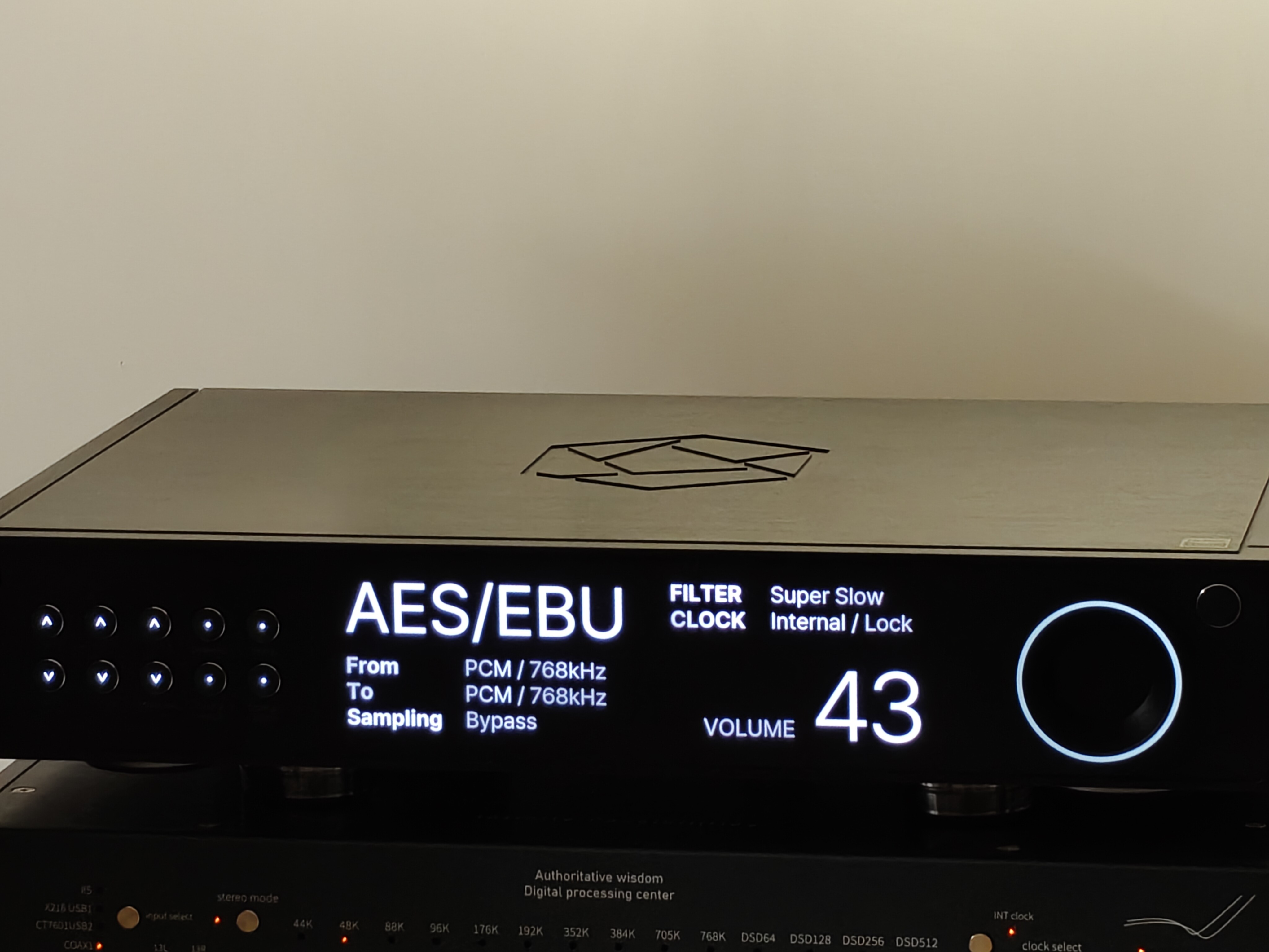

PCM768 on AES input with RD160?
Am I tripping? Is PCM768 physically possible?

This is what I meant. AES is not supposed to be able to take native PCM768 signals. But obviously the RD160 IS taking PCM768 thru AES…

It’s not about upsampling or not. You can see that the RD160 is showing “From PCM768”, which means it’s able to detect and playback PCM768 signals from the AES input port, which generally should be considered physically impossible.

No bro, just look at the pic in the first place. My RD160 is using AES input, and it senses PCM768 and is playing music. I am outputting PCM768 on my source too, out of curiosity as a test.
That’s why I said am I tripping…

A single wire is supposed to be 192kHz and then 2 wire is 384kHz.
But… here’s the interesting thing… to get a PCM of 768 x 32bits, the clock signal would have to be around 49kHz (49.216kHz to be exact) at least according to Google.
So if you are sending 768PCM to the Rose… if the clocks can sync… why would that be impossible?
