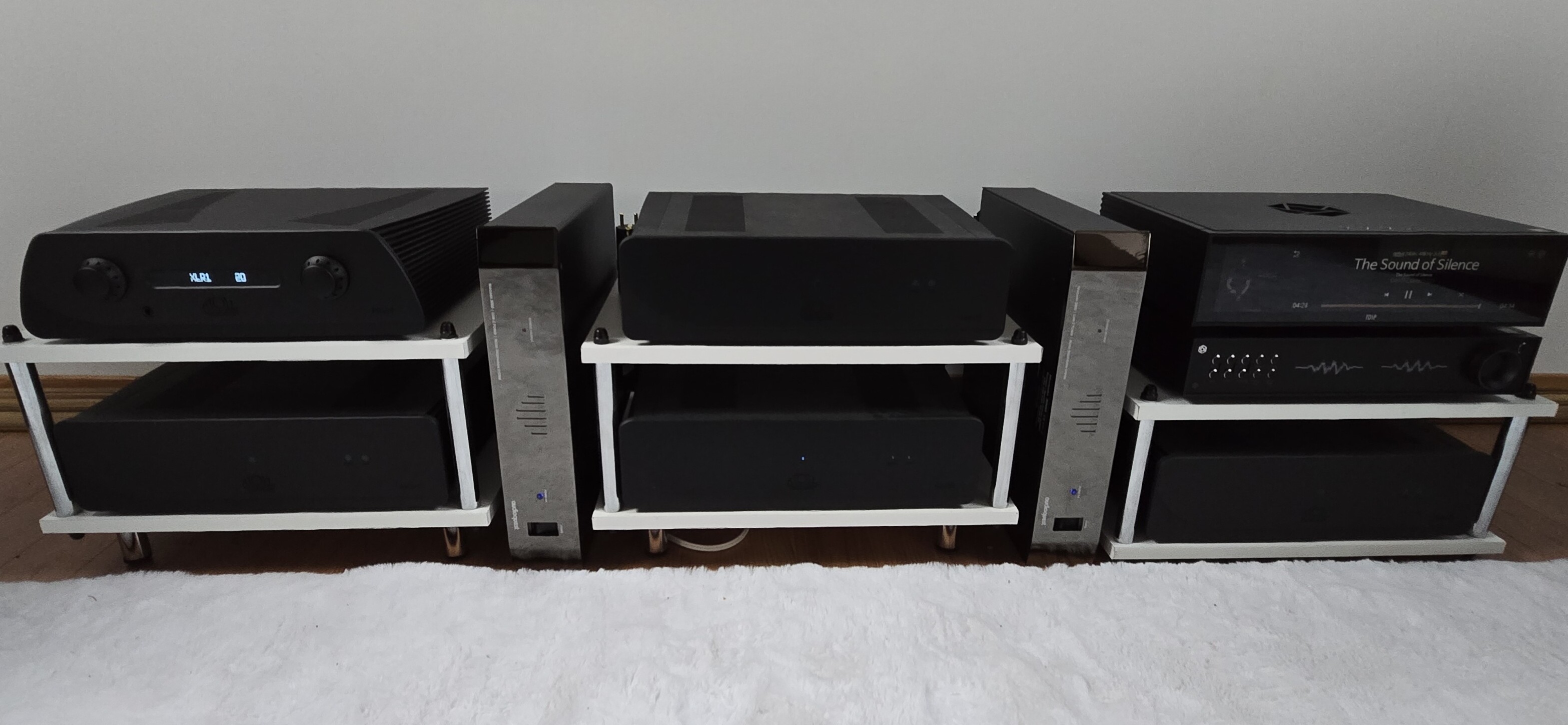

My UPS units are Eaton Ellipse PRO Line Interactive 1600 VA.
My power conditioners are AudioQuest Niagara 3000s.
(the two vertical boxes below)

It is fitting that your streamer is playing The Sound Of Silence. :grinning:
