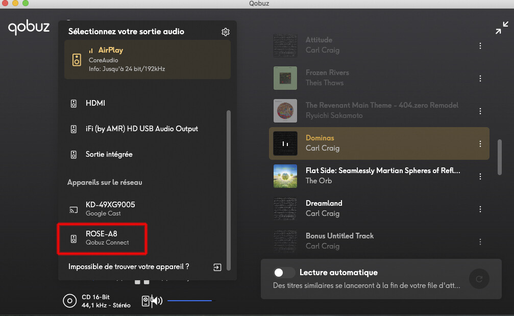

I have ā€œROSE A8 Qobuz connectā€ that appears, but when I click on it, it turns it turns…in the void.
It only works with Airplay (with a Macbook Intel).
Capture d’écran 2025-05-20 aĢ€ 13.28.43
