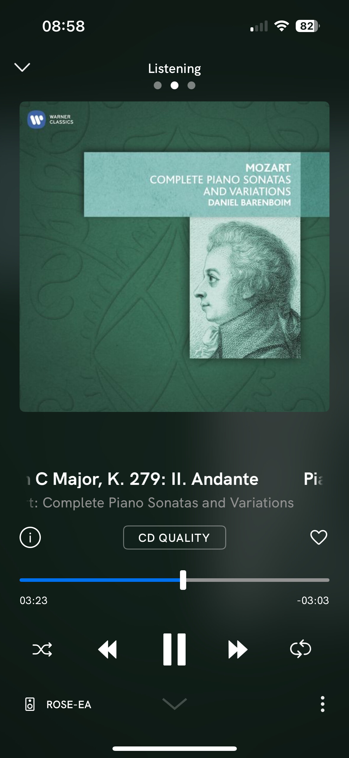

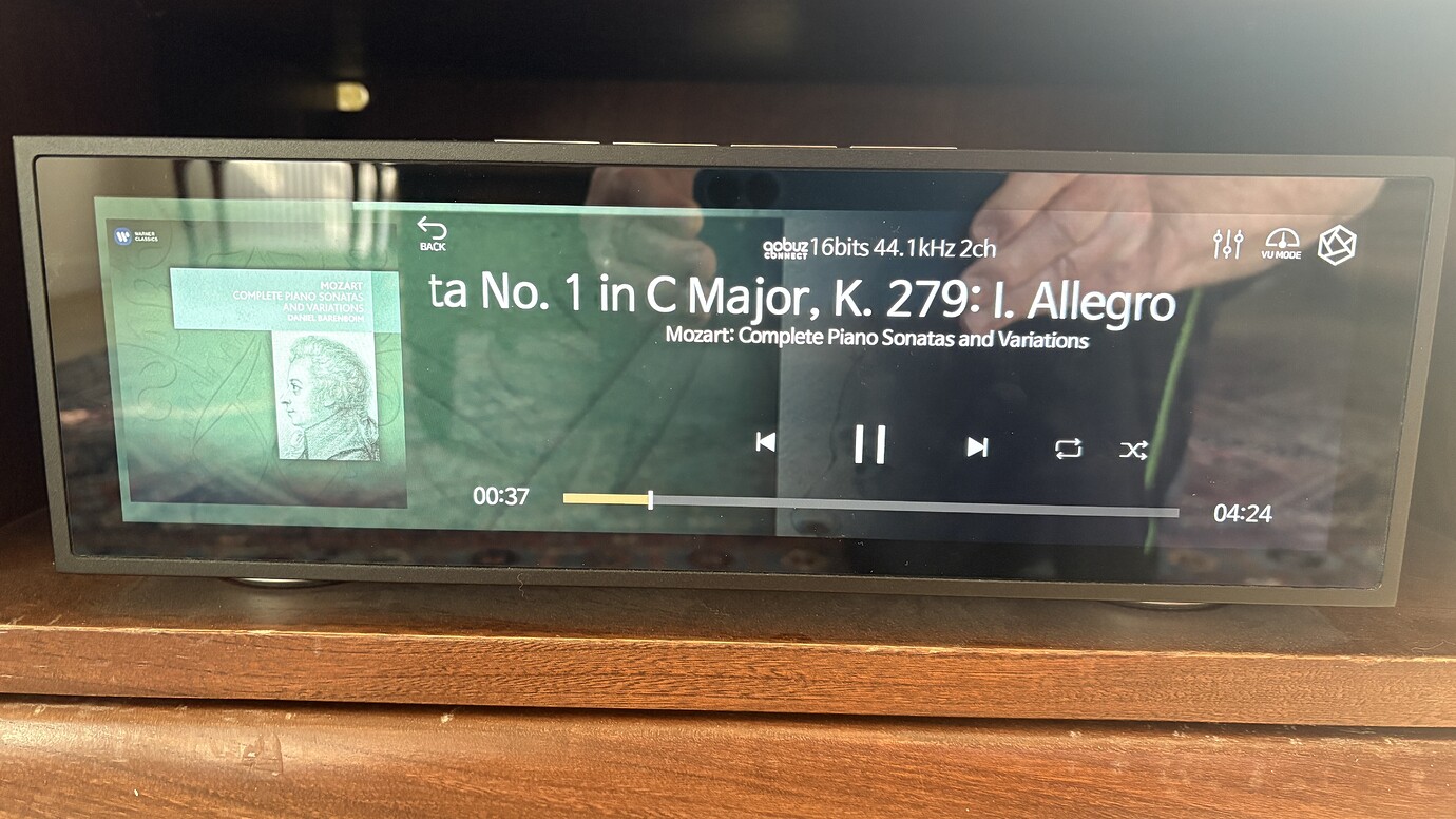

Happy to report that Qobuz Connect appears to be working perfectly. See attached
You are on the EA version with Qobuz Connect. See your photo on the bottom left.

I can assure that I have never used the EA version in the two years that I’ve owned the RS520. Maybe it’s a glitch.
This morning, I simply followed the update prompts on the RS 520. I have never switched to the EA version.

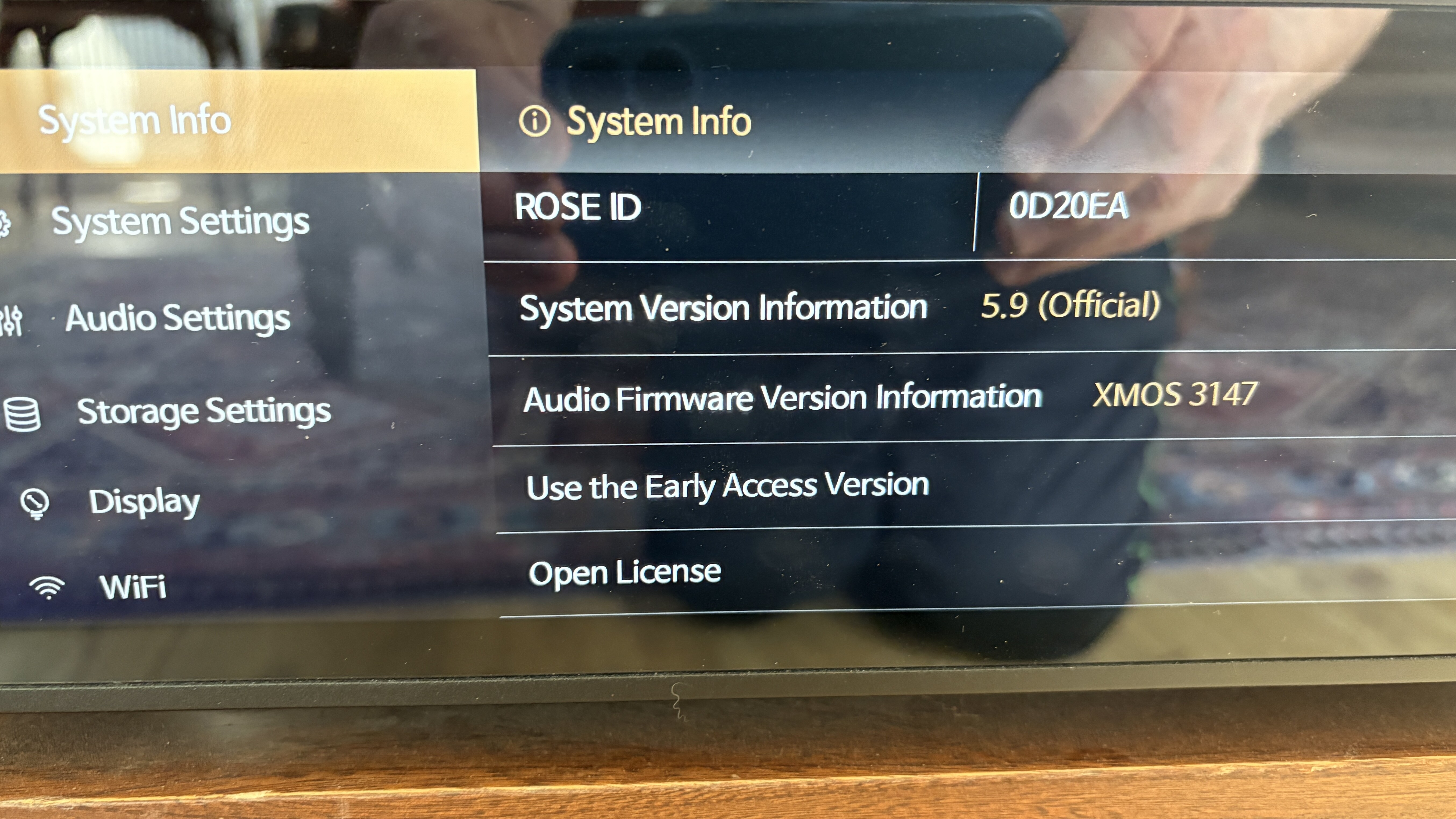

Additionally, my app is not the EA version. I’m given to understand that to run the EA version you have to run the EA app ?
Here is a shot of my System Settings.
Strange. Maybe somebody from Rose can comment ?
Thinking about it further, the Device Namegiven to my RS520 by Rose has, confusingly, always been Rose -EA !!
One practical glitch is that on some tracks there is a momentary “ stuttering” before it plays. Still some work in progress necessary, I think.
On my RS250 I have the version Early Acess 5.8, no update proposal to 5.9.
Should I be in Early Acess or not, thank you because I’m lost!
There is an official update 5.9, so you should not be on Early Access.
Thank you very much @Hen3, I will try a “back”

Yes working on the official version now but as mentioned above there is a “stutter” between tracks - VU meters work now though
