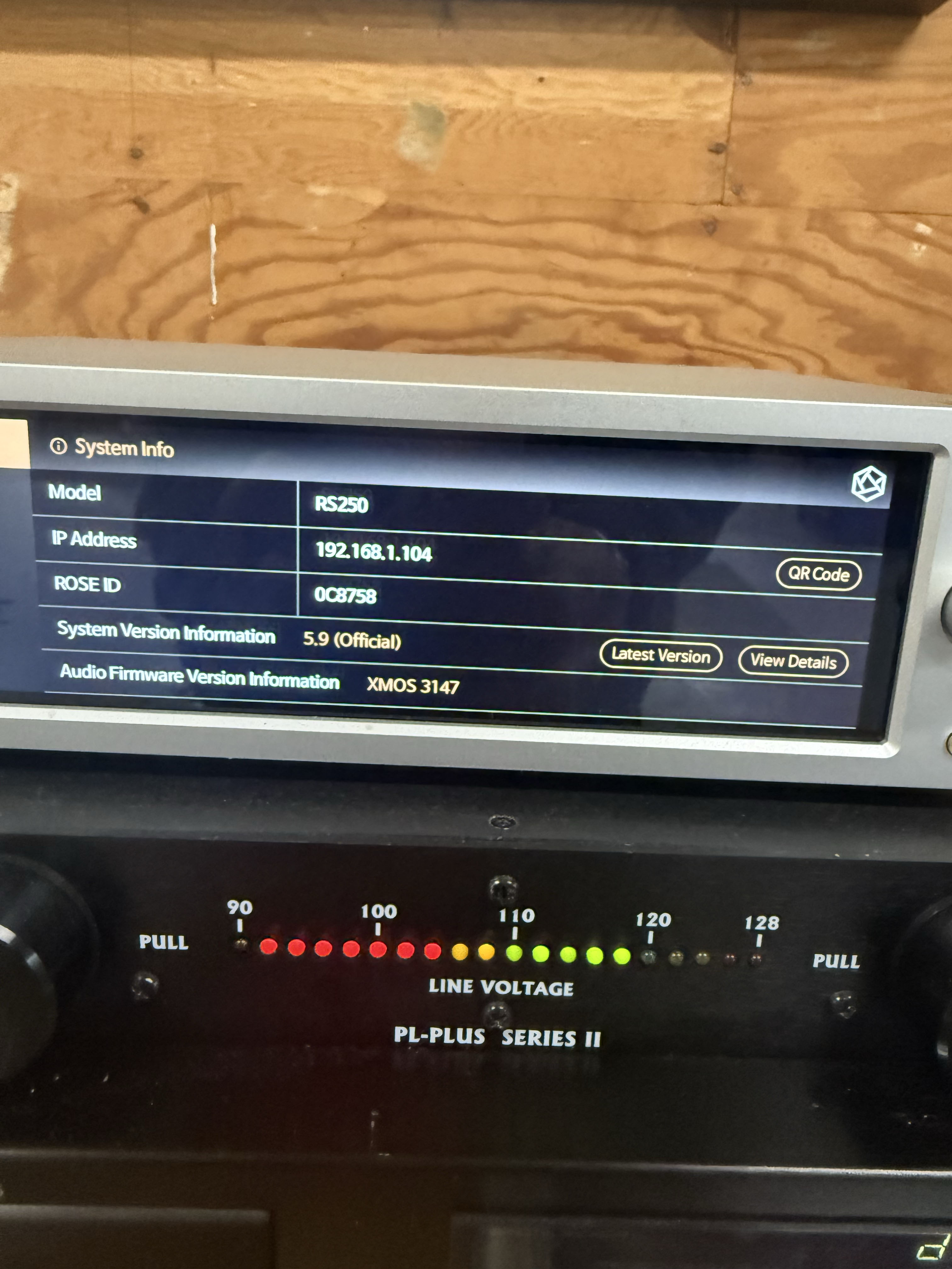

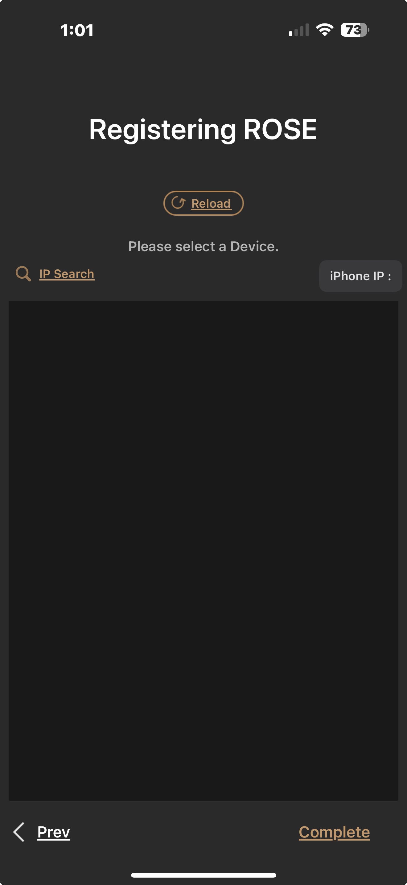

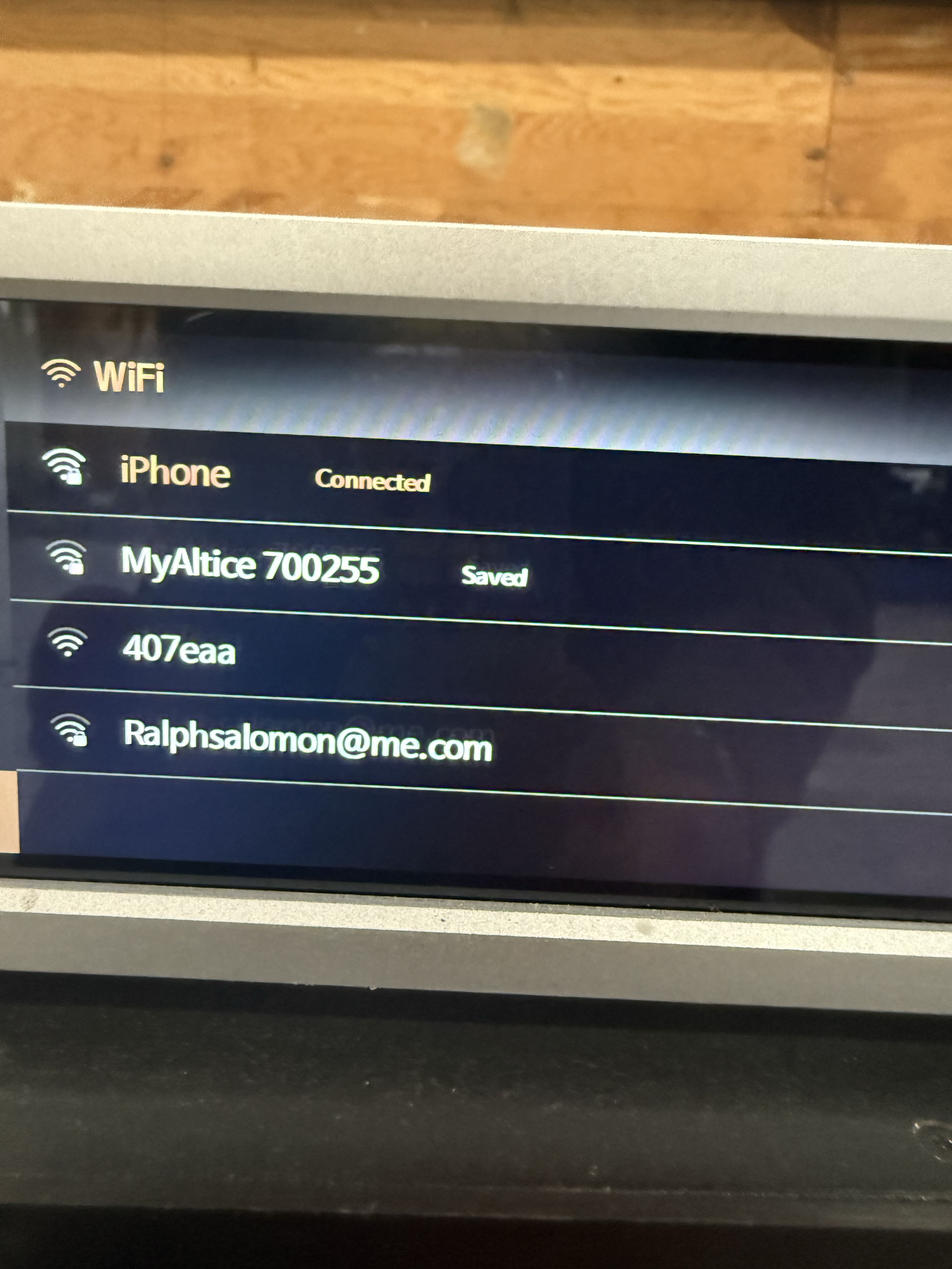

Here are the three images requested. I hope you can now help me connect the app. Clearly I can connect via hotspot. Thank you.
As a new user I can only post one image at a time so there will be three posts.
Image 2
image 3
@Fastracer88
If you can connect normally to the hotspot, it seems like the problem is with your home router.
Please try restarting your iPhone device and connect both the Rose device and your iPhone to the same SSID of the same router to check.

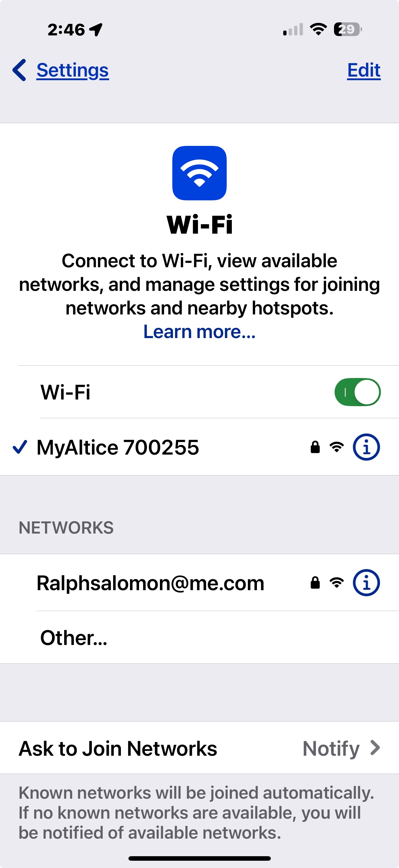

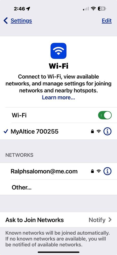

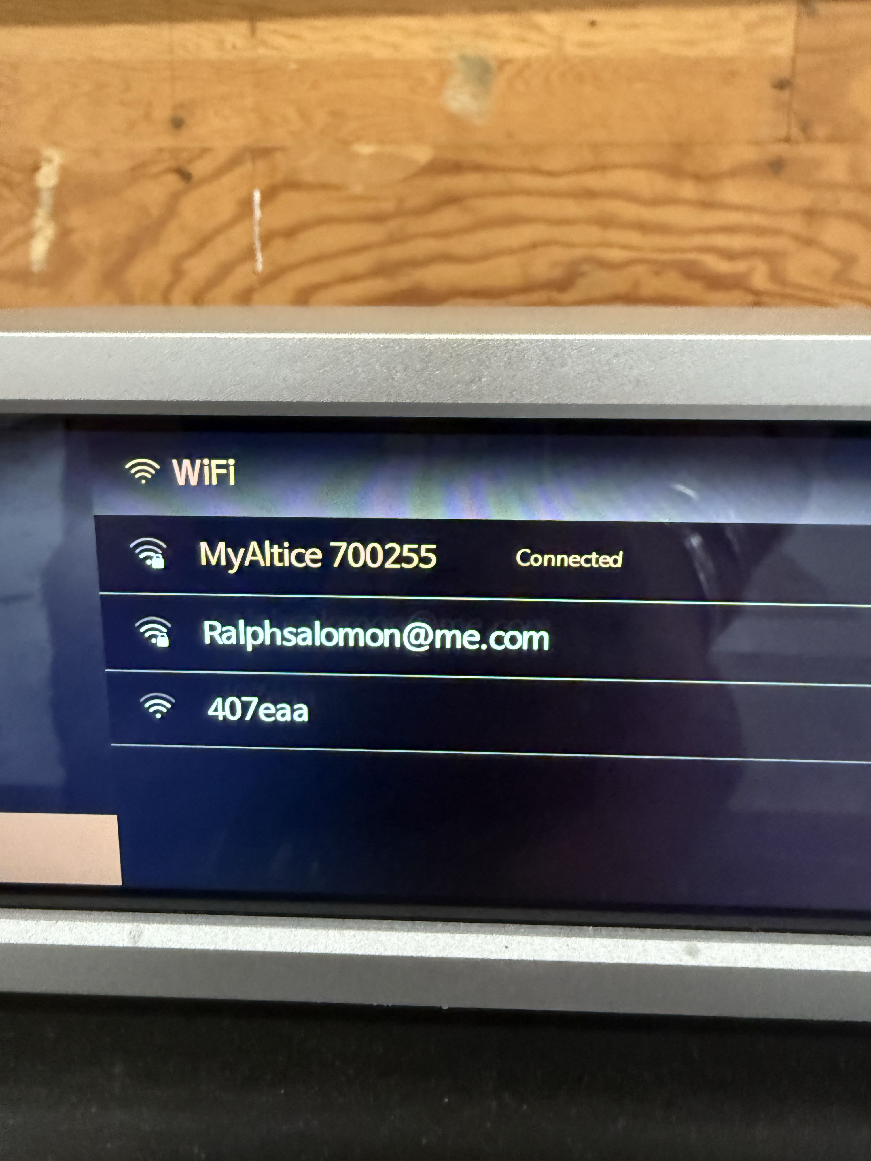

Please forgive my ignorance with this stuff. On the label of the router the SSID is as shown in the attached photo of the RS250. MyAltice… You will see that my phone is connected to the same SSID in the second photo. Why then can’t I connect with the app?
Sorry - one more image
Thank you for your confirmation.
After connecting to your home Wi-Fi, please provide the IP address of the connected iPhone and the IP address of the Rose device.
Also, Please click on “IP search” on the left and manually enter the Rose IP to confirm.
iPhone IP address: 192.168.4.108
Rose IP address: 192.168.1.103

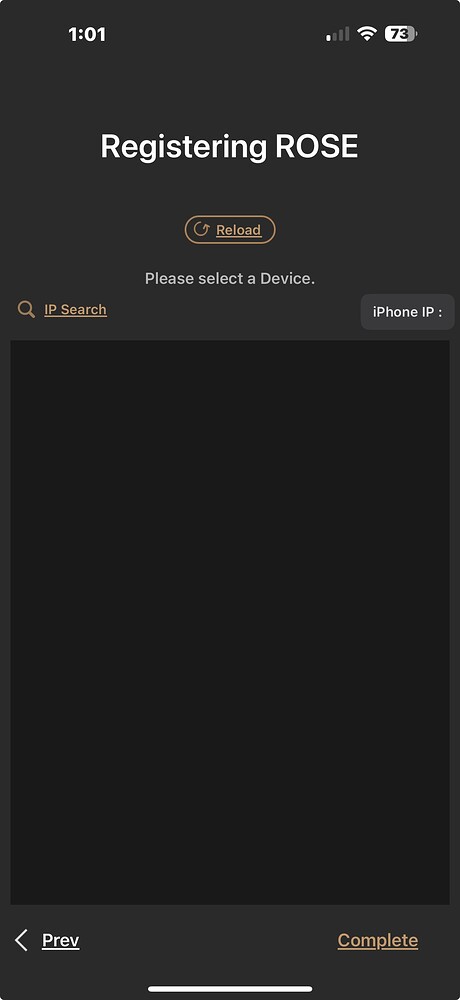

IP Search: 192.168
Nothing shows up other than the above for IP Search. No device appears for selection.

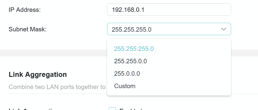

If the connection fails even after entering it directly, you may need to change the net mask to 255.255.255.0 in the router settings.

Netmask is a setting that basically tells your router, and everything connected to it, what is considered to be the same network. Settings look different on every router, but for most home networks it would be 255.255.255.0:
The usual 255.255.255.0 setting means that for two devices to be on the same network, only the last group of digits can be different. I.e. 192.168.1.x is one network that your router is serving up. 192.168.4…108 your iPhone is showing would be a completely different network then, and it won’t find Rose that you said previously had the 192.168.1.103 address. You’d need a 255.255.0.0 (or something very custom) netmask for them to be considered the same network
