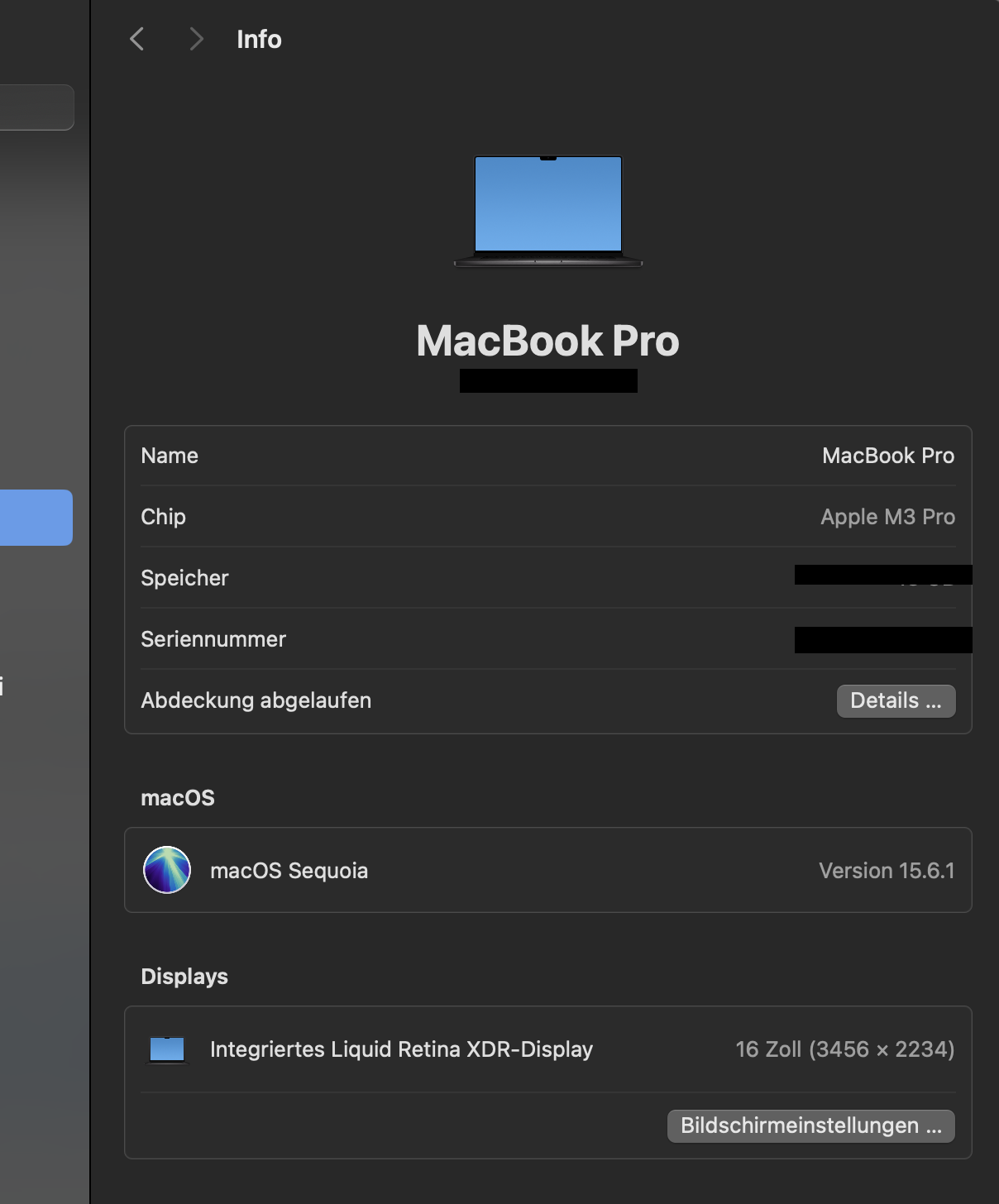

I’m using a MacBook Pro M3pro with the latest firmware (Mac OS Sequoia 15.6.1) and I don’t have any issues with Roon.
