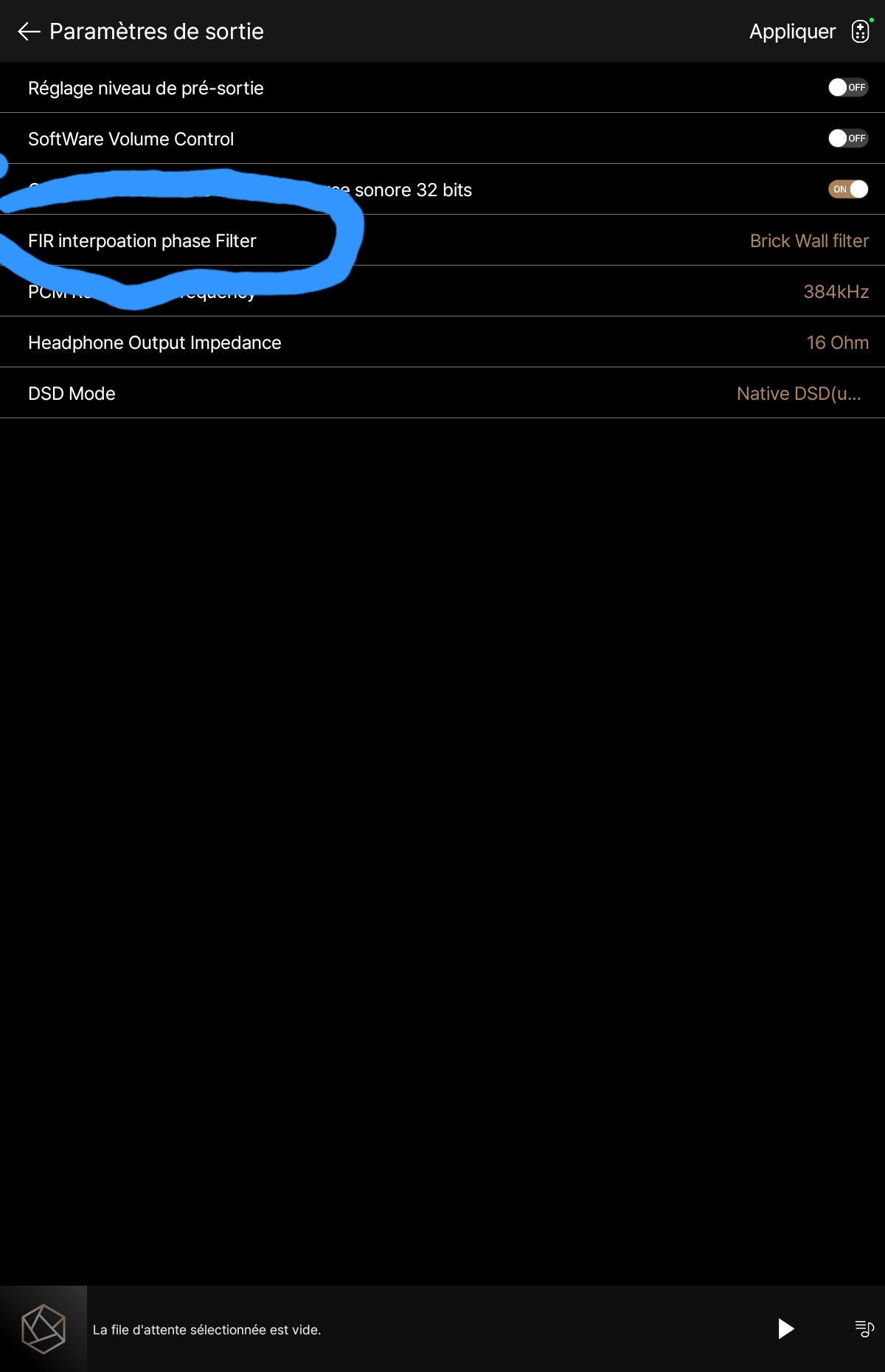

Try maybe to change the phase filter in the output parameters :
O few of the recent updates had wiped out filter settings and a few other things from the setup.
When set back to how it was, 250 sounds exactly like it did before. This being an off the shelf DAC chip in there it would take much more software expertise than anyone at Rose has to make firmware that actually could make the sound “flat and lifeless”.
Sound is built in our brains.
Our ears are only a transmitter from outside to inside.
Psychologically it could well be that your expectations re. the updates sound processing and delivery to the speakers and further were to high.
Please check the FIR settings and adjust them to your liking. Don’t forget to confirm your changes!

After several hours of trying, I decided to perform a software reset and return the system to its default settings. The system kept the latest update version, so there was no need to reinstall any updates.
This solved the issue with the flatness and lifeless sound. I’m not exactly sure what caused the problem, but it seems that something in the corner of the previous settings or filters might have been changed or updated incorrectly.
