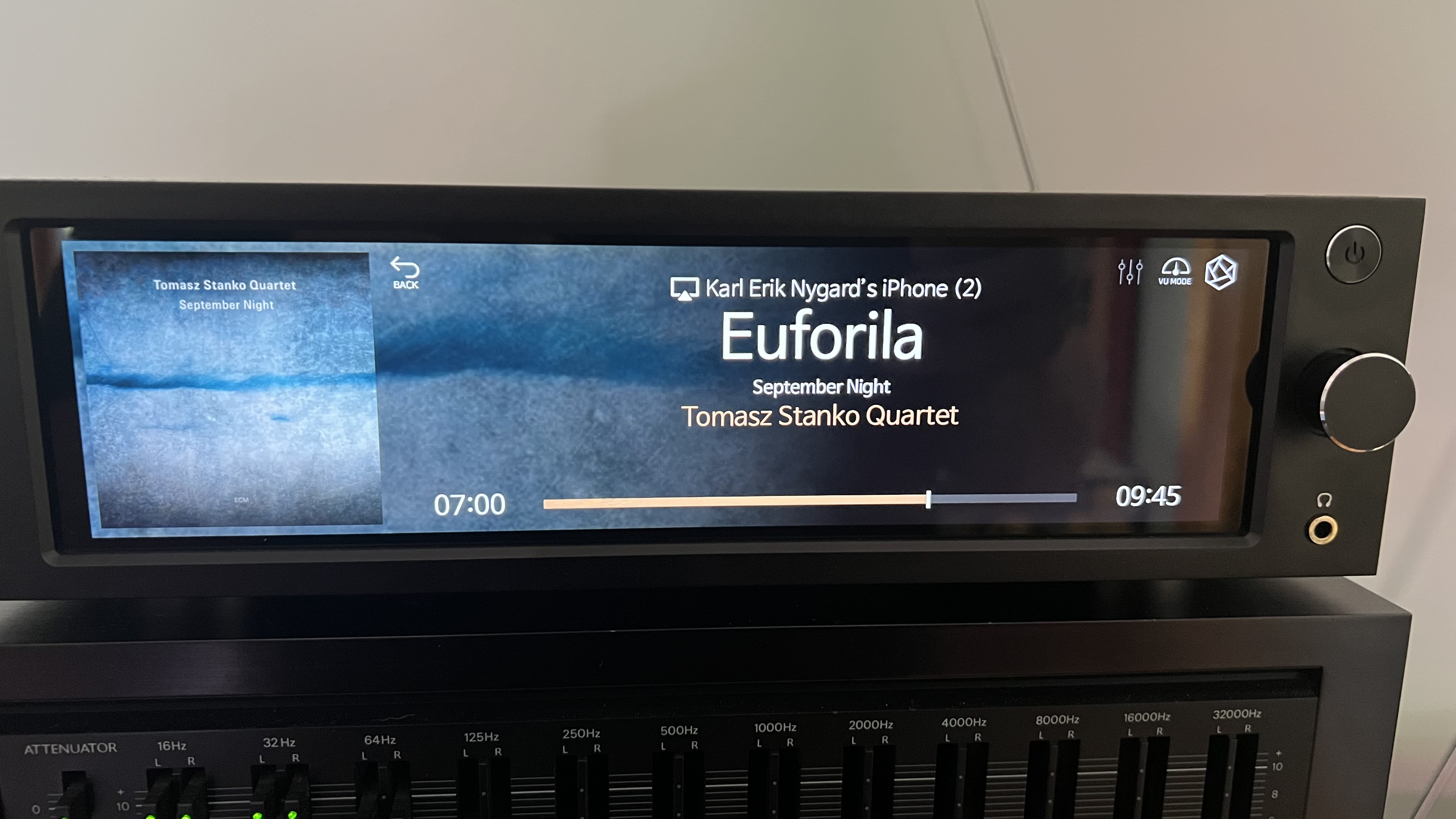

RS 250A occasionally plays half a track and skips in Tidal

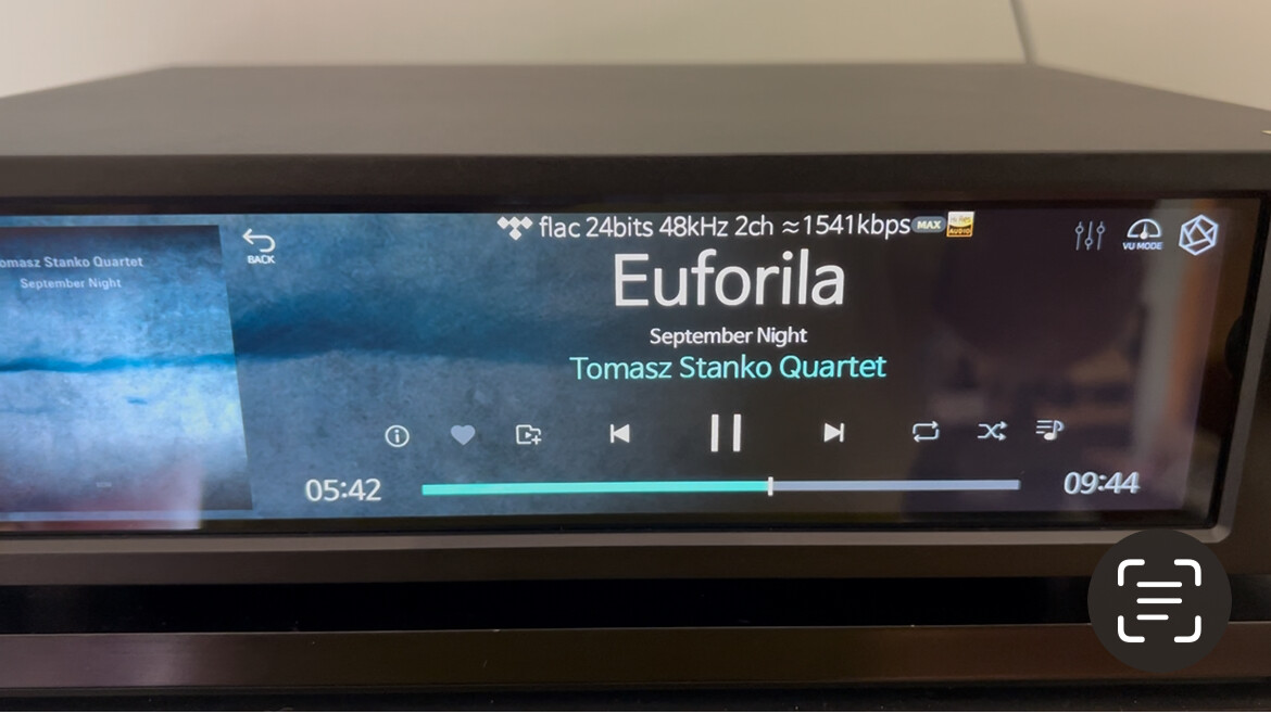

While playing September Night , Euforila by Tomasz Stanko Quartet on Tidal music, through Rose Connect from iPhone, MacBook and on RS250a on Tidal Music, half way through the 9:44 second track skips to the next selection at 5 minutes and 42 seconds. If I play through the RS250a on my iPhone , Tidal , connected using Airplay2 it plays through the entire 9:45 track. Why!!!? Why will it not play the entire 9:44 track? IMG_1005

Full disclosure. I may have jumped the gun. Although I had success in some cases, some Tidal tracks still refuse to play through after clearing cache. I can say Qobuz had this same problem a few months back but plays the same problematic Tidal tracks now without issue. Seems to drift over time but I do believe it’s cache related. When tracks fail the grey buffer bar is overrun by the blue progress bar or the grey buffer bar jumps ahead to the end of the track and within seconds the track is abandoned.

Yes, these are the exact experiences I’m having with the gray bar and blue progress bar.
