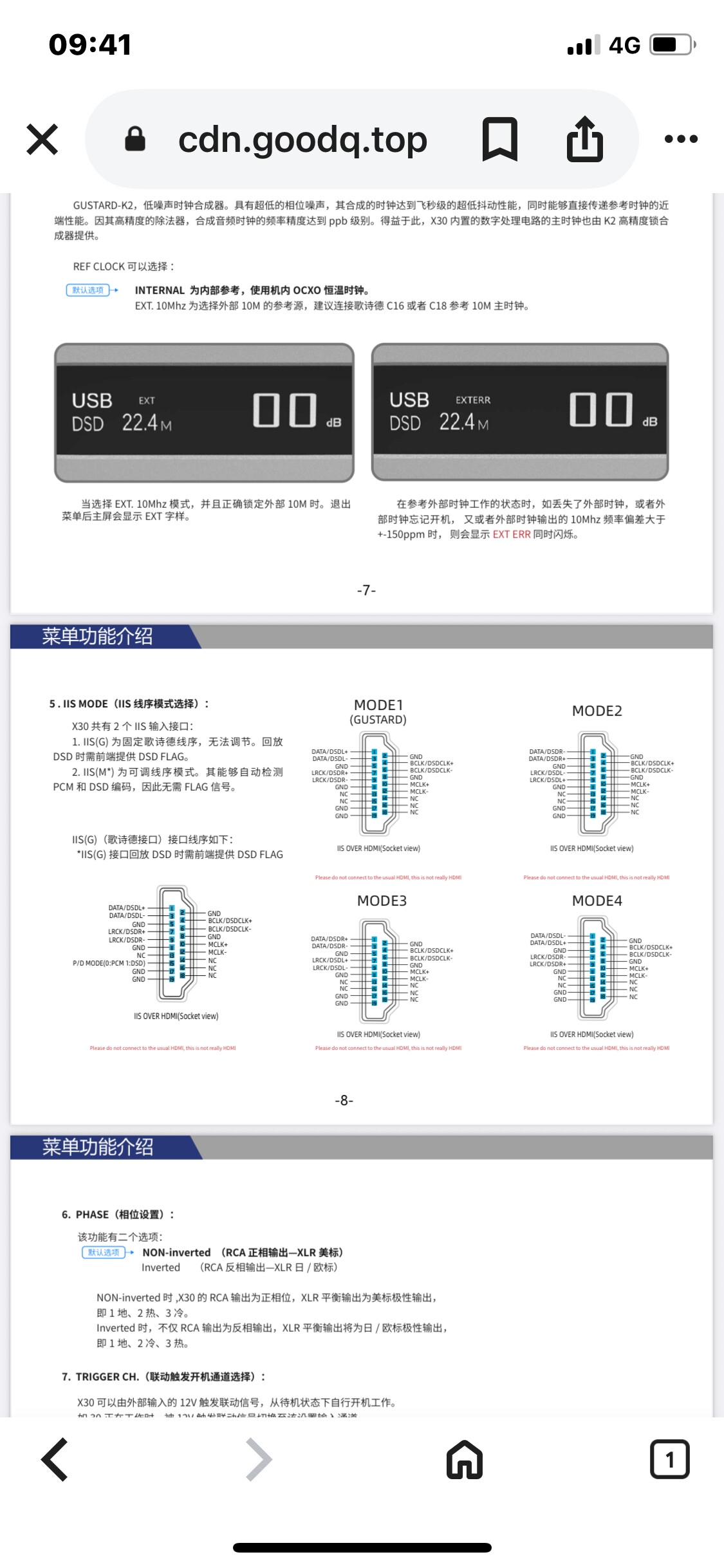

I have HDMI cable connecting the units, I get sound out with configuration A on the 130 and option 1 on the DAC but the channels are reversed. I have tried option B under four options on the DAC but no sound at all from them.

If this is happening with both PCM and DSD music and there is no way in either the source or the DAC to invert channels, then - unless you want to build an inverter for the I2S LRCLK signal line - you are out of luck I’m afraid.
Hi Tony, I have not tried DSD this is the connections on my DAC and the 130 thanks for reply.IMG_6497|461x1000
