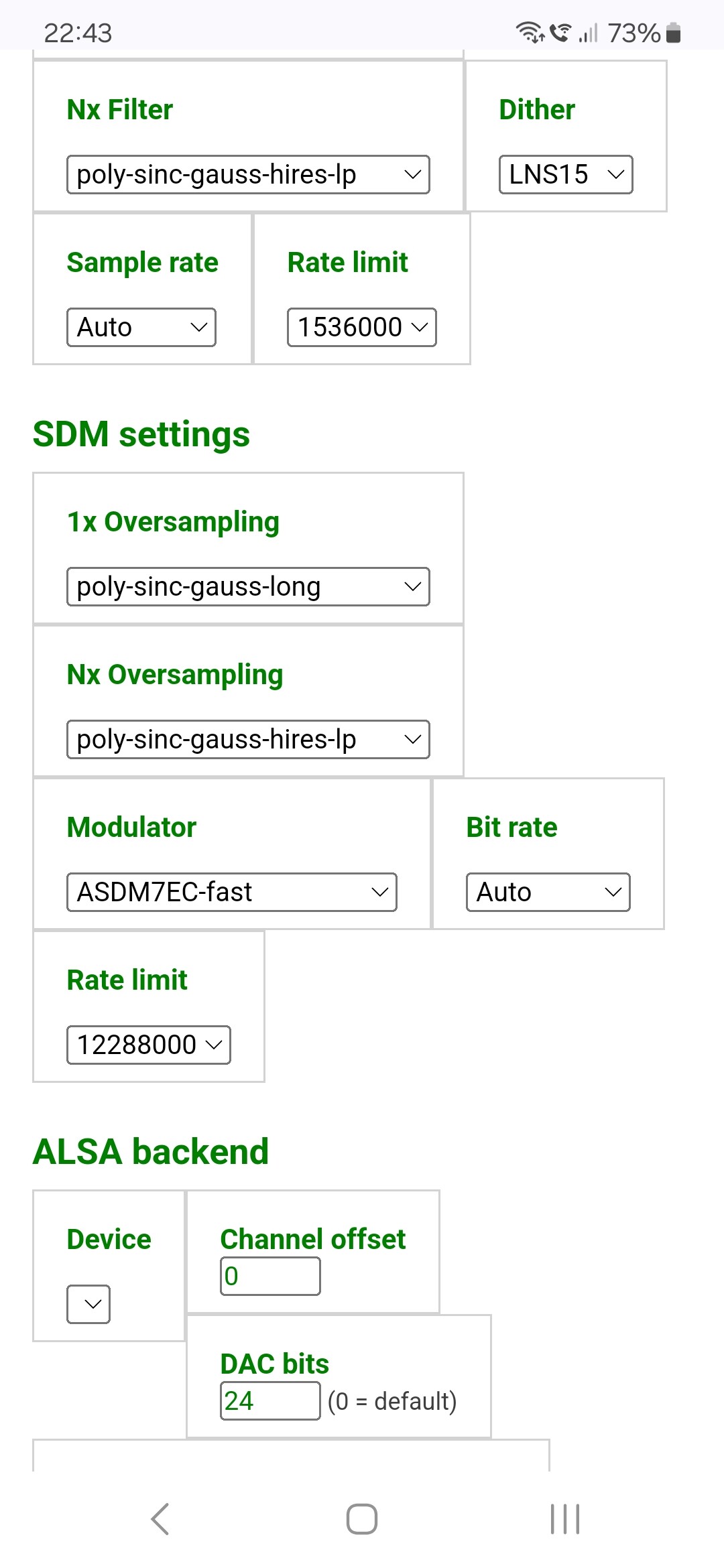

Here my current favorite settings:
Thanks for sharing!
