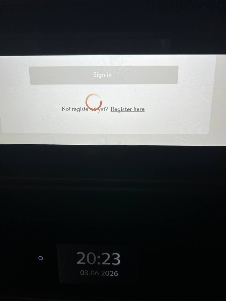

Thank you for your reply. One more question:
After I installed the new firmware (Firmware version: 5.9.09), Qobuz Connect became unavailable. It worked in the original version (before the update). After the update, it stopped working. After trying to enter the login and password, it displays a message (see attached file) and enters an infinite loop (ā€œspins the wheelā€). However, on the Eversolo A-8, which I also have, Qobuz Connect works fine.
What I’ve already tried:
• Factory reset
• Cleared cache
• Cleared data
• Tried connecting via VPN
Nothing helps. There’s no streaming. Qobuz Connect isn’t working. What should I do?
I really hope for your help and advice. Thank you in advance.

Dear ROSEHAN,
I don’t use Google, Apple, or Facebook to log into Qobuz, as my personal and work email aren’t linked to them. I only use the personal email and password from my official subscription Qobuz. When I click on Qobuz on the RS-130 screen, the exact image you provided in your email appears. The ā€œinfinite wheelā€ spins over this image. Attempting to enter the email and password fields is impossible, more for sure the PC-130 allows me to type login and password , but the endless spinning wheel never stops and nothing happens.

Yes. I was able to connect via ROSE Connect. Thank you so much for your help and advice.
Since I experimented a lot to find a solution and changed a lot of things in the setup, I decided to reset the settings to factory defaults and clear the data. And after starting the installation from scratch, I still couldn’t access Qobuz on the ROSE RS130 itself, and again, it was only possible via ROSE Connect. However, this is a bug. Will it be fixed in the new software version announced for June 29, 2026?

It was my experience that Qobuz could only be accessed through RoseConnect. When I tried through the touchscreen it was an endless series of Captcha and the spinning wheel. One learns to adapt though. Yury, use the app, that is what Rose spends its time on working to improve.
@Eleven
If your RS130 is connected to the ROSE Connect app and you are logged into your Qobuz account within the ROSE Connect app, the RS130 should automatically be logged into Qobuz as well.
Are you experiencing different behavior than this?
If so, could you please record a video showing the issue and send it to the email address below?
Once we review the video, we will investigate the issue and work on a fix if necessary.
Sorry Rosehan, I no longer own the 130. I am just stating what I found to be true from the period of ownership. I could not log onto Qobuz using the touchscreen. Without fail, every time. Yes I deleted the Qobuz app and reinstalled it and that solved nothing. But if I logged onto Qobuz using the Connect app I got in without a hitch. Perhaps this ā€œtouchscreenā€ bug has been resolved, perhaps not, but my advice to Yury is to use the app to log on until then.
@Eleven
Logging into Qobuz directly on the RS130 is not supported. This is not a bug.
To use Qobuz on the RS130, please connect the RS130 to the Rose Connect app and log in to your Qobuz account through the Rose Connect app. Once you do that, your Qobuz account will be synchronized with the RS130 automatically.
Thank you for taking the time to share your experience in such detail. We really appreciate your feedback.
You are welcome. It was my experience that the RS130 did allow you to attempt to logon to Qobuz from the touchscreen, but perhaps this has changed in the intervening several months since I parted with the unit. I will defer to a current owner of an RS130 who listens to Qobuz. Because if the RS130 does allow you to attempt to logon from the touchscreen even though this feature is not supported, that feature needs to be removed and replaced with a message that states that the user must use the app (Rose Connect or Qpbuz Connect) to access his account.
@Eleven
After checking with our software team, we have confirmed that, except for the RS451 and RS151, the browser versions used in our other devices are outdated, so logging in directly on the Rose device is expected to remain difficult going forward.
As a result, we have internally agreed to display a pop-up message that guides users to log in through the Rose Connect app whenever a sign-in is required.
Thank you for sharing your valuable feedback with us. We truly appreciate it.
