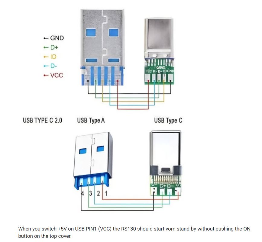

Implementing a 12V trigger input/output on the RS130 isn’t the issue! That feature would have been nice to have, but the device simply doesn’t have it.
There is, however, a workaround involving an external USB signal and a software-side adjustment to the USB power management menu (specifically, the “USB/SSD power activation” setting).
However, surely it wouldn’t be too difficult to have a colleague from R&D perform a quick technical check and provide a qualified response. So, when can you give me a feedback from your development team?

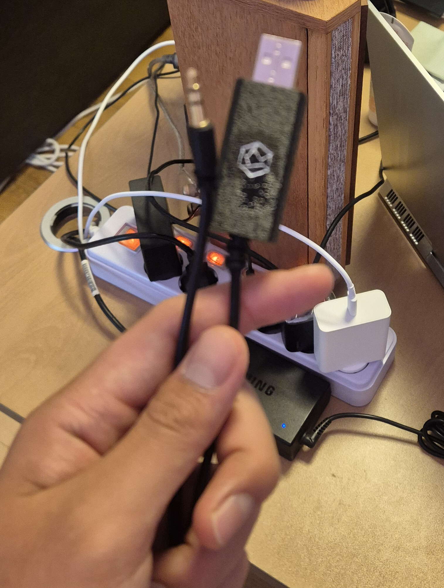

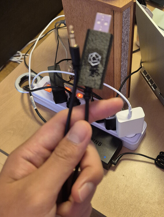

Unfortunately, it is not possible to add 12V trigger input/output support to the RS130 units that have already been released.
However, we have been informed that future products are expected to support 12V trigger input/output functionality.
To help address your request, we have developed a cable similar to the one shown in the image below. This cable is designed to provide functionality comparable to a 12V trigger input/output connection.
