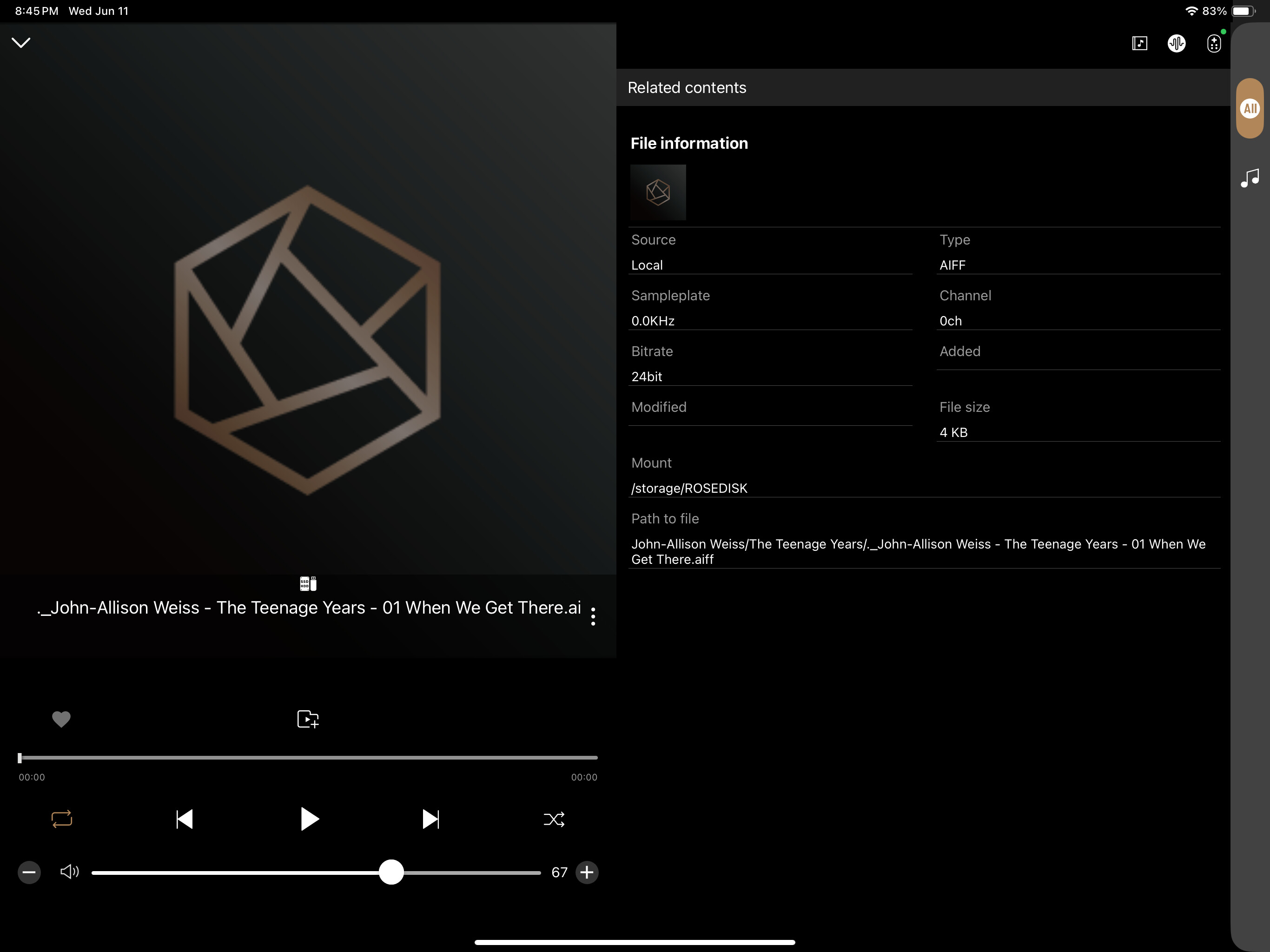

Dear ROSEHAN, Just updated the System Version for my RS130 to “5.9 (Official)”. The update went smoothly but after the system update finished and my RS130 re-booted the “Play All” and “Shuffle” functions will not work when attempting to play an album from the onboard SSD. It will plan an individual song, just won’t launch anything when trying Play All or Shuffle. I re-booted my RS130 a second time and attempted the Play All from the front panel touch screen and from the iPad app. Neither was successful. Please advise any further troubleshooting, my RS130 is running Audio Firmware Version Information XMOS 3151. Thanks!
Here are a few things to check.
Does the “Play All” and “Shuffle” function not work on other streaming apps like Qobuz or Tidal, other than SSD music sources on your RS130?
Is your RoseConnect app also updated to the latest version?
Even after updating to the latest version, the “Play All” and “Shuffle” function still does not work?
Could you please try running the Rose APP for PC again? An update related to this issue has been released, so it should update automatically.

Looks like I responded too quickly. The first few albums the “Play All” function worked, but then others didn’t. My issue is better, but only for some albums. I’ve tested ~ 20 albums and about 50% launch and play all, the other half won’t start. I’ve notice the file information for the non-staring files is strange.
Please see screen shot attached. If I play just the single track it always plays normally and shows the correct file information. I could not find any common characteristics for the albums that Play All worked vs those that didn’t. It seems random. Please advise - Thanks
We have confirmed that this symptom occurs intermittently on our side.
Does this phenomenon occur when you play all as follows?
iOS RoseConnect app–>Music–>Folder–>SSD–>Play All
There is no problem with playing all through the album, not through the folder.
This phenomenon occurs only when playing through the folder.
We will continue to check the issue related to full playback.

Yes - the phenomenon occurs intermittently using the “Music - Folder - SSD - Play All” path. It happens via iOS RoseConnect app AND when using the same access path on the RS130 touch screen.
I also found & confirm that there is no problem when using the “Music - Album - Play” path.

When we did “Music - Folder - SSD - Play All”, we also found that the entire playback did not work intermittently. We will fix the issue and release an update as soon as possible.
