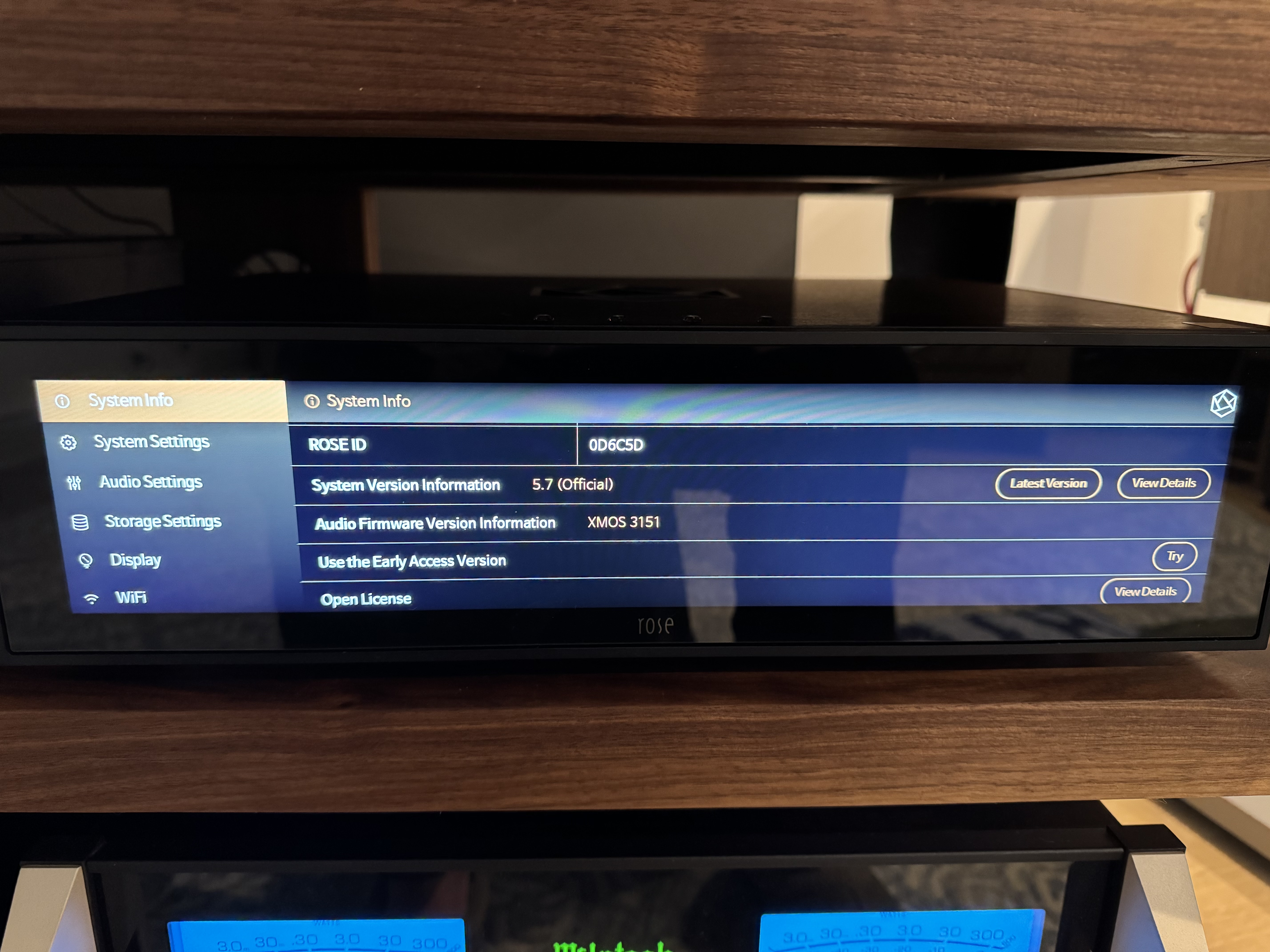

Thank you Brian. I tried your suggested step and still get the same error message (see pix). I also tried the digital coax, did your step, same result.
I confirm the SB130 is on the latest firmware.
What can I try next?
In the pic with coax on it looks like I2S is on at same time. Probably not the issue. Are there any settings inside the coax gear icon that look wrong? It’s a weird error. Does it stream any other way?
Sorry for the stupid question: Do you’ve choosen the correct physical connection (coax out and not word clock in) on your RS130?
