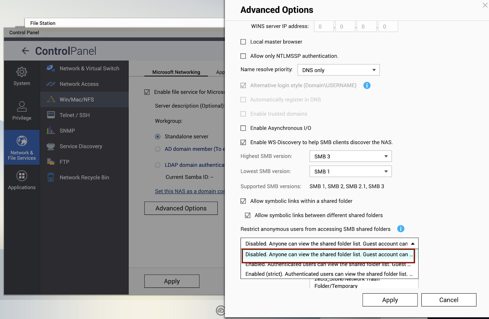

Hi Kiwicolin,
The guest account was enabled but by looking a bit further on why the guest access was not working I found that I had to activate another option on my QNAP TS653D (which was not needed I think on my old TS421) to actually allow root access. Standard option is ‘strict’ to only allow authenticated users…
