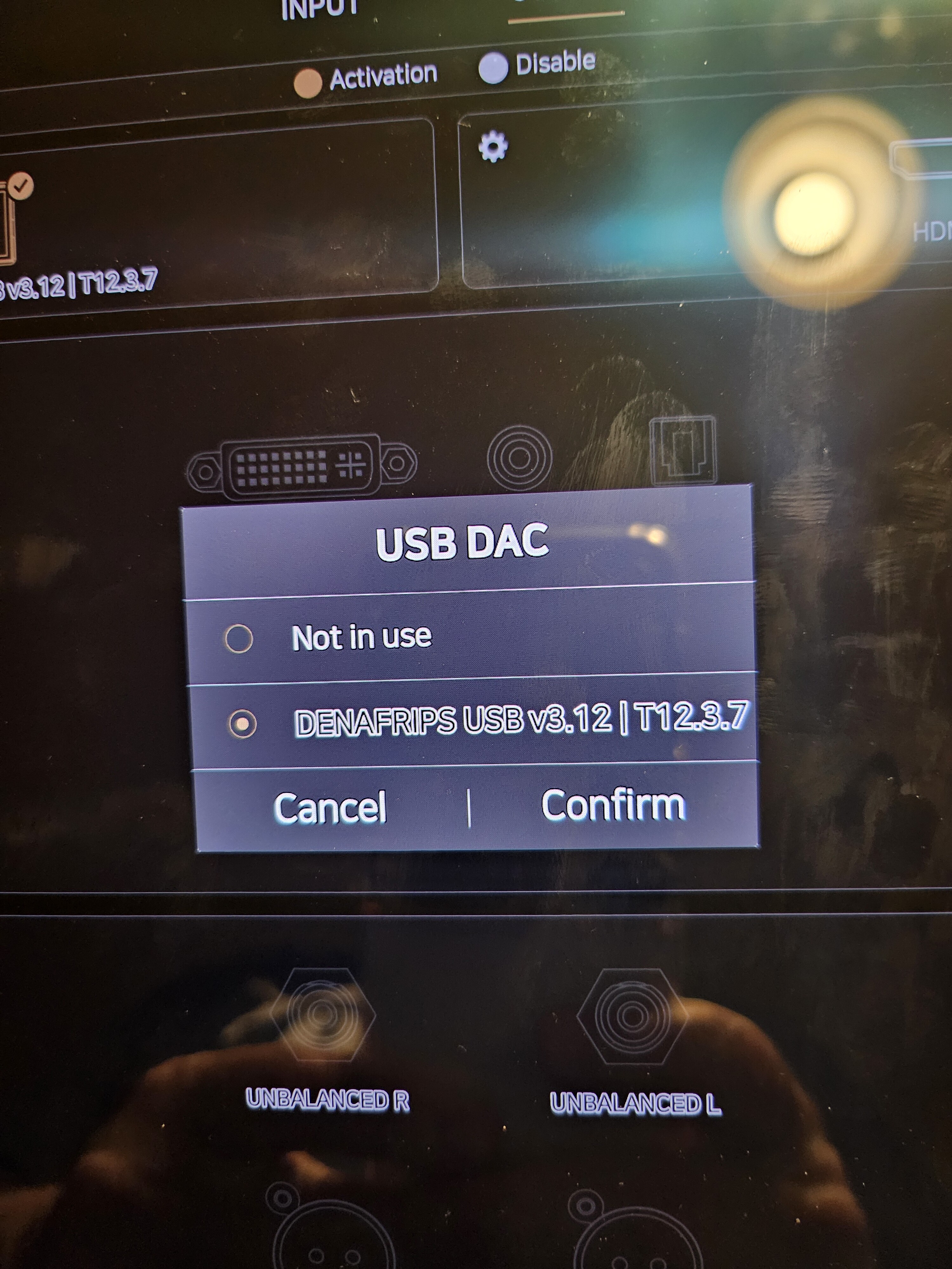

RS150 USB Out does not recognized Denafrips Terminator II
My RS150 can see other external DAC (Chord and Gryphon) but it will not recognized Denafrips.
It will only shows USB Hires Audio. While other streamers will Shows Denefrips.
Music can be played fined, but when selecting between the 2 USB, it will not stay selected.
Show a picture. I have played with Terminator and it worked well.
It plays fine but does not show the name.
Can you show me your photo of what it says in your?

To TS
The Denafrips have an usb input that is not just a standard (programmable) chip so it might turn up Nameless if not recognises as such. It should not impede its function.
That said, if you can, don’t use usb protocols but use the direct chip to chip interface (direct ic to ic = i²s, no file conversion). You only need an HDMI cable to try.
My RS150b recognized the terminator 2 dac on my rig, see pic.
