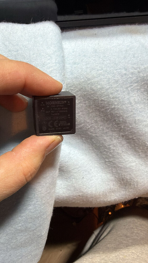

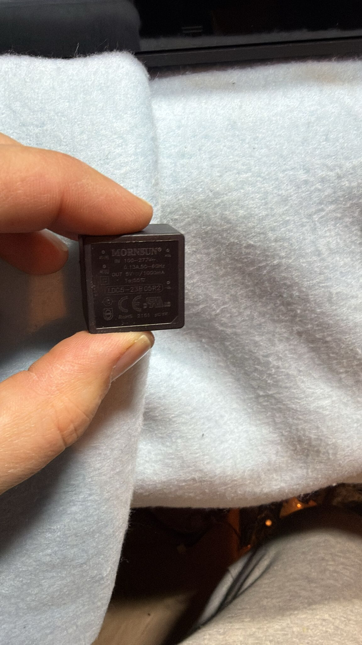

Here is the faulty component !!!
This component has been replaced with a higher quality one (Traco Power). and it works again :wink:
It would very helpful to better understand why the increase in product failures across the entire portfolio. I have asked till I am blue in the face but yet to receive a single acknowledgment let alone steps to remedy. Very concerning.
Given the high price of this device, one could expect a selection of high-quality components. Apparently, this is not the case for all the components, particularly in the power supply with the brand Mornsun.
I am happy for you. How did you determine which component was faulty, DIY or did you send it in? What was the repair cost and how long was it out of service?
A friend who’s an electronics technician did the repair. Since the device wasn’t showing any signs of life, he immediately suspected a power supply issue. The part costs €37. The repair was done in half an hour.

soldering involved. It’s a small converter module → 5 Volts
