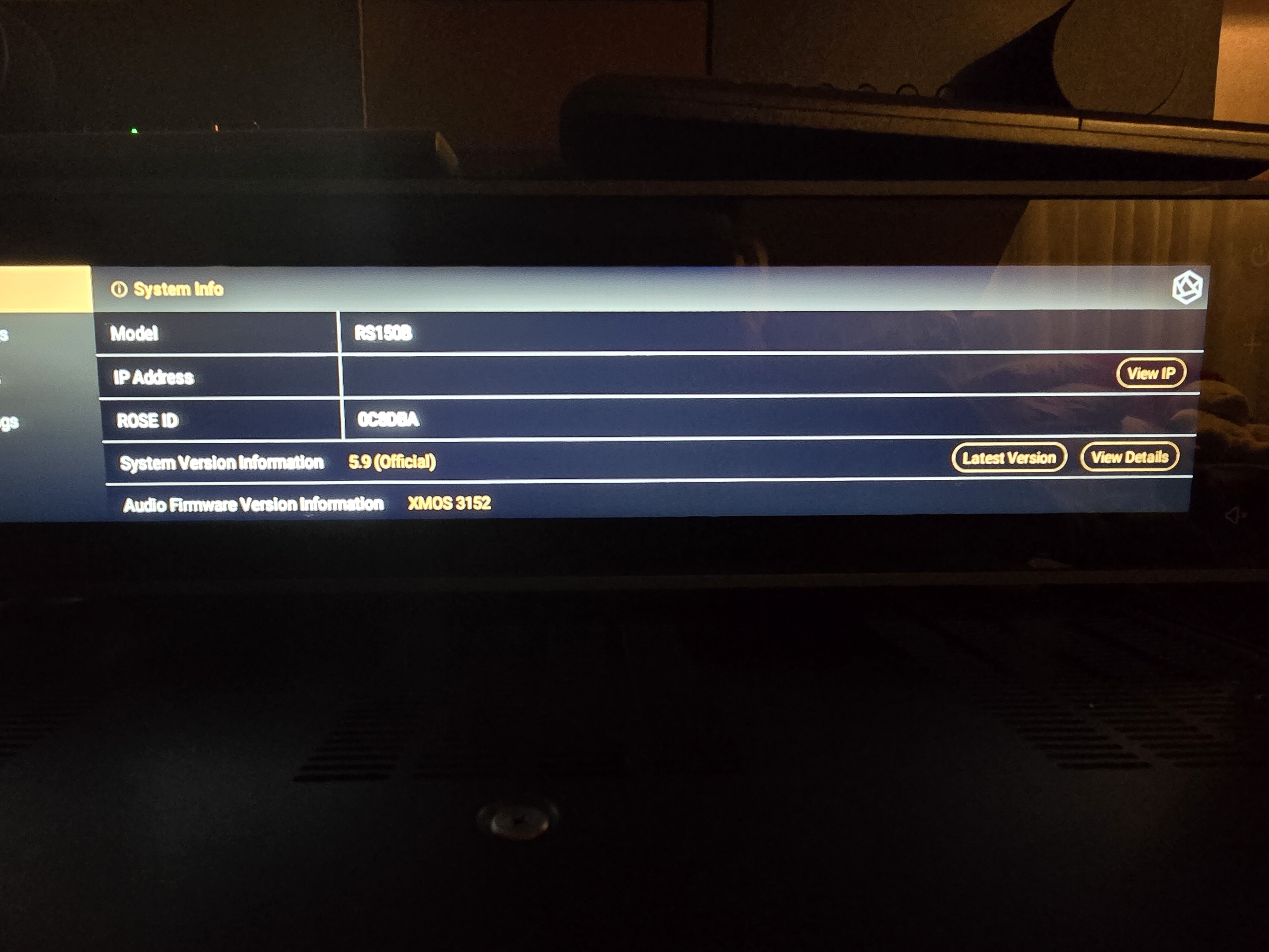

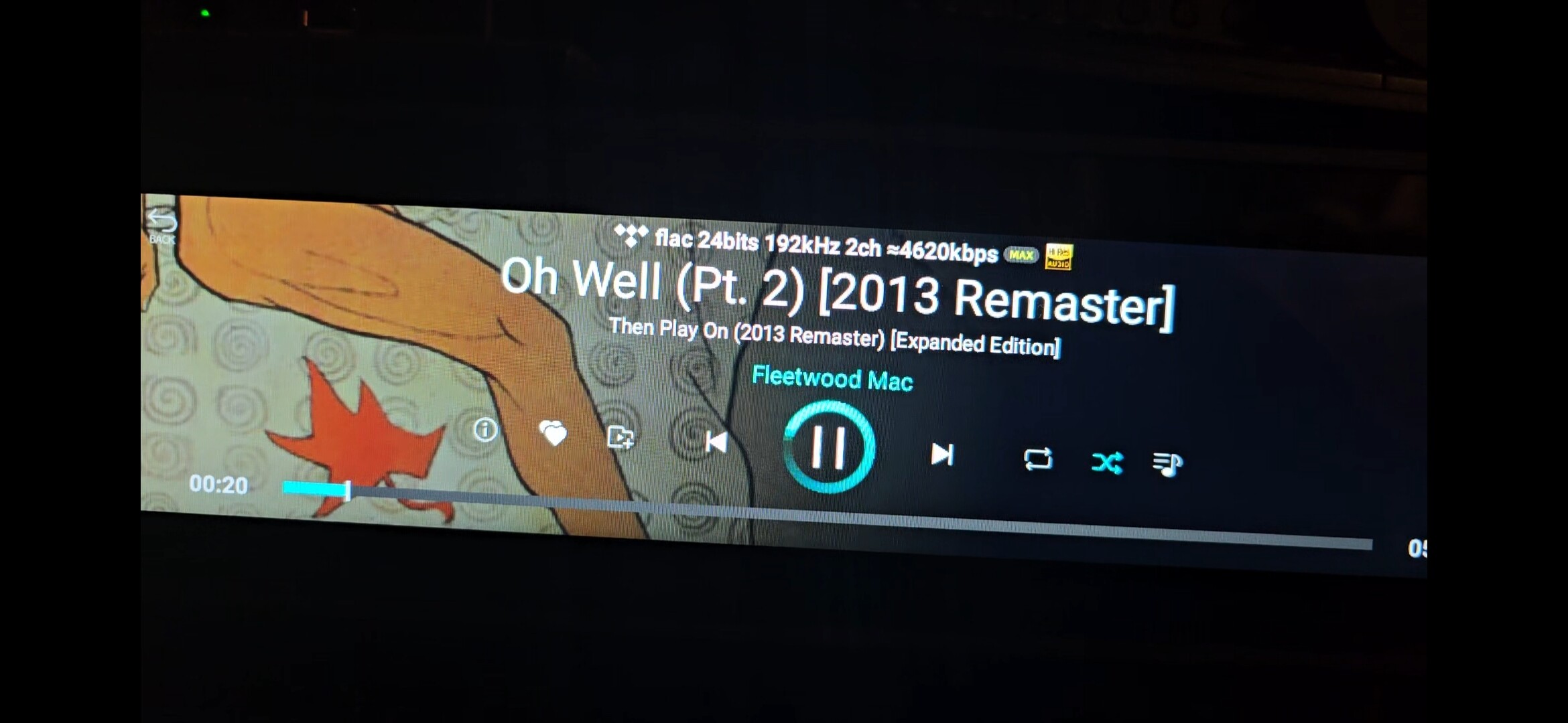

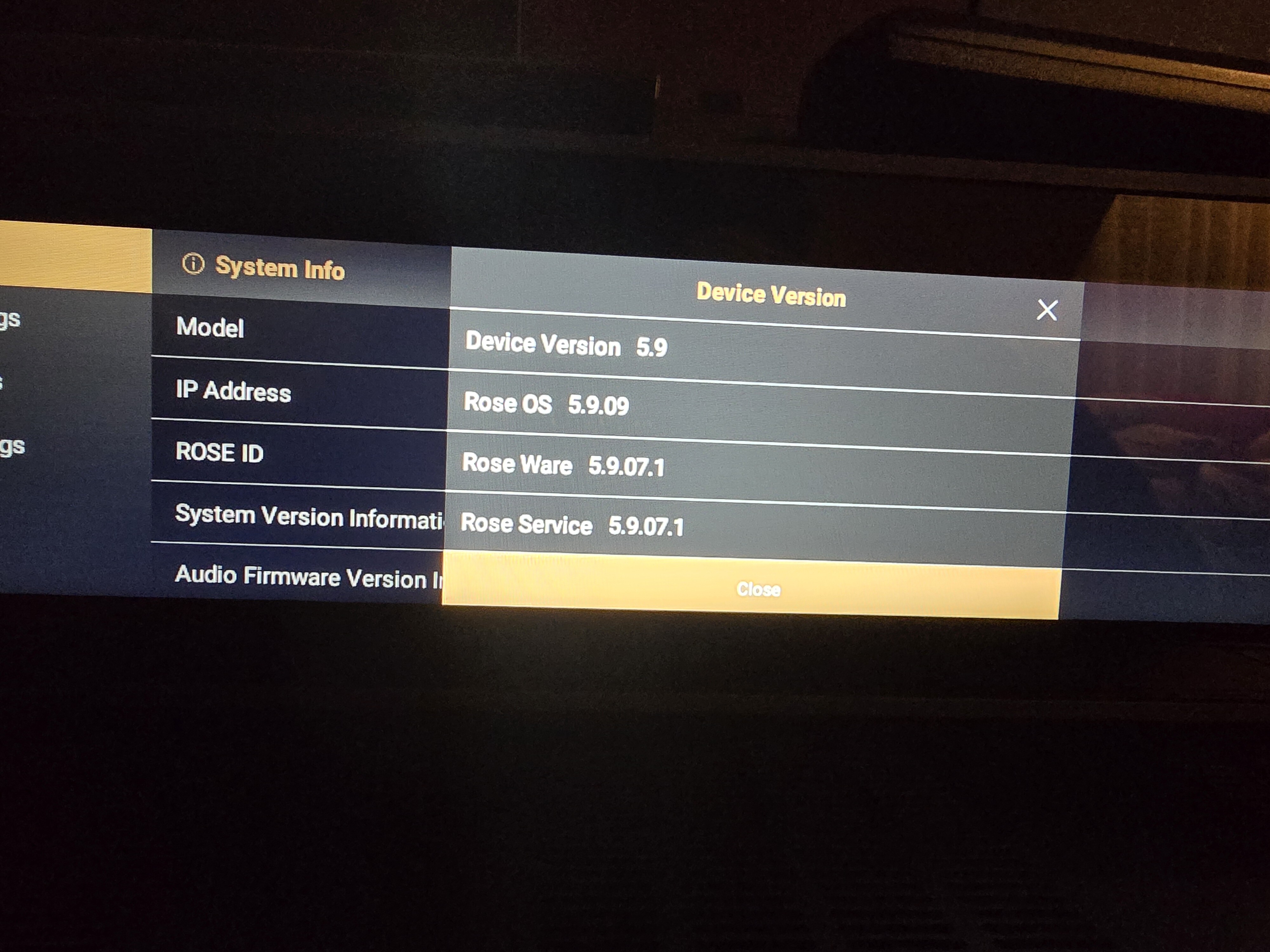

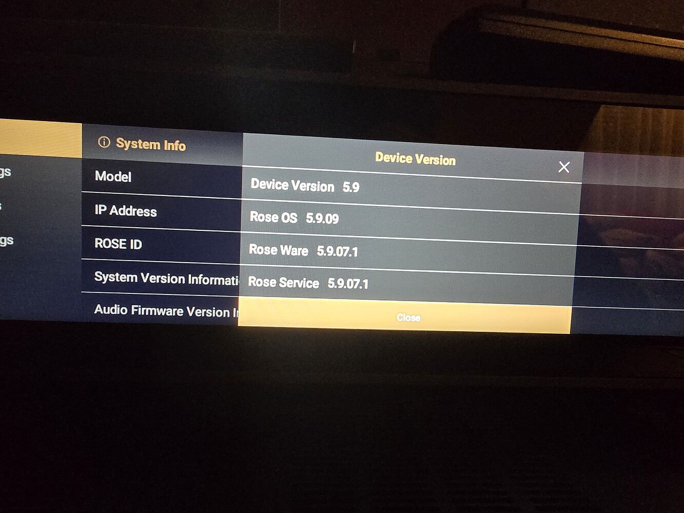

Good morning! After removing MQA compression from Tidal and introducing FALC Masters files, my RS150B can no longer be used. The attached video shows it having a buffering problem. It simply isn’t buffering enough data. Access is through a 5G switch with a throughput of 100 Mbps. It works flawlessly on the same EverSolo DMP-A10, and in the four months since purchase, I’ve never had a playback interruption issue on the same 5G switch. I paid $6,100 for the RS150B four years ago, and it turned out to be a complete failure. Now I paid $3,700 for the DMP-A10, and there are no problems. There’s Tidal Connect and Spotify Connect. But I can’t even launch Spotify on the Rose RS150B. I don’t understand your production policy. Attached are photos and a video. Regards.

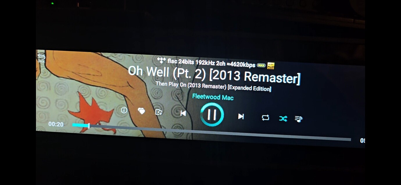

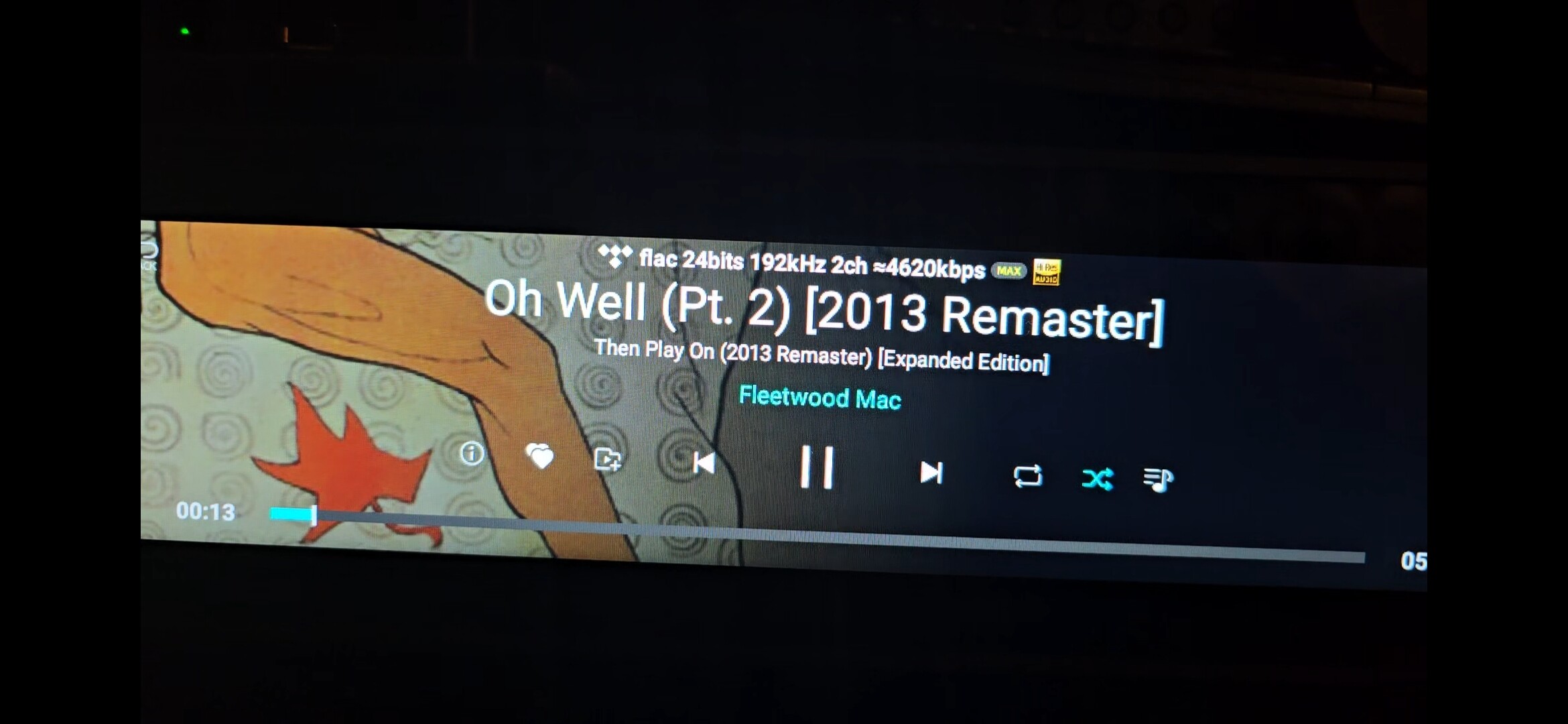

This is what it looks like, every now and then the processing stops and downloads data, and so on and so forth.
