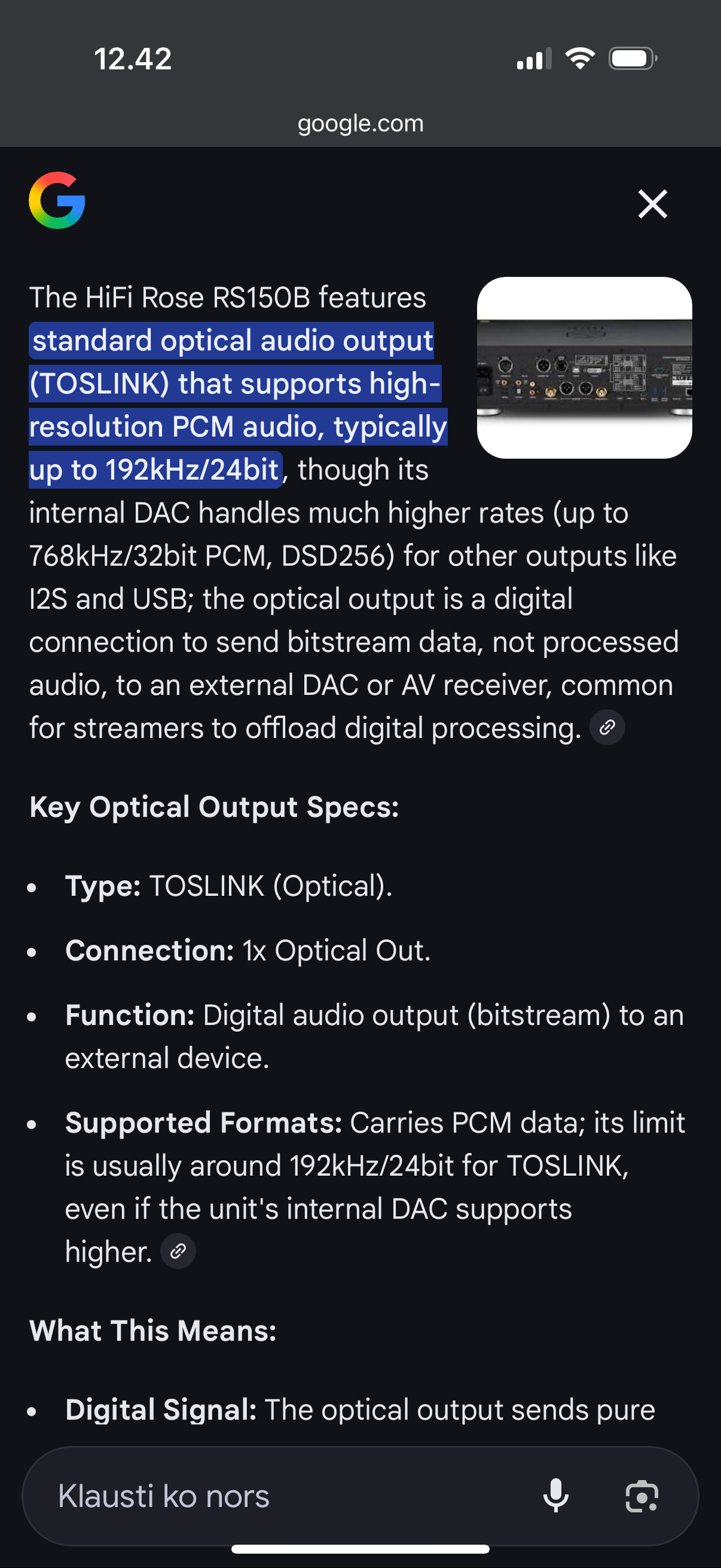

But on google says different😁.
You really should not trust “AI” summaries of anything.

I understand that you shouldn’t blindly trust DI. But the manual simply doesn’t describe it clearly. I use a Chord Hugo TT external dac and it works great with other streamers via optical connection. I don’t like USB sound, and I haven’t tried coax yet🤣.
