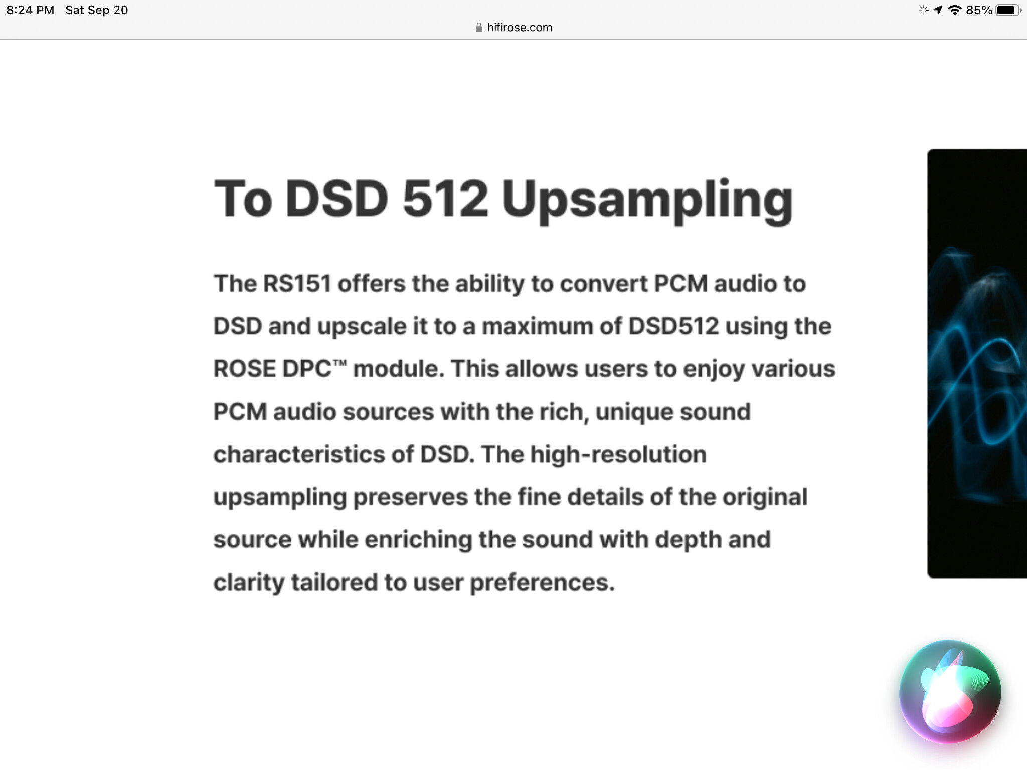

It is documented by Hifi Rose

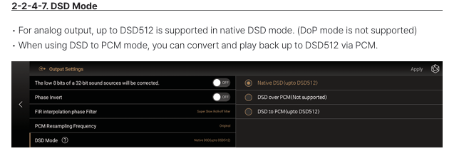

If I follow this instruction I get 3 similar options to those shown. They are:
Native DSD
DSD over PCM
DSD to PCM
Surely I am looking for PCM to DSD?
Ralph, I am guessing here. I have a RS130 not a 151. The RS130 does not have a DAC and no analog outputs. I think The 151 does not have the PCM to DSD (DoP) feature when you use its DAC and analog outputs. However if you use the digital outputs to send the signal to an external DAC that supports DSD the 151 should do PCM to DSD. Tap the gear on one of the digital outputs like coax and see if the option appears. See page 52 of your manual.

  1. The RS151 does not natively provide an internal PCM → DSD upsampling function.
    In other words, the “PCM to DSD (DoP)” option generally does not appear in the RS151’s OS/firmware menus.
  2. Settings such as Native DSD / DoP / DSD to PCM may only appear in certain digital output modes.
    As mentioned in the post, if you see these three options by tapping the gear icon in the output settings, this is most likely referring to the digital output configuration.
  3. Manuals and documentation
    While some RS151 manuals or official documents mention the “PCM → DSD conversion (upsampling)” function, its availability may vary depending on the actual firmware version or hardware configuration of the model.
