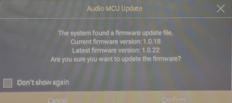

Hi, when I turn on my RS151 I keep getting this message every time.
AudioMCUUpdate
I press Confirm, the unit restarts, but the same message shows up again.
How can I properly update the firmware?

@thomeh
We have confirmed that there are users in Korea experiencing the same issue as you.
We attempted to fix the problem remotely, but it could not be resolved, so we plan to collect the user’s RS151 unit in Korea for further inspection.
Until the issue is fully resolved, please check “Don’t show again” to prevent the popup from appearing.

@Shepscape
Unfortunately, this issue cannot currently be resolved directly by the user.
At this time, if the issue occurs, the only available solution is for the user to send the product to their dealer, and then the dealer must completely wipe and reinstall the firmware.
If you could please contact us at the email address below with details regarding this issue, along with answers to the questions below, I will forward the case to the distributor in your country.
khj94@citech.kr
  1. On your RS151, is the current MCU version displayed as Ver 1.0.18?
  2. Which country are you currently living in, and which dealer/store did you purchase the RS151 from?

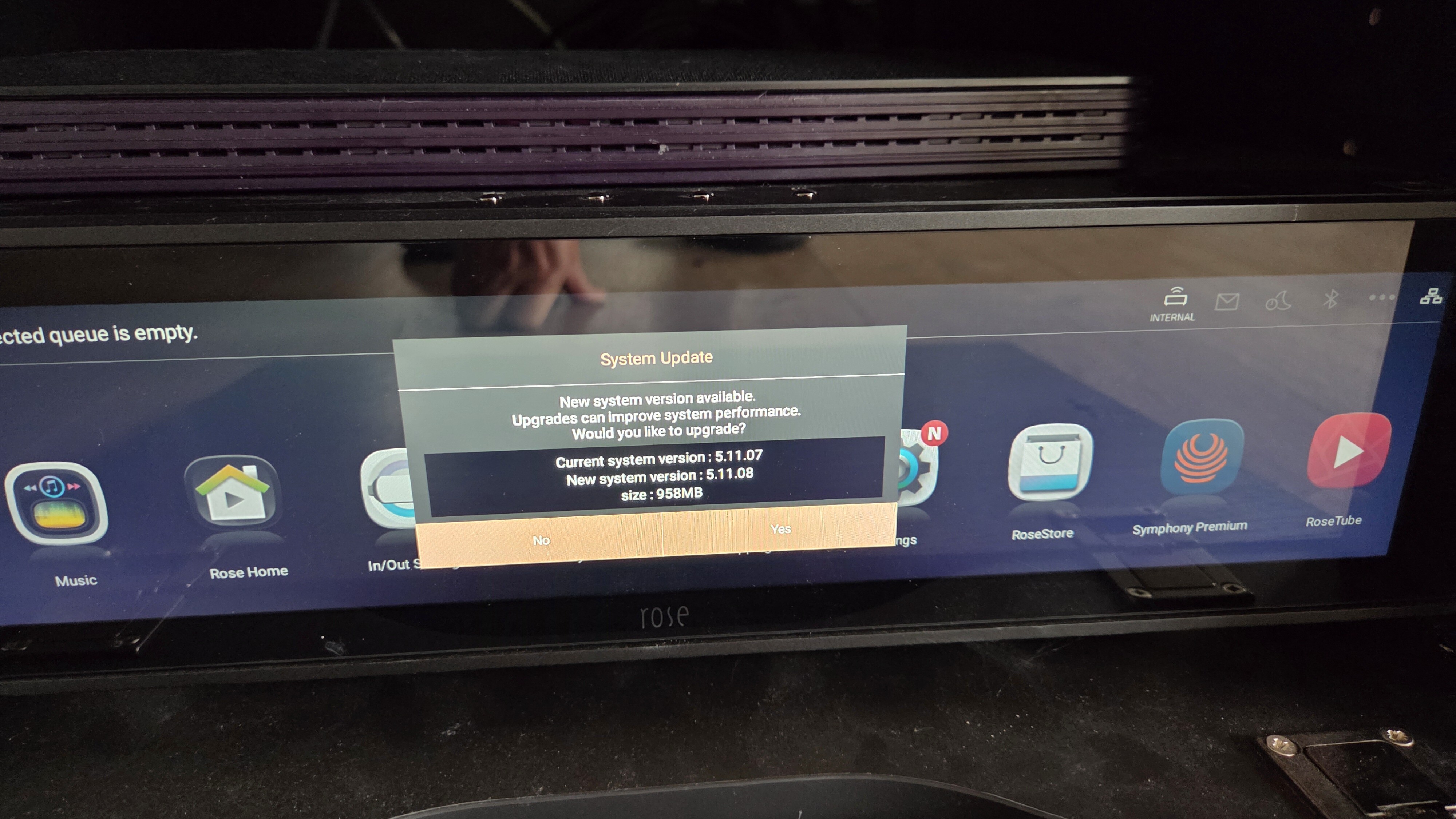

I have the same issue. Back to the dealer is only option?
@Ihunter
Please contact the HiFi ROSE distributor in the country where you purchased your ROSE device.
Alternatively, please email us at the address below with details of the issue and answers to the following questions. We will review the information and forward your case to the appropriate distributor in your country.
Email: khj94@citech.kr
  1. Is the current MCU version on your RS151 displayed as Ver. 1.0.18?
  2. Which country are you currently living in, and which dealer or store did you purchase your RS151 from?
The issue is system update. Current version is 5.9.8, new system update is 5.11.03.
When I click install, it just reboots and shows the same System update again.
Live in The Netherlands. Purchased at Freakuence hifi in Woerden.
@Ihunter
If your device is running a significantly older software version, issues like this may occasionally occur when attempting to update directly to the latest version.
Please send an email to the address below and provide the model name of your HiFi ROSE device. In the email, please request the latest software update file.
We will provide you with the latest update file along with instructions on how to perform the update manually.
This is kind of weird.
Your update script should do a check and then either do a cumulative update or perform a check on the current running version… then upgrade from that version to the next version… reboot and then do the same check so that it will progressively update until at the latest.
Note: if you do a cumulative update, then the update file would be larger, but you would only update the packages as needed.
HTH
It looks like it updated now. Today even a new update to 5.11.
@Ihunter
Version 5.11.08 is the latest official firmware version. Please go to the update menu and click “Update” to install the latest firmware on your device.
