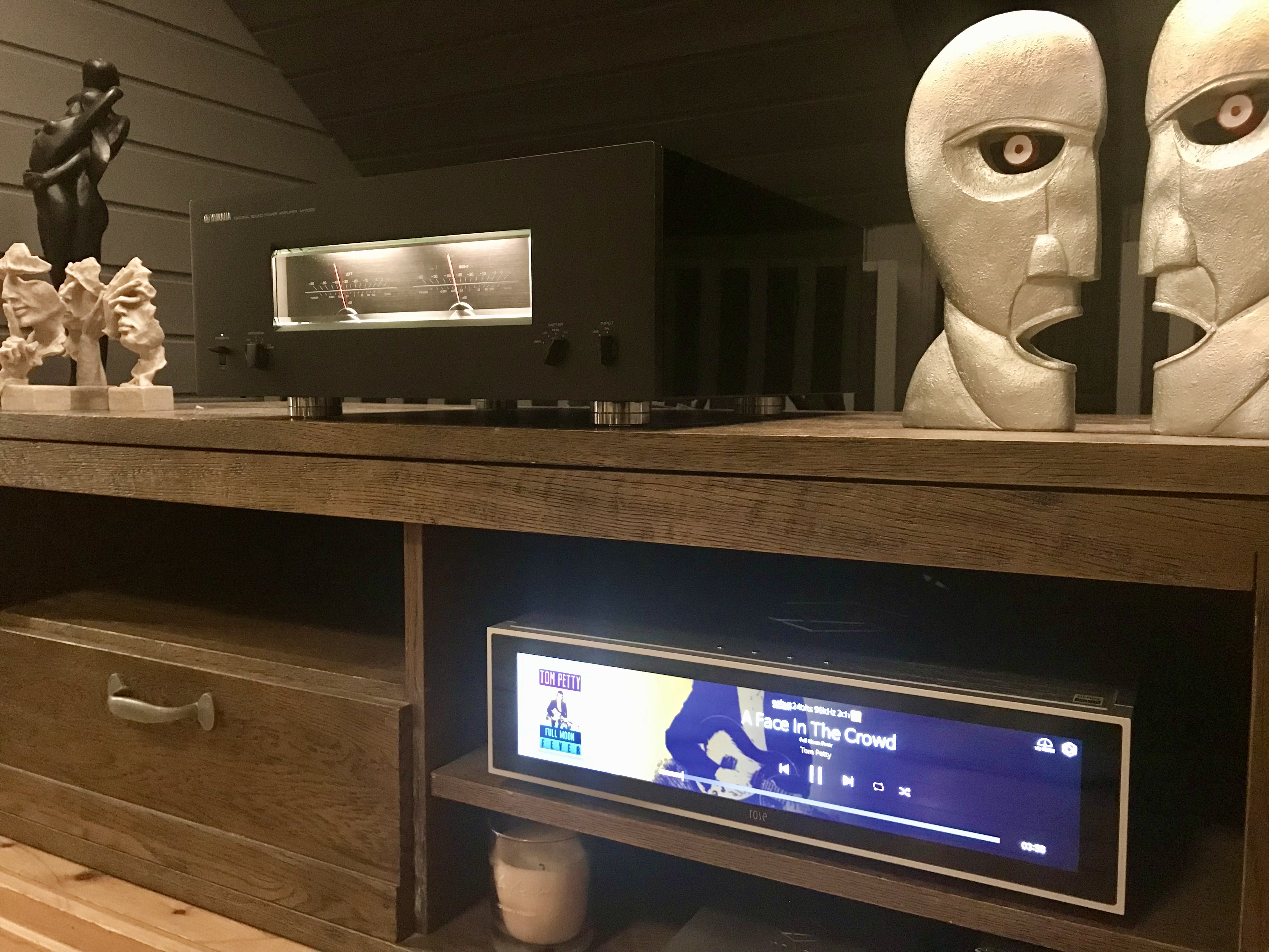

I use RS-151 and Yamaha M-5000 and this sound’s great. I don’t feel i need a preamp at all. The preamp in RS-151 is good, but use XLR if you can.
