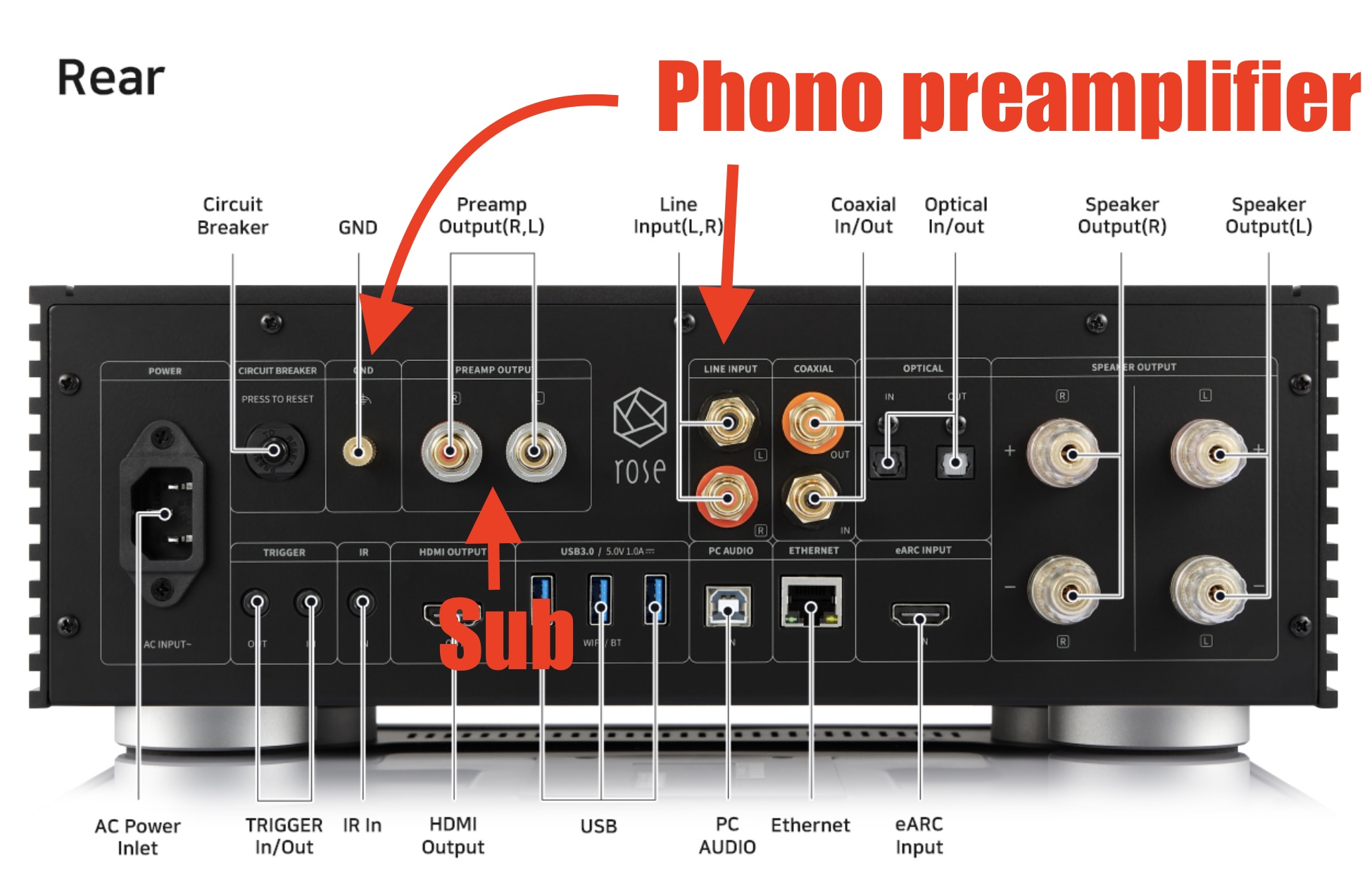

It looks like the 520 has one set of line level inputs. If you want to use those for your turntable, there are many affordable good quality phono preamps on the market.

@rayray57
I’m sorry, but now I’m confused.
Your phono uses the RCA line in …
Your sub uses RCA line out so you can use the phono and then 1 or 2 subs.
Or go w a REL and skip the RCAs.
You have one pair of RCA in and one pair of RCA out.

As I mentioned above, you will need a phono preamp to boost the signal to line level. There are lots out there. The connection is as follows: Phono → Phono Preamp → RS 520 line level input.
Look up brands such as Pro-Ject, Rega, Schiit and MoFi among others and you will find plenty. The only limiting factor is your budget.

Ok, Just getting around to setting up the RS-520 with the R-11’s and the sub using the pre-amp out on the right channel. It is a single line. Now I need to configure the system to ensure it has the right settings to play using the speakers and the coax out. The problem is when I select them both, I get a message saying cannot control volume with current settings. Not sure what settings it should be set to at this point. Any help on this would be appreciated. I do not want to send too much volume to the sub and speakers so what should I be doing here?
I think I figure it out. I had both the preamp out and the speakers selected but for some reason I had no sound and so I turned it off and back on and deselected the preamp and just left speakers on output and then turned on preamp again and it works now. Weird!
Ray
If you’re going to use the RCA line out… to a single sub, you’re probably going to want to go 2 RCA cables into 1.
The control volume is set when you look at the output panel’s configuration sub panel.
The issue is that you can leave it as line out… so you don’t control it. Or you can turn it on so you can and its software controlled volume. Not much of an issue for subs.
