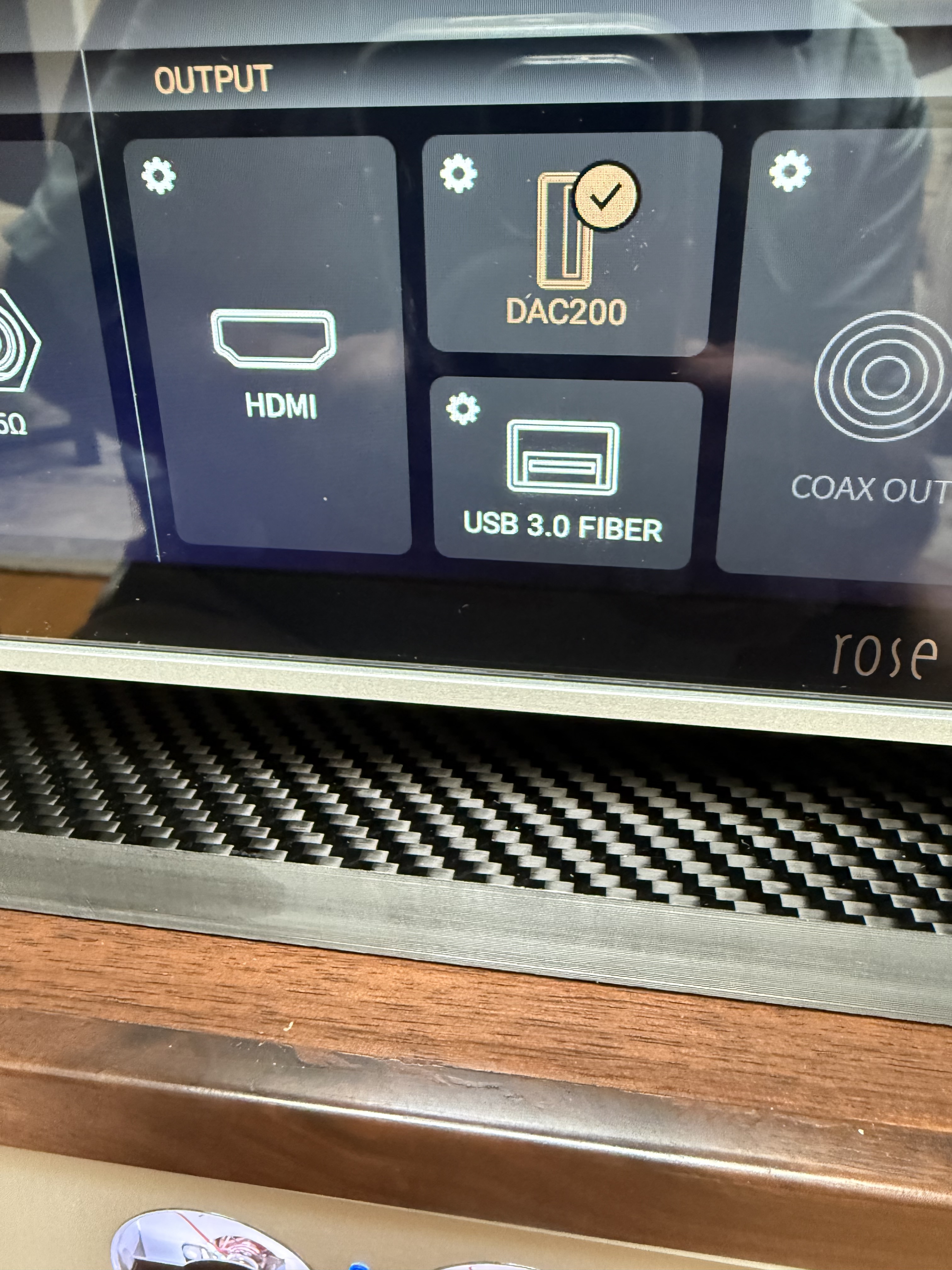

Hi Rosehan,
Well I thought we had a problem, and we do, but it’s a functional problem. When the RS130 and RSA720 are connected via fiber, and the DAC200 is connected to the RSA720 via USB, one would think that through the input/output connection wizard for USB, one would select SFP and let it work to discover the USB dac connection. After all the two Rose devices are only connected via SFP. So I tried that, because before this firmware update that’s what I did, and I would get a failed to find the dac message, but it would show a USB connection, not an SFP connection, in the display, and I would get data. Post update, I get a failed to find message after it worked on the SFP for a few minutes, and no data or showing a USB connection on the Rose display. What works now is ignoring the SFP wizard, initiating the USB connection wizard where it immediately recognizes the DAC 200, and provides data to the dac.
I am attaching an image. So new instructions for the connection to the RSA720 need to go out for folks using fiber between the two Rose devices. Seemingly, you could delete the SFP connection wizard.
Next step is seeing whether a good LPS for the RSA720 will improve the sound from this combo further.
@Jello
In the RS130 input/output settings, the USB 3.0 Fiber option is designed specifically for a direct connection between the RS130 and RD160. Since the RS720 functions as an SFP USB hub, even when using the SFP connection, it essentially acts as a USB hub, and any DACs connected to it will appear under the USB DAC list.
We understand that the current service method may cause some confusion for certain users. Regarding the menu labeling, we will discuss this internally and work on creating a clearer interface that can provide more detailed guidance.
