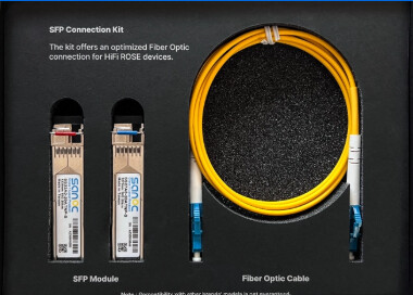

If you require the RSA720 SFP Kit, please send your request along with your shipping address to the email below:

O, no problem, I will contact you back in August. May I ask what is the SFP kit included? Thank you!
@kchong88329
This kit consists of two high-performance SFP modules and a dedicated optical cable, minimizing signal interference and latency to achieve lossless digital transmission.
As a result, it enables clearer and cleaner audio signal delivery, maximizing the overall performance of your audio system.
Thank you for sending me the photo of the updated SFP kit. Please let me know if the kits is aviliable for delivery. May I ask why the SFP kit come with single core single mode modules instead of dual core? I am connecting my rs130 and rsa720 using SFP+ dual core single mode 10G modules (Finisar FTLX1475D3BTL). The sound has improved dramatically.
Modules Finisar lasers are better than modules HiFi Rose lasers, I think, and of higher quality! The result is much faster detection and more transparent sound! :muscle:
