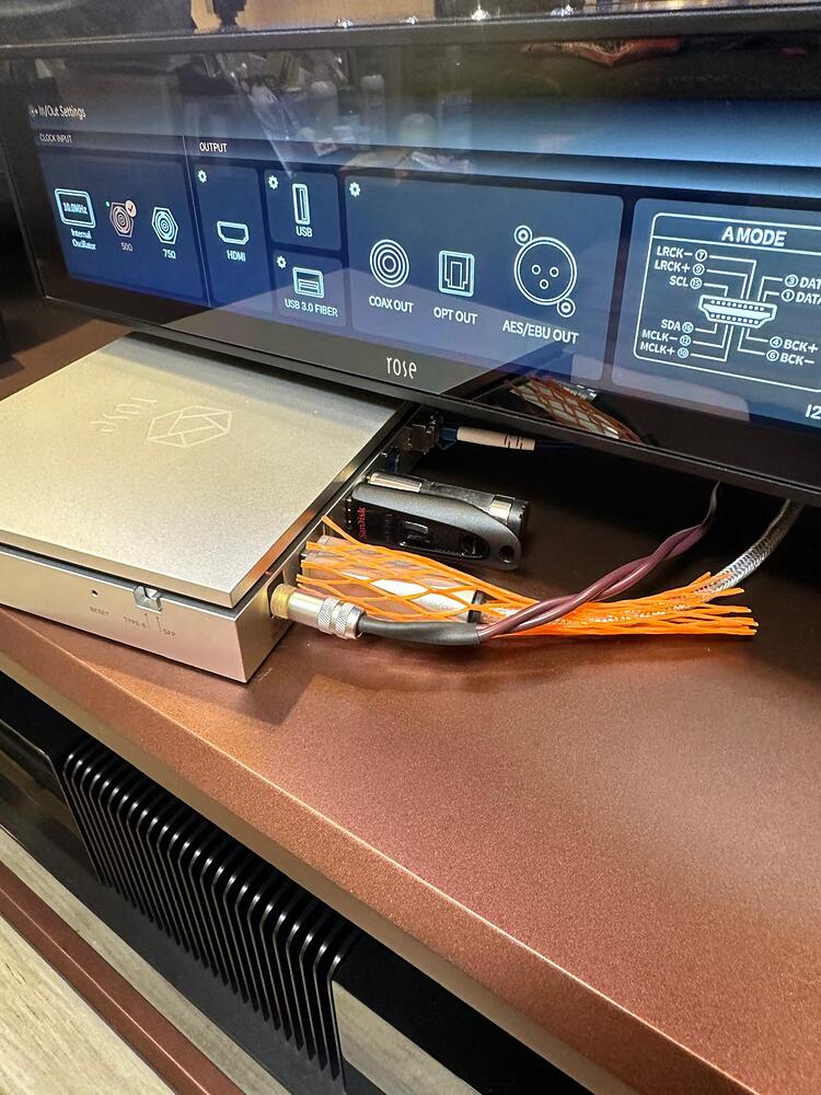

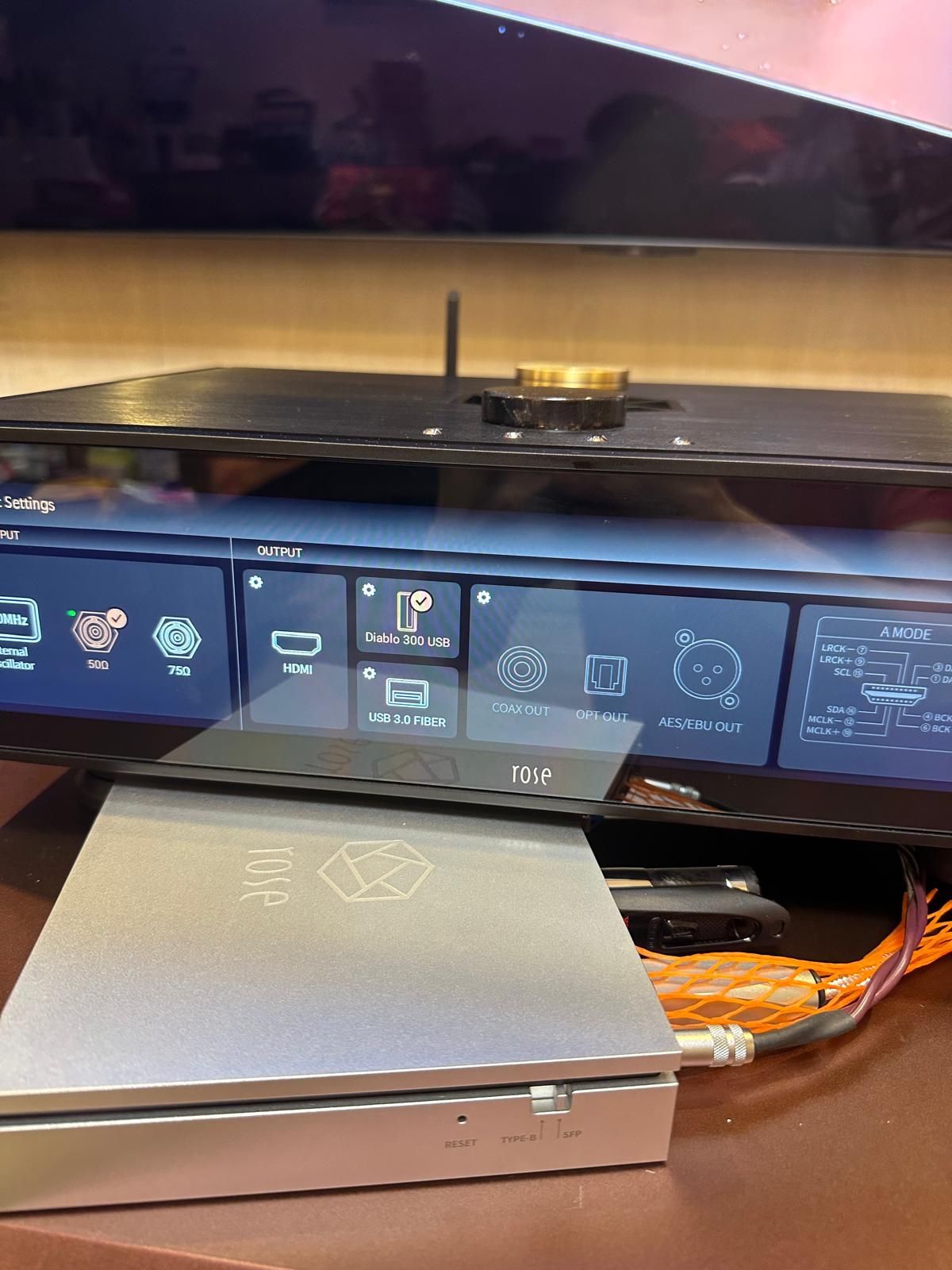

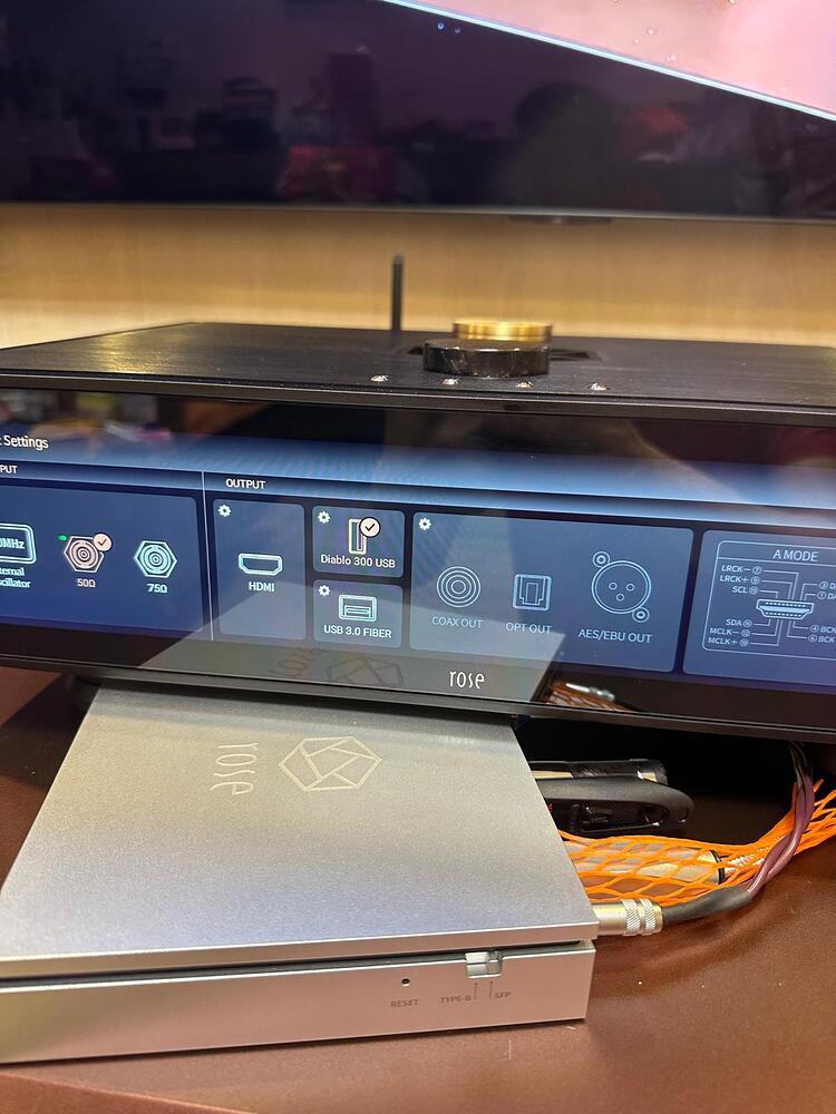

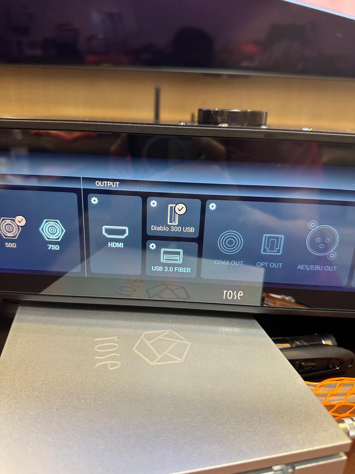

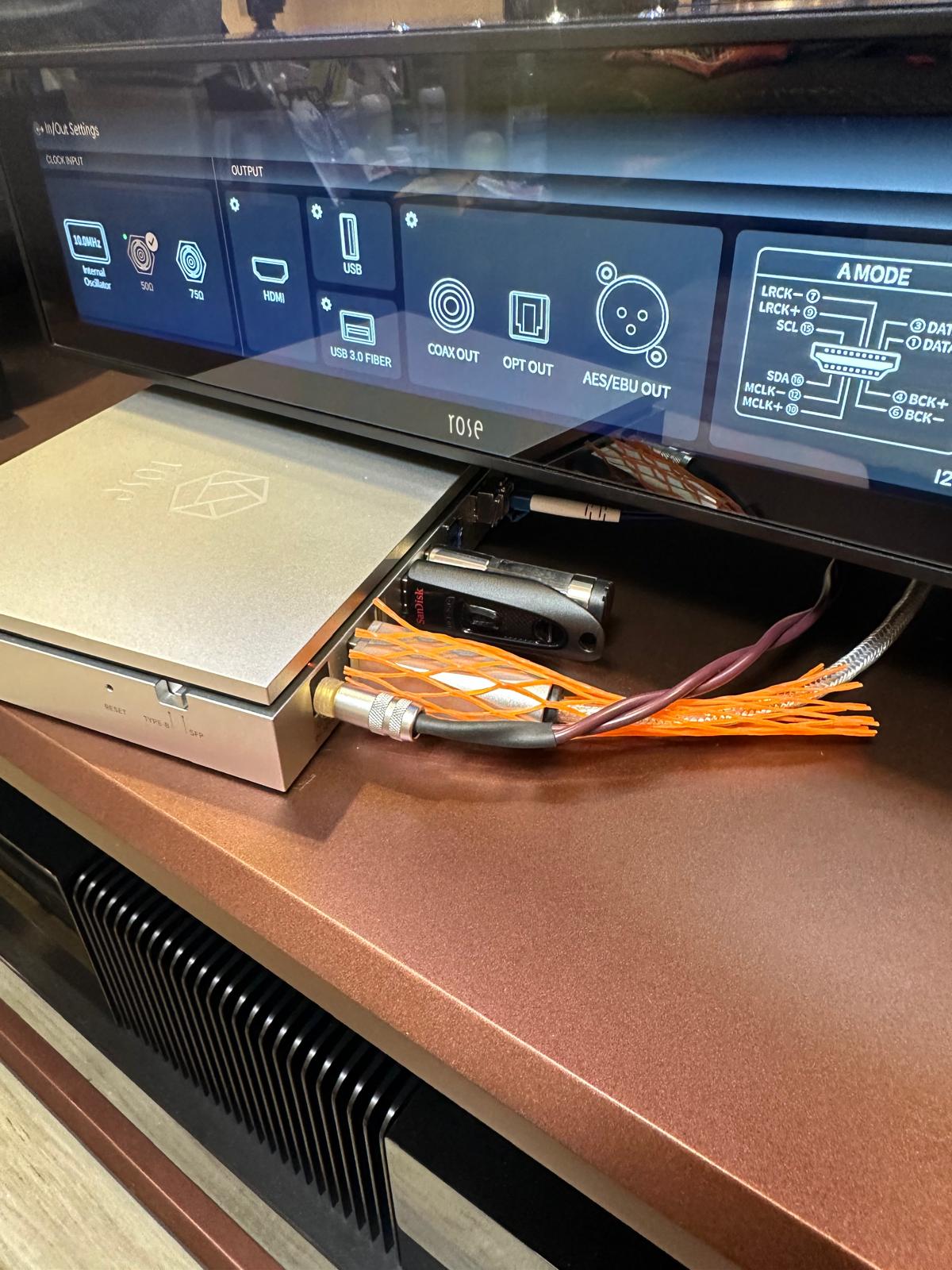

Thank you for responding to my issue regarding connecting my RS130 to my Gryphon Diablo 300 DAC via RSA 720. The problem was after connecting my RS130 to RSA 720 using fiber optics, then I connect my DAC’s usb cable to a usb 2.0 port on RSA 720. Then I try to configer my DAC within the RS130’s output setting. After numerous attempts, the RS130’s output setting still showing no DAC was connected. I also have a power connector problem with my RSA 720, the power connector on my RSA 720 won’t stay power up, so at last I went to the dealer in Hong Kong and exchange for a new unit. I also updated the firmware on the new RSA 720, then I try connecting the RS130 and my DAC via RSA 720 again. This time the RS 130’s USB port output setting has recognized my DAC.
The following pictures shows the connection I made with my RS130, Gryphon Diablo 300 DAC, and RSA 720.
