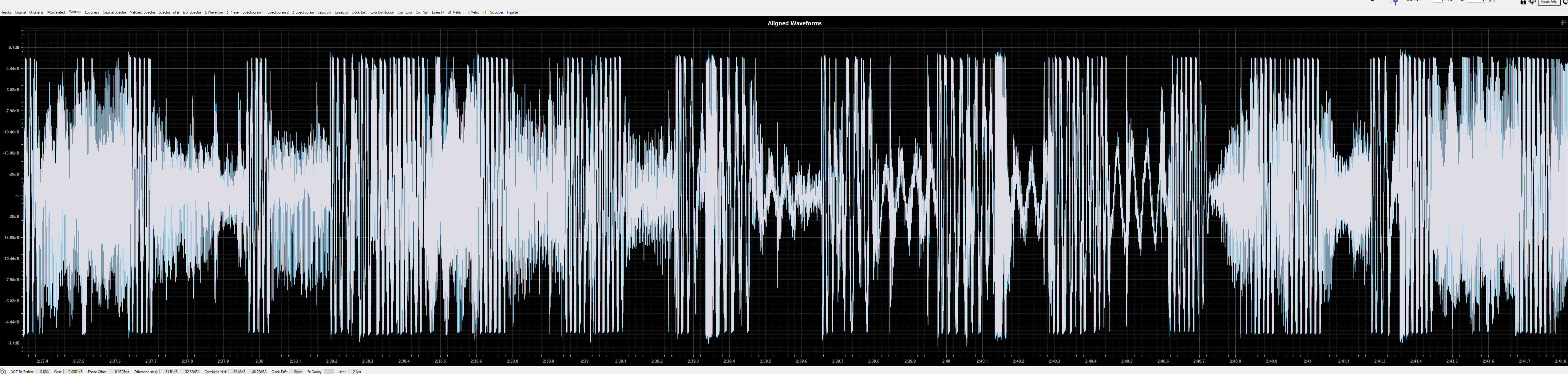

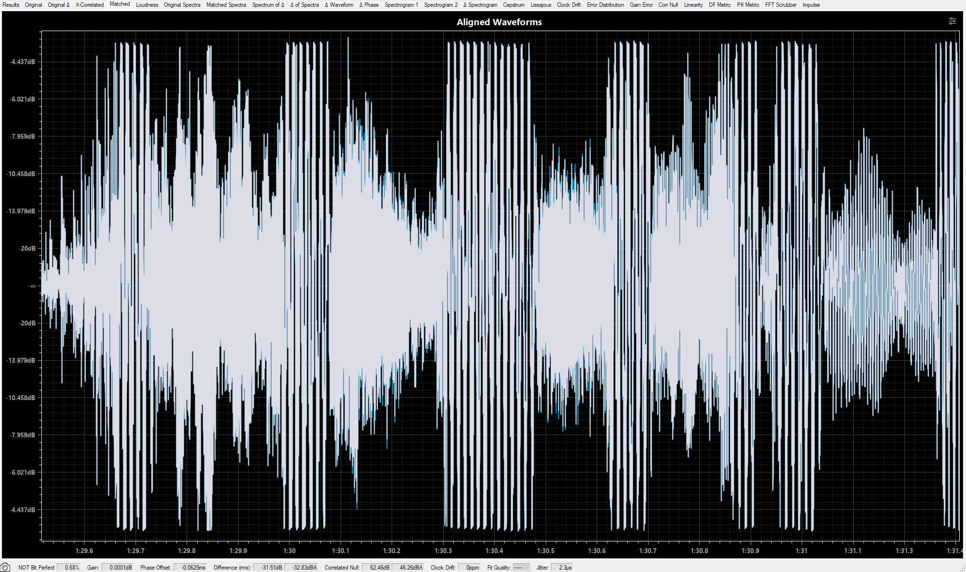

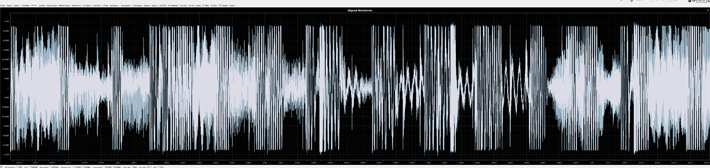

I think so, yes. I download DeltaWave. Then recorded a track in both scenarios, and they lined up almost perfectly. There were some very slight differences but I was very limited in my recording capabilities, so I am assuming that the differences were because of that. If you have a proper high quality audio interface, I’d suggest trying it out yourself. What is curious is that DeltaWave said the following after correcting for gain and time aligned:
Files are NOT a bit-perfect match (match=0.45%) at 16 bits
Files are NOT a bit-perfect match (match=0%) at 24 bits
Files match @ 49.9969% when reduced to 6.43 bits
I don’t know the software well enough, but that does not seem like a very good match. I have a feeling that it is because of my recording technique though, as once I was testing level-matched, they did sound the same to me.

Here, you see the Rose (Blue) is not matching up with the white (Roon). Is that more dynamic range, or is that error in my recording process, I don’t know. It is “different”, contrary to what Boris, Vik and Hifi Rose say. Without having confidence in my ability to record this properly, I simply don’t have an answer.
Thanks for taking the time to do your testing Gingerbeard. I am certainly no expert in the technical aspects of audio but it would seem that the extra blue on your graph would represent more dynamic range for the hifi rose?Also the Fletcher-Munson curves apparently have demonstrated that the human ear is more sensitive to more mid-frequency range. I am really perplexed but interested in what is causing what I perceive to be a large difference in the much more lifelike sound when I separate Roon from the equation.Do I want Roons wonderfully engaging user interface or better SQ ? I would love to have both but I wonder if it’s something I am missing in my setup? Thanks to all and a special shout out to Ginerbeard for going the extra mile!,

Looking at the difference between the blue(Rose) and the white (Roon),there are some tracings that are over 7db greater for the Rose.Thats very audible and would make a huge difference in dynamic range.And there’s a lot more of the “blue” meaning more music.I think that possibly Gingerbeard has confirmed with measurements what my “golden ears”are hearing which other people have noticed as well.As I go back and forth,I hear more dynamic range,fuller more articulate bass,bigger sound stage,and a more being there listening experience.I have a highly resolving system and a well treated listening room.It would be great if other people like Gingerbeard with the equipment and know how to check this out.Hoping you find something great to listen to today.Here’s something that I found recently that I think most might enjoy: Sohn….The Wheel on Quobuz,and Max NcNoun….Marley also on Quobuz.
Haha thats too funny! The song you are looking at in the graph is Sohn - The Wheel.
